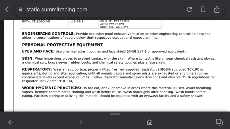

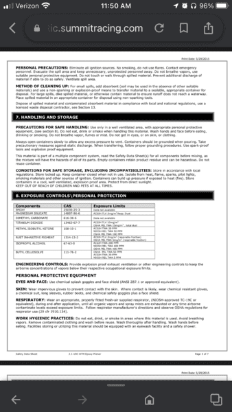

The isocyanate is actually in the hardner not the base/ primer / epoxy ect.
Edited-
Are you sure about the 6000 number? I believe it to be the 3M series of face masks and not filtration type. This is from a description from a 3M filter.
- Fits 3M 6000 Series and 3M 7500 Series half face piece respirators
Do you know if Isocyanate can be filterd or partially by organic filtration?
