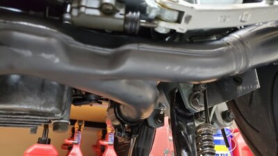

Pictures below show a 96 Corvette LT1 exhaust manifolds which were cleaned by glass beading and sprayed with DGF before installing 10 years ago. The second set of pictures is of a 1990 Kawasaki ZX-11 re-installed stock exhaust system after removing them to hand sand the rust off followed by one coat of DGF.

As snakeoil24 said earlier near the top of the thread, all the other currently available coatings or dressings will only last if you don't start and run the engine. DGF spray is the only one I have found that gives you the finish you want, stands up to the heat and actually lasts and lasts.

That looks very good how expensive is it?
These guys have been coating for decades. They do all my stuff, and their header/exhaust coatings have been flawless. They also stand behind their work. Great guys, and racers.....
