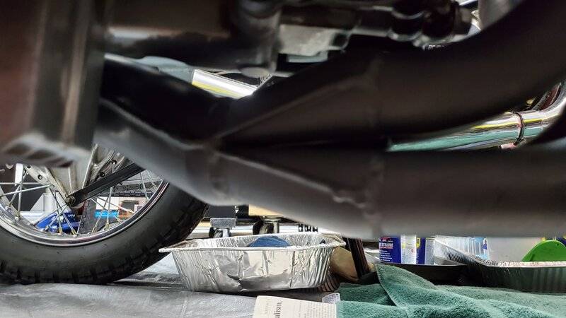

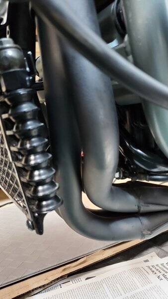

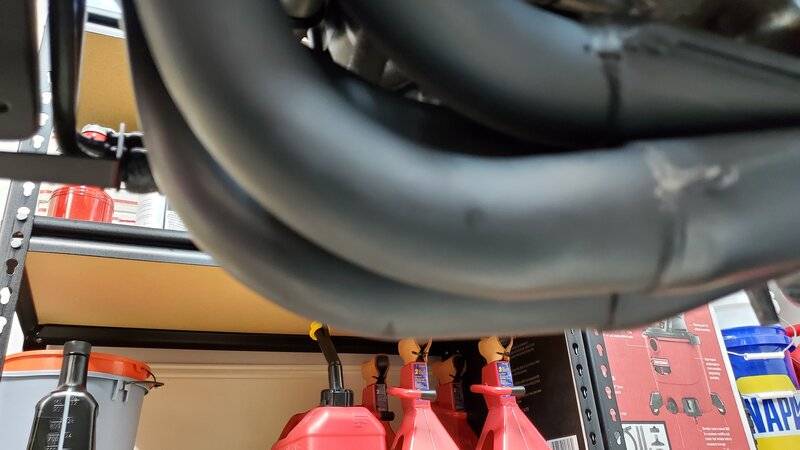

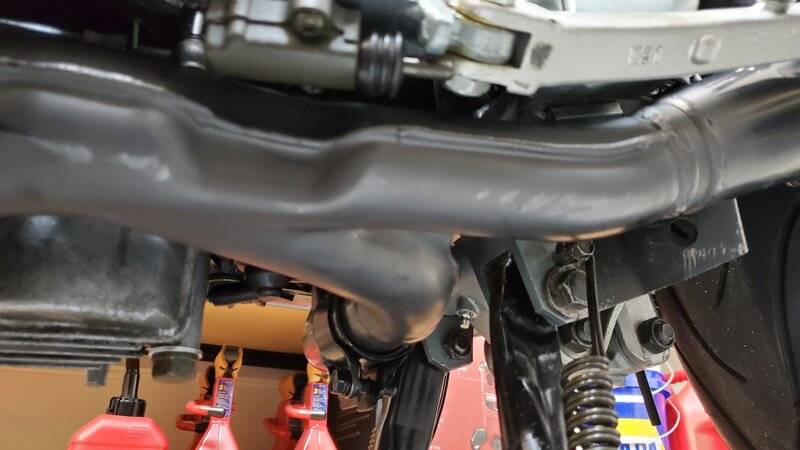

Pictures below show a 96 Corvette LT1 exhaust manifolds which were cleaned by glass beading and sprayed with DGF before installing 10 years ago. The second set of pictures is of a 1990 Kawasaki ZX-11 re-installed stock exhaust system after removing them to hand sand the rust off followed by one coat of DGF.

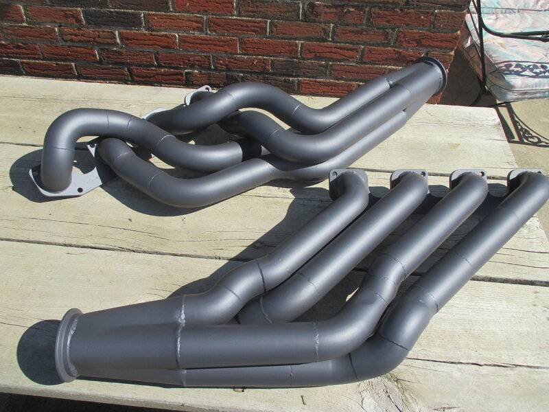

I tried using a POR-15 brush-on exhaust paint - heat resistant....but the rust started up after about 2 years....so when I upgraded my engine a few years later, I tried Pro-Coat.
The Pro-Coat company here media blasts the headers (or any parts) and basically sprays on a powder coat type product, then bakes the parts. Still happy and no blemishes after many miles, and they clean up easily.

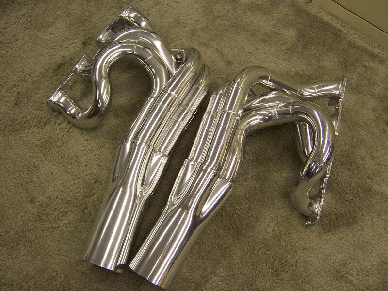

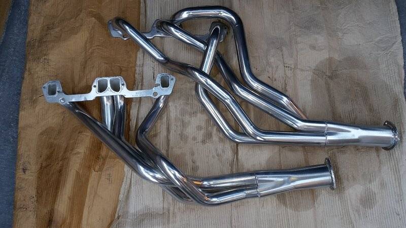

That looks very good how expensive is it?
These guys have been coating for decades. They do all my stuff, and their header/exhaust coatings have been flawless. They also stand behind their work. Great guys, and racers.....
https://www.qccoatings.com/
