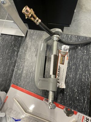

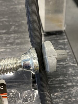

He told me to test the system by applying clamps to all 3 hoses. With all three hoses clamped down to severely restrict fluid flow to them, see if the pedal has less travel with vacuum applied to the booster. Then remove one clamp at a time starting at the rear to determine what part of the system has a problem.
He suggested using vice grips for clamping of the hoses. I tested a vice grip on a test hose I did not install on the car. The teeth on the jaws of the vice grip cut into the hose damaging it..
I tried a large C-clamp at an auto parts store. This clamped the hose without cutting it or visibly damaging it. They only have one clamp in stock, so I had to order two more from their warehouse. Will get the other two tomorrow and perform the test..

I wouldn't clamp the rubber lines to me thats a bad idea it gets you no closer to working brakes and potentially damages the hoses.

I was/am worried about damaging the hoses by clamping them..

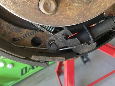

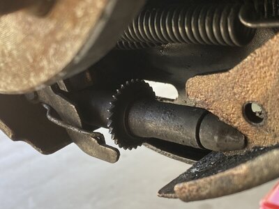

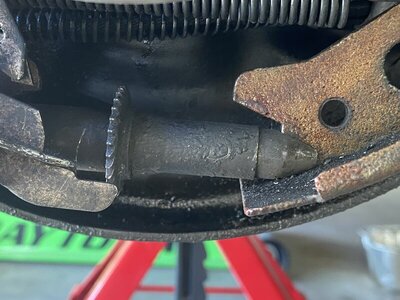

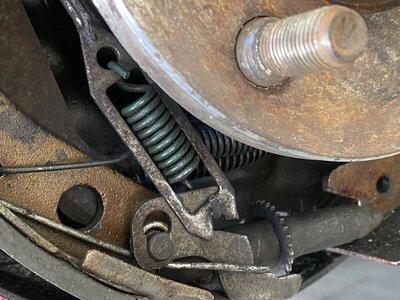

Today, I’ve removed the passenger drum and when doing so found that it is still very loose fitting. Apparently the one lap drive around the block, on Friday, didn’t do any self adjusting.
There is a metal bar, that is supposed to engage with the star wheel teeth, preventing it from rotating in one direction. As the assembly is now, there is quite a big gap between this bar and the teeth, allowing me to turn the star wheel in either direction.
Is it suppose to be like that when there is no tension between the shoes and the drum? Then as I tighten, the bar will move towards and engage the teeth?
3E0BA437-A969-4134-97F4-DF1892681CDC.jpeg FD5F52AB-629A-43AB-AA34-CB6350FBD1F9.jpeg F7F47966-AC21-4B29-A2E7-726DB7D4E1A6.jpeg 8386AE7C-9C37-4ABF-93D2-226C02ECDF9A.jpeg 562BD7B2-324B-4E60-8E93-FF0BE0C20AB1.jpeg 48E05951-BF0E-4262-991A-DC92D0DB6B43.jpeg

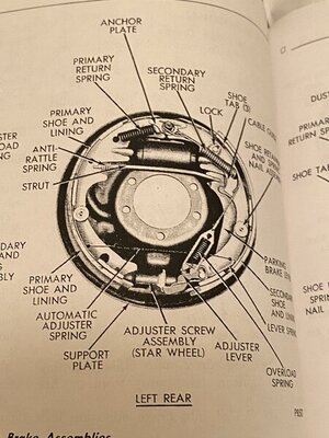

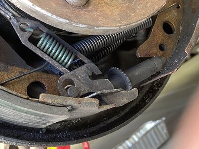

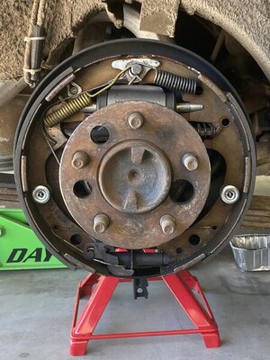

Okay. I broke out the service manual and looked at the 10” drum assembly drawing. I had the spring connected incorrectly to the metal arm that engages the star wheel teeth. The tension on the shoes was as loose as could possibly be too. So I do think this is the source of my pedal going to the floor problem. The other side was in the same state.
Service manual says to back off parking brake adjustment so that there is slack in the cable, which I currently have..
Then to adjust star wheel pushing up with the brake spoon from the inside of hub until a slight drag is felt when wheel is rotated.
Next push the metal adjusting lever arm out with a screwdriver, then back off the star wheel just enough so that there is no drag.
Lastly, adjust parking brake after brake shoes have been adjusted. There is another section in the manual for that.
The instructions to push the adjuster arm away from the star wheel with a screwdriver to loosen the tension, makes me think the adjuster arm should always be engaging the teeth. It is not engaging the teeth on my car..
Could someone clarify when the adjuster arm should engage the teeth? All the time, only when the shoes are contacting the drum, or when?
06B85DE9-102D-4B08-ACA7-ACE1D2AAE6B9.jpeg AD277ECA-10D2-4C1C-A137-E25C33C7E6F2.jpeg 0EA23386-2026-4C80-B001-EBAE5E45B88E.jpeg 529D8F0B-6AC5-4899-B1BD-1E0E074F34EA.jpeg
After actually removing the driver side drum, I can now see that the adjuster arm is ALWAYS in engaged with the teeth on that side of the car. I’ll need to replace the adjuster arm spring on the passenger side, as I guess it is no good..
Further investigation shows the post on the brake shoe, that the adjuster arm and spring attach to are not the same length on each side.. The post on the passenger side is 14mm tall. The driver side post is 12mm tall. Sounds like horrid quality control by whoever manufactured the shoe on the passenger side. The post is too damn long! This allows the adjuster arm to flop sideways on the post, and therefore to not engage the arm properly with the teeth. A chunk of the flared head is missing from the post due to the unwanted movement.
I went back to the car before posting this message. I adjusted both sides until there was some noticeable drag on both rear wheels. Probably adjusted too tight, but wanted to see if this made any improvement on the pedal travel with engine off.
