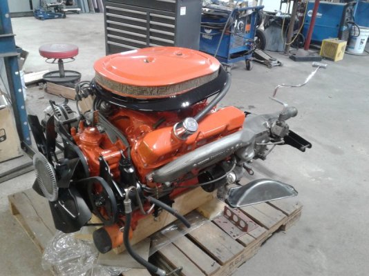

The car is a numbers matching car with full documentation going through a nut and bolt restoration. In my world it would seem a shame not to put the car back the way it was originally if you have all the original parts and supporting document. I don't think it's a particularly rare optioned car, but it is kind of neat. It's a 383 4 sp, buckets, console, ralleye dash and N96. It has the A36 axle package that gives it the Hemi/440 suspension (sway bar, half leafs on the left side) 26" rad, 7 blade clutch fan.
The objective is to have it appear just as it did as it rolled off the assembly line. The next owner can modify it like we did back in the day when we got them home.
