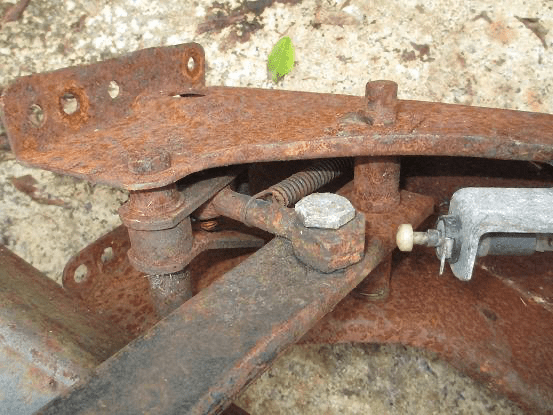

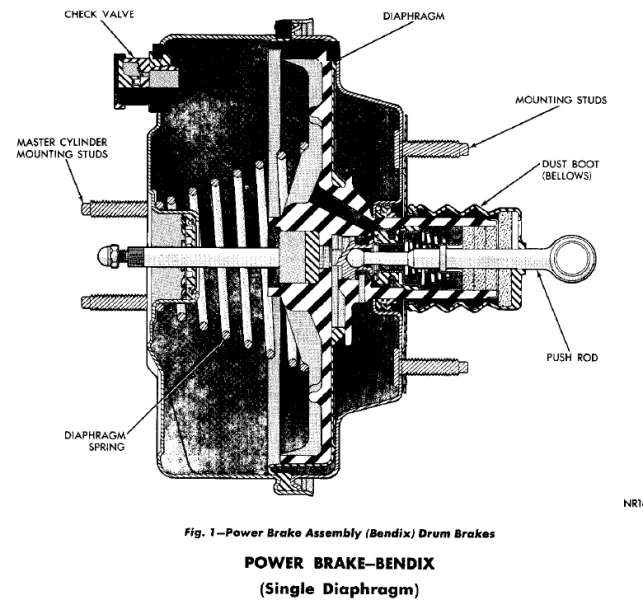

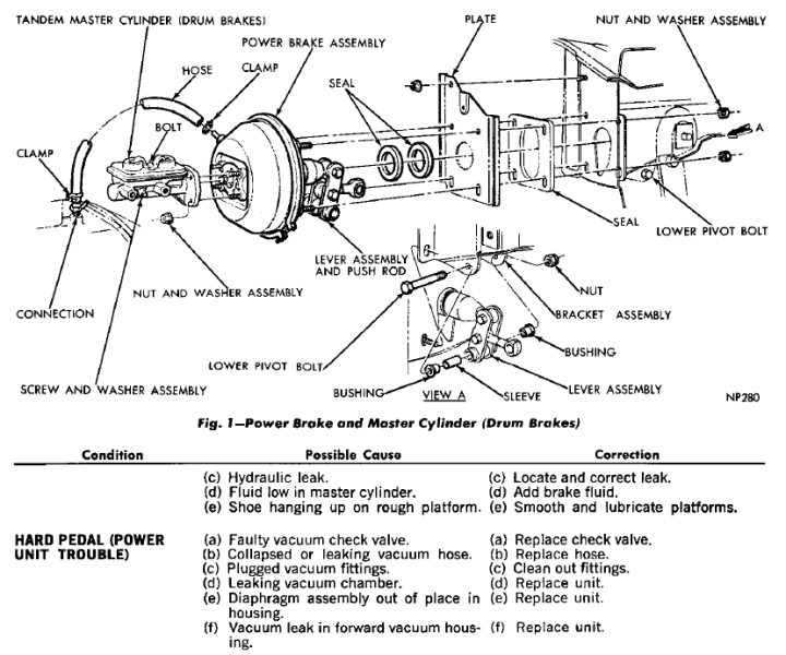

I just finished a complete rebuild on my Charger brake system - granted a 72 - but there are no springs in the peddle assemble that I'm aware of. Peddle return is primarily based on springs in the power assembly and master.
If your brakes are not fully releasing and you have to pull up on the brake pedal or wait slightly, your pushrod length is to long. There is no under dash spring.
Well.... Actually there is a spring... But it doesn't effect pedal free, it's supposed to prevent a rattle... I'e had cars with it & without it... Haven't noticed any difference in pedal feel or rattling...

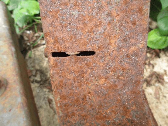

Maybe he over tightened the linkage fasteners.
If the right parts are being used that can't happen, the bell crank assembly has a sleeve inside that is longer than the bell crank and the actual pedal pivot is free floating on one end, the clamping is only of the sheet metal of the bracket, not across the bracket..
The reason some cars don't have that spring is because it's a royal PITA to install from under the dash.
Out of all of my mopars over the years I’ve only had one with that anti rattle spring.
Yes an anti rattle spring. It pulls straight up on the rod. That won't help it return.
Most likely for avoiding warranty rattle problems.

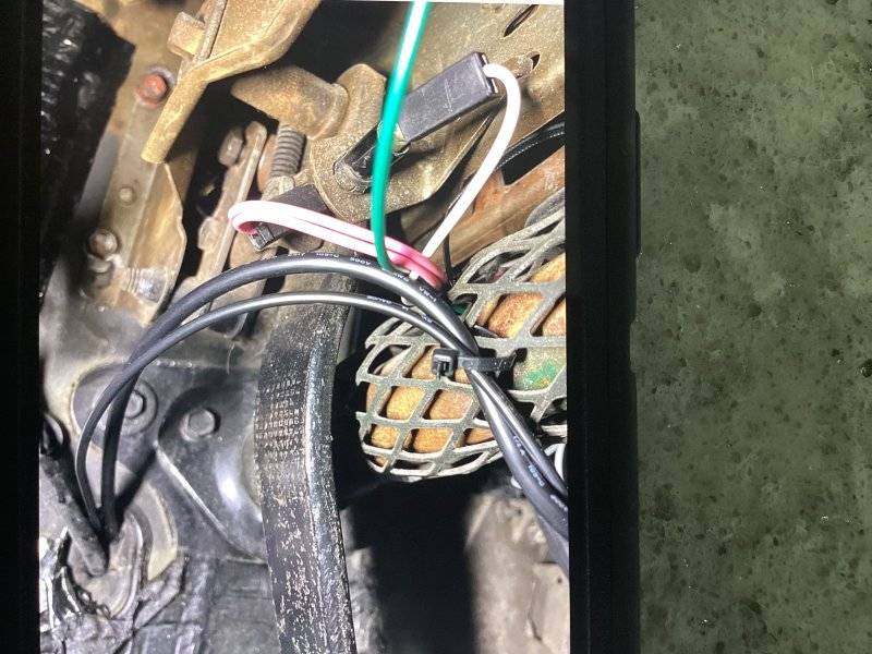

My 68 Charger has a spring
so it is an anti rattle spring... good to know! well once I put it away for winter storage I will go about adjusting that push rod length! thank you so much for your help!
