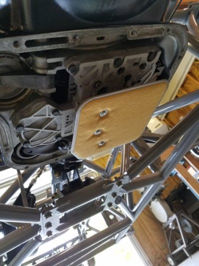

Hello all, I'm looking to add a trans temp gauge, and was hoping to install the temp sender to the 727 case somewhere.
I may have found a port that will work, but would like some opinions on this port location.
Pic of my 727.
I found a pic showing a truck 727 trans with, what looks like a temp sender in this port location.
What do you guys think?
Thanks ahead of time for your help.
Thats the reverse servo test port. While you will get a reading I do not think it will be a true fluid temperature reading.

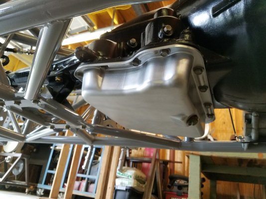

I did purchase a Moroso pan with the temp port built-in, but the dang port is in the front of the pan.
What the h..ll were they thinking, every bit of road garbage could hit the sender. Common sense
would dictate that locating the temp port to the back of the pan would protect the sender better,
and when accelerating or going up an incline, the fluid would be forced to the back of the pan
where the sender is.
Like he said you can put it in there, there is a picture of it. But it doesn't have any fluid moving through there unless it's in reverse or Drive first gear. Going down the freeway or fluid will flow through there, so not accurate.

Looks like it is. Does not mean its right. And if it was right every manufacturer of a transmission temperature gauge would tell you that's the spot to install it. Which they don't. Run it in the pan and I doubt you will ever hurt it. Or buy line fittings and put it in the cooler line.

I'm easily convinced, front of the Moroso pan it will go then.

I didn't want to mess with my numbers matching pan, so I had no other choice but to buy another one.
I went with an aluminum 2 extra qts. moroso pan. It's a nice looking pan, but I don't like the ports in the
front. Yeah, I could probably drill and tig weld one in the back but I don't have a tig welder, and one
shouldn't have to, at the price I paid. I guess I'll just have to live with it, and dodge road kill & speed bumps.

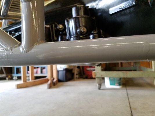

Did the same on my build. I'm 1" below
Not worried about it.

Uphill/downhill/acceleration....
The pan has fluid in it at all times..
The pump insures this. I wouldn't
be worried about this much.
When was the last time you've seen
a cratered trans pan?
Thousands of off road vehicles run
these tests every single day.
There's other items under there that
will clear the path of obstruction.
Regular street use will pose no
problem.

My street car has had the sensor in the line for over 20 years, works fine. My racecar has one in the pan. We usually weld an arbritary location in the pan thinking about wire routing vs exhaust. The only spot that I've used that was wrong? Locating the bung to close to a pan bolt. This caused socket interference to the sensor during pan installation. I personally don't worry if it's at the front, side, or rear of the pan. We've even drilled and tapped the drain plug. Works fine as well. A thought about the sensor located in the return line. The fluid is the hottest as it returns out of the forward cooler line. As the converter fluid directly exits there. Actual operating temperature in the pan is a closer number. As I've mentioned before there is no need to run an expnsive pan unless you want the look of the heavy cast aluminum pan. These pans with the addition of a temp bung are powder coated, thick material, and deep. Perfect at $26.99
