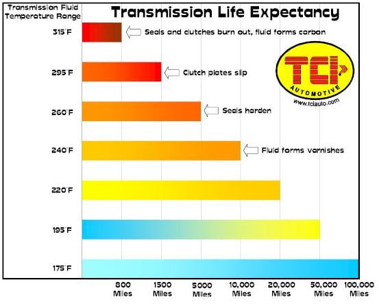

You have a very hot transmission. Front line is the converter flash and the rear return is what has been cooled.

Sensor in the front line is what they call the hot line. With it there you are measuring the temperature that it is producing. Rear you are measuring the cooled return temperature going back to the transmission. In the pan is giving you the temperature of the fluid waiting to be used. If your return that has been cooled is in fact 250 plus you are cooking that transmission and it is not going to last very long. With it being pegged you have no idea as to how hot it really is.
