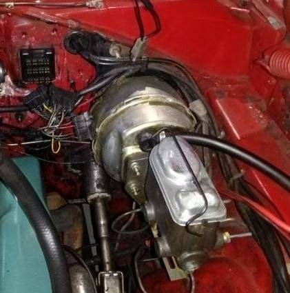

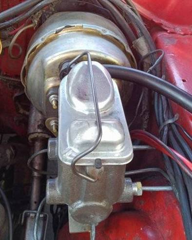

For 68 Charger with current power front disc and rear drums, looking for recommendations on a master cylinder & booster with correct pedal linkage….currently has this setup, which leaks from the output ports no matter what i try… IMG_7020.jpegIMG_7019.jpegIMG_7018.jpeg

IMO.....the pix shows the master cylinder something like a retro fitted GM design and the booster unit RESEMBLES, but not is a Bendix tandem booster unit. Likely your vehicle would have had a single diaphragm Bendix booster, if originally equipped with drum brakes, and depending on wheel cylinder bore size, a Bendix or Kelsey Hayes master cylinder. Usually the master cylinder was dependent on overall system requirements. Aftermarket retrofitted systems are difficult to state exact size/ brand equipment based on pix information only. Do you know who provided the equipment you now have or its manufacturer........just my thoughts......

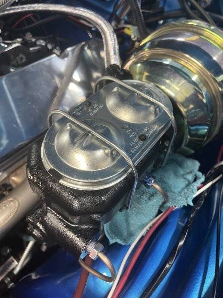

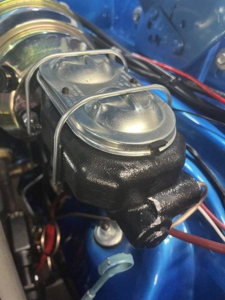

I have installed 2 of these on a Road Runner and a GTX they work great and look the part. Those like you have have been nothing but problematic. I have 3 of those style boosters taking up space in my garage.

I was informed a”universal” GM style from Pirate Jacks

I have one recommendation from a supplier who suggests 1 1/32 bore?

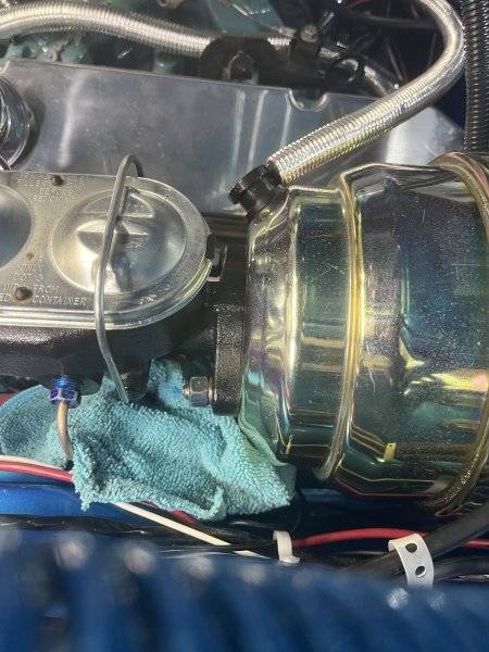

The first one I posted is what I installed on 2 different cars and they work wonderfully. And it bolted right up to the stock pedal. Didn't have to modify anything. I'm not sure but it is the largest bore size. 1.125 which is 1-1/8th
How is the bore size determined?
I used that Pirate Jack Generic Motors MP-203 garbage on my Niece's Challenger when I built it for her. It would not provide enough boost for disc brakes no matter how hard you pushed on the pedal. They wouldn't take it back so it went to a local scrap dealer. You will never be happy with the performance of that booster. Believe Me!
I had to replace it with the Bendix dual 8" unit shown in post #3. It made all the difference in the world so that is what I put on my Charger also since that is the design that Ma Mopar used on these cars. The only issue I had was the rubber boot on the booster is larger in diameter than the factory unit but a couple seconds with a dremel or file takes care of that problem.

I can't say all the Pirate Jack stuff is junk. Maybe it is ok for a Camaro or some small shivvy but they are no good for a B or E body Mopar.
Cass at Dr. Diff won't steer you wrong and I have no input in the others. I just know that the Bendix style dual 8" diaphragm units I have installed work as they should. The other thing I learned about front disc brakes is that they need two times the boost as drums do and mix matching brake parts are not a good idea.
