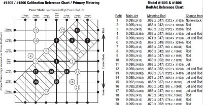

Hi Ed, it's a 383 but with the 650 carb the fueling requirements will be very similar for any mild big block. In your owners manual for the AVS there will be a metering chart. Try to stay in the upper right region of the chart (richer cruise/power modes) to start and then fine tune from there. Tune the secondary jet according to how the car feels at WOT as it only comes into play when the AVS door opens. Lewtot184's suggestion to go to a 7" spring is right, if you have a lot of vacuum with a stock cam then you may want to try the 7".
Fine tuning will involve changing rods to get the best cruise performance once you get a good base setting for WOT. First 2 digits of the rods...higher is leaner cruise. Last 2 digits of the the rod number...lower is richer power mode.

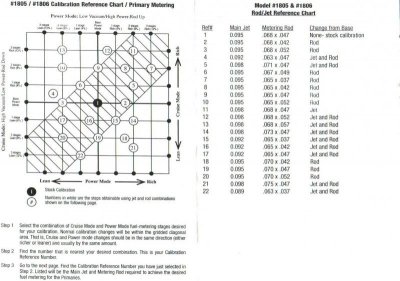

The chart I have for the 1805 is much like yours:
As the car seemed to be sort of in the neighborhood on the secondaries (I'll be easing off a half turn on the air door, though, to get rid of a little bit of that "Quadrajet bog" it's exhibiting now), I'm thinking I'll shoot for #8 on the chart to begin with.
I think that means rod change only in my case?

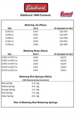

I'm fetching the Edelbrock #1840 calibration kit for my 1805.
It has this assortment:
