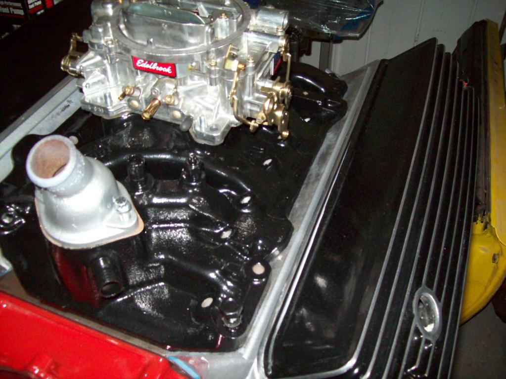

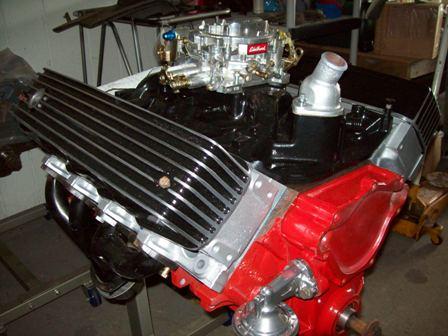

Its a 63 block bored .030 with 9:1 Egge flat tops stock rods and crank, heads are stock port with Gary P's blue printed rocker assembly, isky rods and 264/450 cam, powder coated stock 4bbl intake and 500cfm edelbrock carb, Holley fuel pump. tti headers will be added and will be running 2500 stall on 727 with shift kit and maybe 3.23 posi gear. Have 4:10 now but will be in my coronet rag top so I might want more cruzin gear. Thanks for asking.
Hi , My name is Pat ... I am doing a Poly motor for my son , He's in the Marines and overseas right , I want to get the car done before he come home / I have 2 1/2 years to do it . WHERE DID YOU EVER FIND THE VALVE COVERS ... I would love to have a set of those for him . I am doing a 66 Belvedere wagon , I need a right tail light ... got one for $100. but the guy that sold it to me didn't tell me it was not for a wagon . You are doing a great job on you project / hope mine will turn out as nice . If you wish to contact me ... psroadster@aol.com
