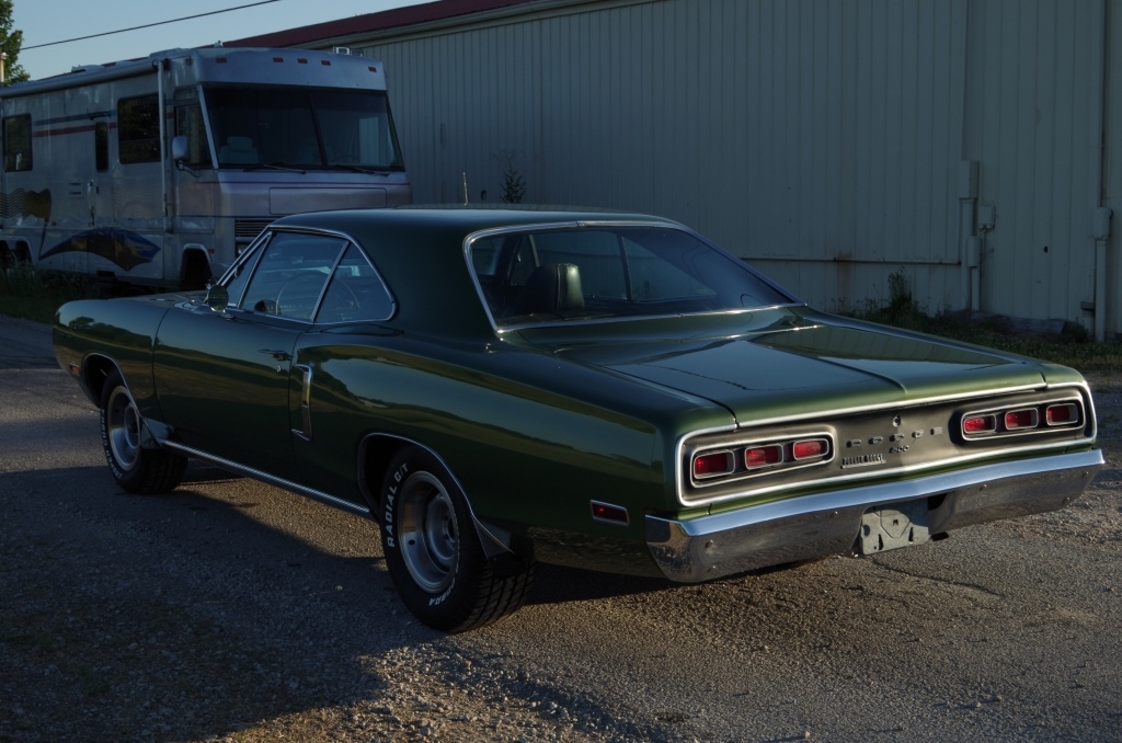

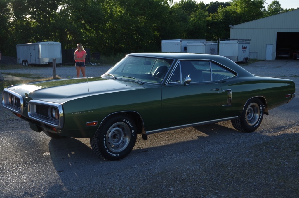

This coronet recently resurfaced in Illinois area, fully documented With 49.000 miles on it, it needs a few Things but was recently driven 1200 miles in just a few days. Promising car. Original wire spoke rims on 14" rims intact, ordered car.
About this Mopar:
1970 Dodge Coronet 500 383 4BBL 727 3,23 (Non SG) 2 dr hardtop. AC, PS, Manual brakes, notice dealers emblem. All Stock 49.000 miles. AC Doesn't work but all parts seem to be there. 1983 title from Kentucky. Build Sheet confirms the car is ordered ; everything you can see including no vinyl top, is original apart from the second set of Rallye Wheels, the 14" road wheels were ordered with the wire spoke hubcaps and I have kept them of course.
I found this car on youtube at first, check video..... Original whitewall spare in the rear is still there never used and rubber is soft and not rotted ! The whitewalls in the video however were not roadworthy at all so they are gone, but I have the wheels and rims and will buy new whitewalls for whenever lots of highway cruising/show is on order. I wonder if the splash guards are dealer installed, looks like it to me.
When I bought the car I was offered a touchup job for a reasonable price, but when they started fixing dings and repairing the lower rear quarter panels, they found out they had to paint the whole car - just as well ! :D So its factory correct F8 Paint (Dupont? base coat clear coat). Solid car, and quite a bit better than I expected. They guys selling me the car are from Bethalto Illinois, Dyno Tech Automotive and they did their best to make the car able for a 1200 mile trip home (They had 4 days to do this!! ), and without having really road tested it (no plates, we brought them), The Dyno Tech guys, Jamie and Tyler Hutchins and the rest of their team worked hard. I am just full of praise.
A few notes on the 1200 mile trip back to New England: At first we had to return to Dyno Tech after two miles because there was no juice from the lighter, needed to operate a GPS we had along. Returning, it only took a few minutes to fix. Once on the highway the engine temp was perfect. Then, after half an hour @ 75mph it rose almost to the middle, steadily so and I was thinking we had an issue but it stayed there as we pulled off to fill more gas. Getting underway, the temp again crept up and up but then suddenly it dropped rapidly down to perfect, and its been there ever since. I could find no clue in the coolant, it looks clean and still is. We made the mistake of opening the fresh air vents under the dash... resulting in a whirl of old mice nests, maple seeds and other dubious remnents blasting our faces and filling the car with debris. The car didnt care. :)
The battery tray area will need to be fixed, some surface rust as you see apparant in the engine room. That and get rid of issue with transmission, it leaks when it sits still, supposedly shift shaft seal and/or just the transmission pan gasket. Exhaust leak at collector drivers side header. To be expected when it has hardly been used since god knows when, like 1999. Then just install a pertronix and have her tuned, she gets about 12,5 miles a gallon right now. I bet she can do just a little better. Just small Things and all else Works great. Missing center caps I know... I am a super happy guy, Love the car, the Green Mean Machine :D. She'll cruise on the highway at any speed you want..just about :D

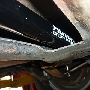

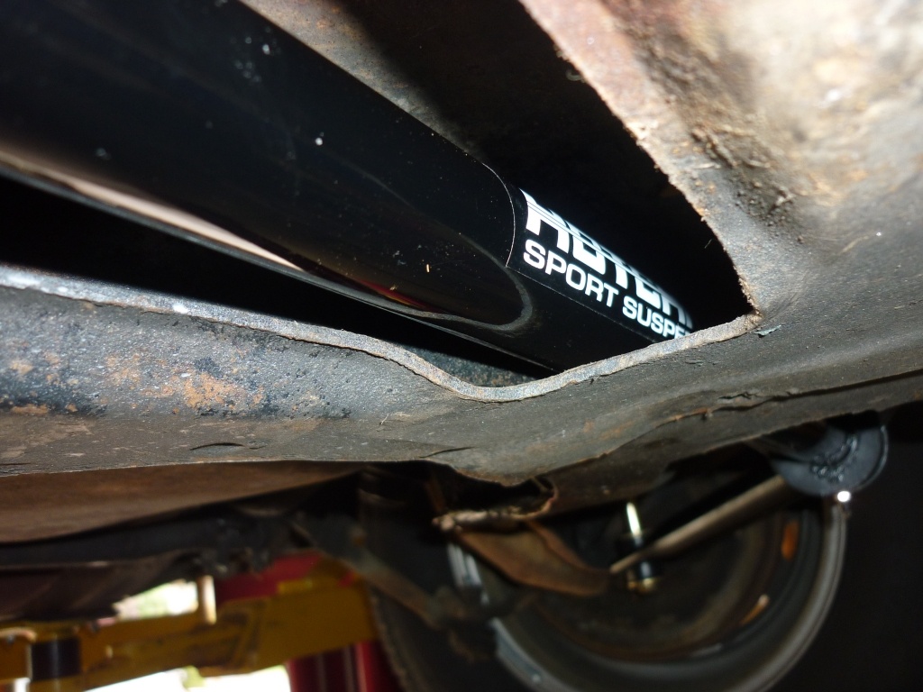

Update 10.14.2016: Added two pics showing improved stance (early pictures hide the sag a little..lol )

Hotchkiss front sway bar now installed, road ready now for spring with curves !
