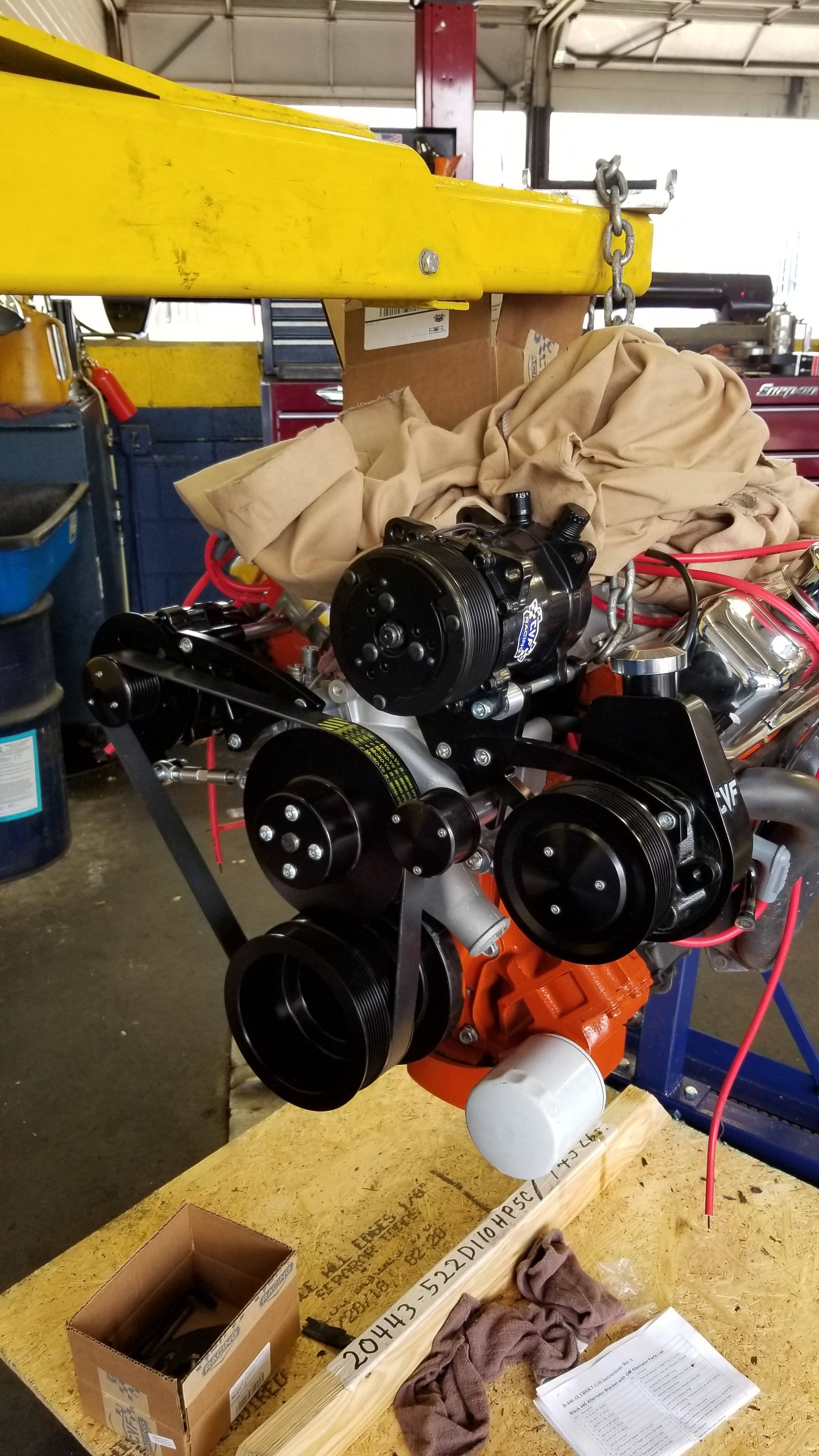

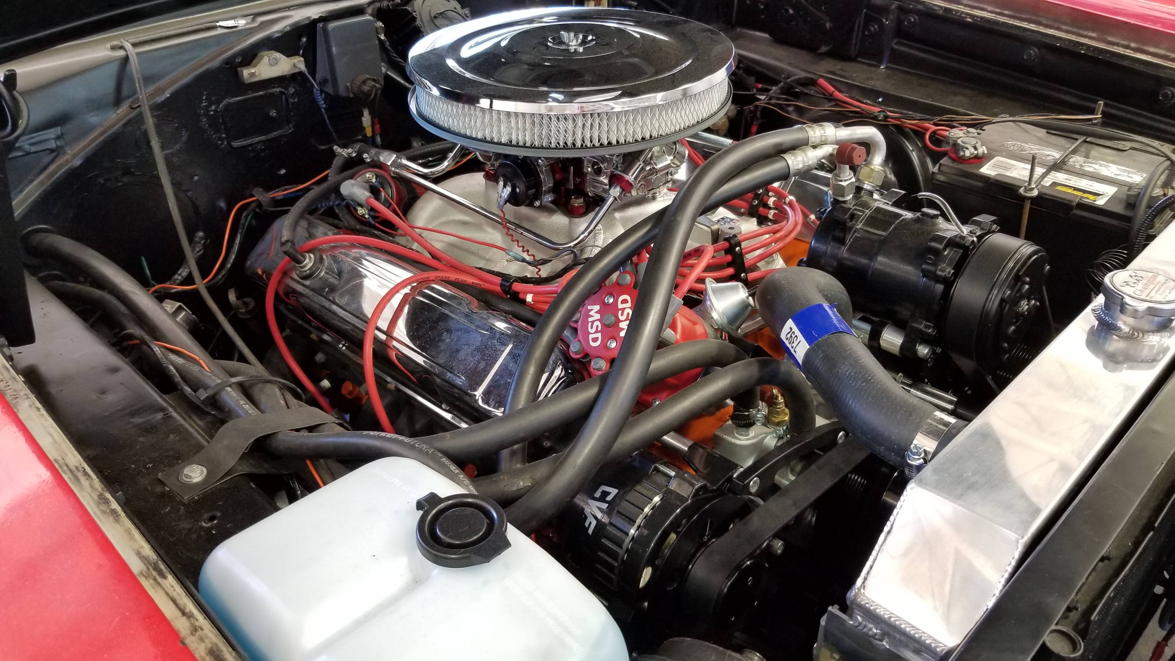

CME (Carolina Machine Engines) Built engine - 522ci (468 hp / 600lb torque)
CVF Racing Serpentine Belt System

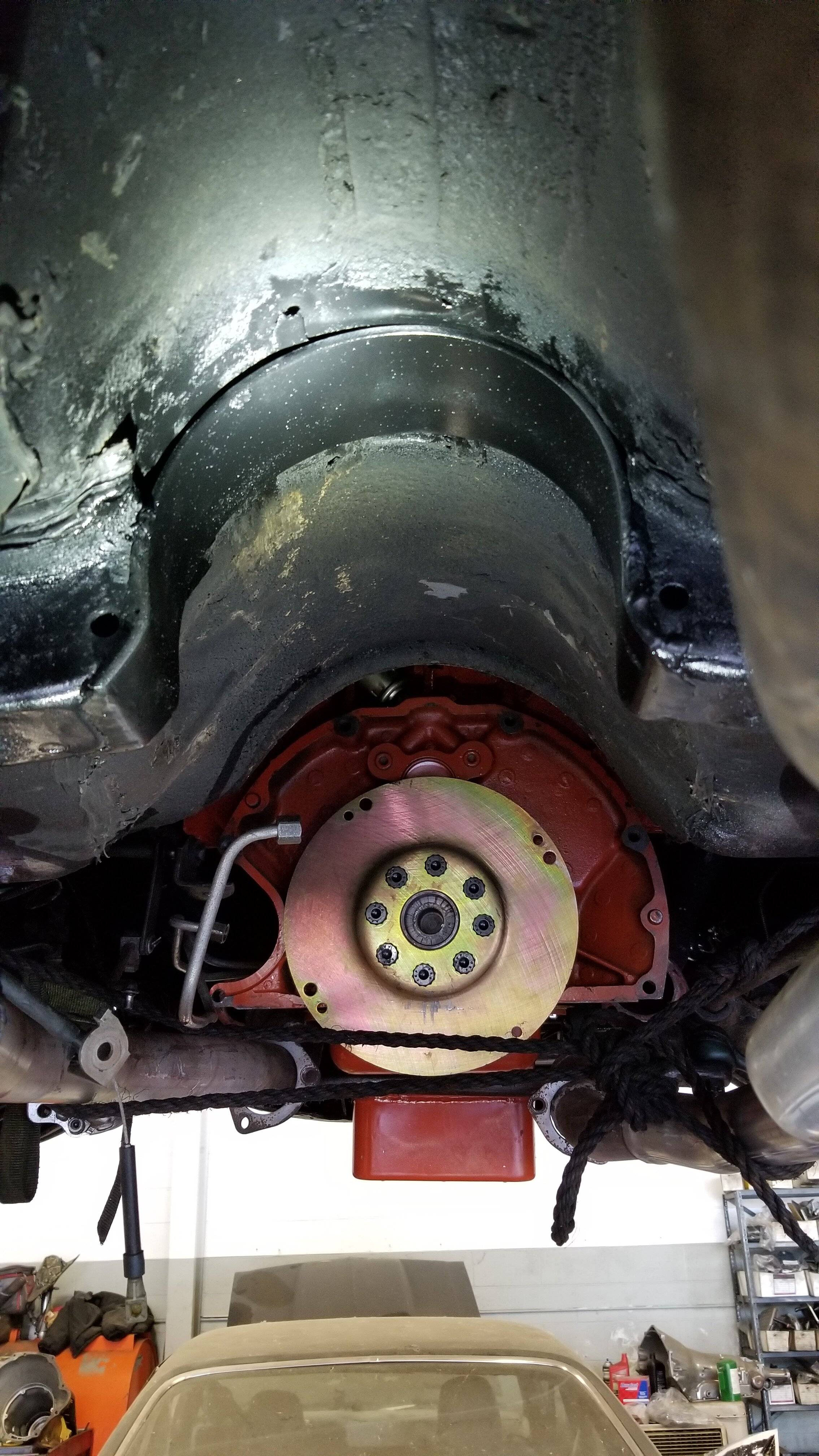

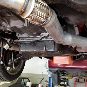

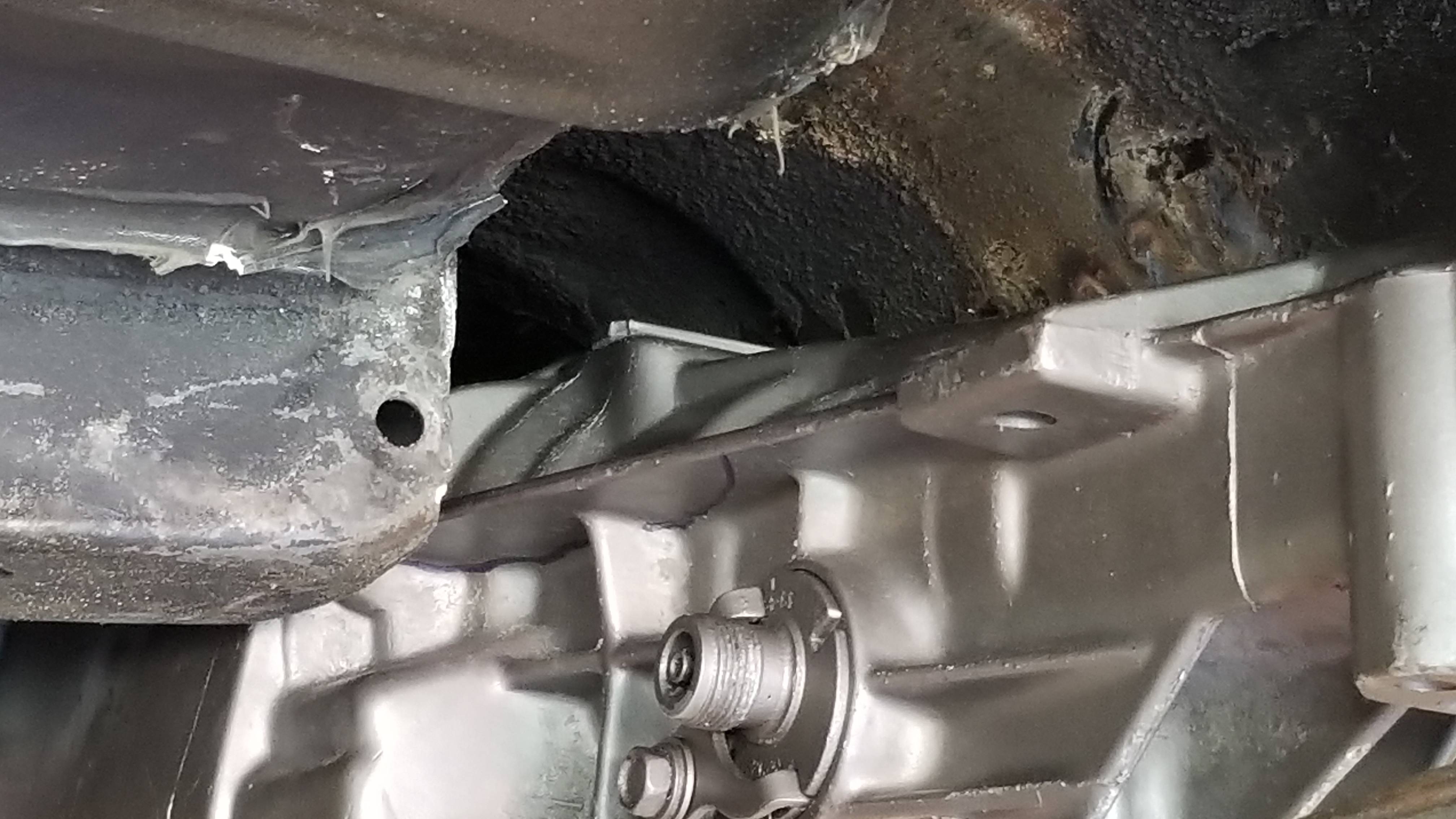

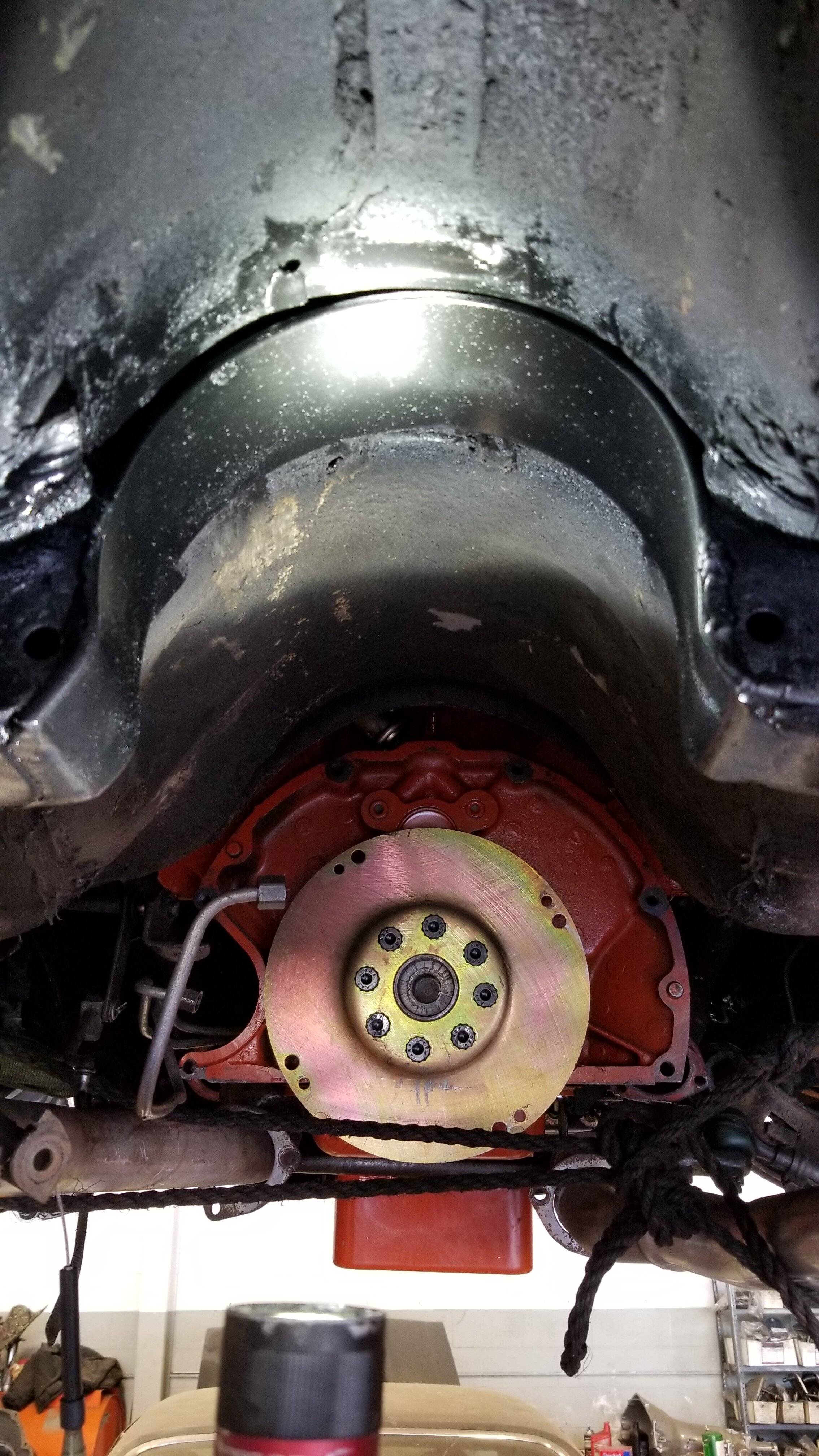

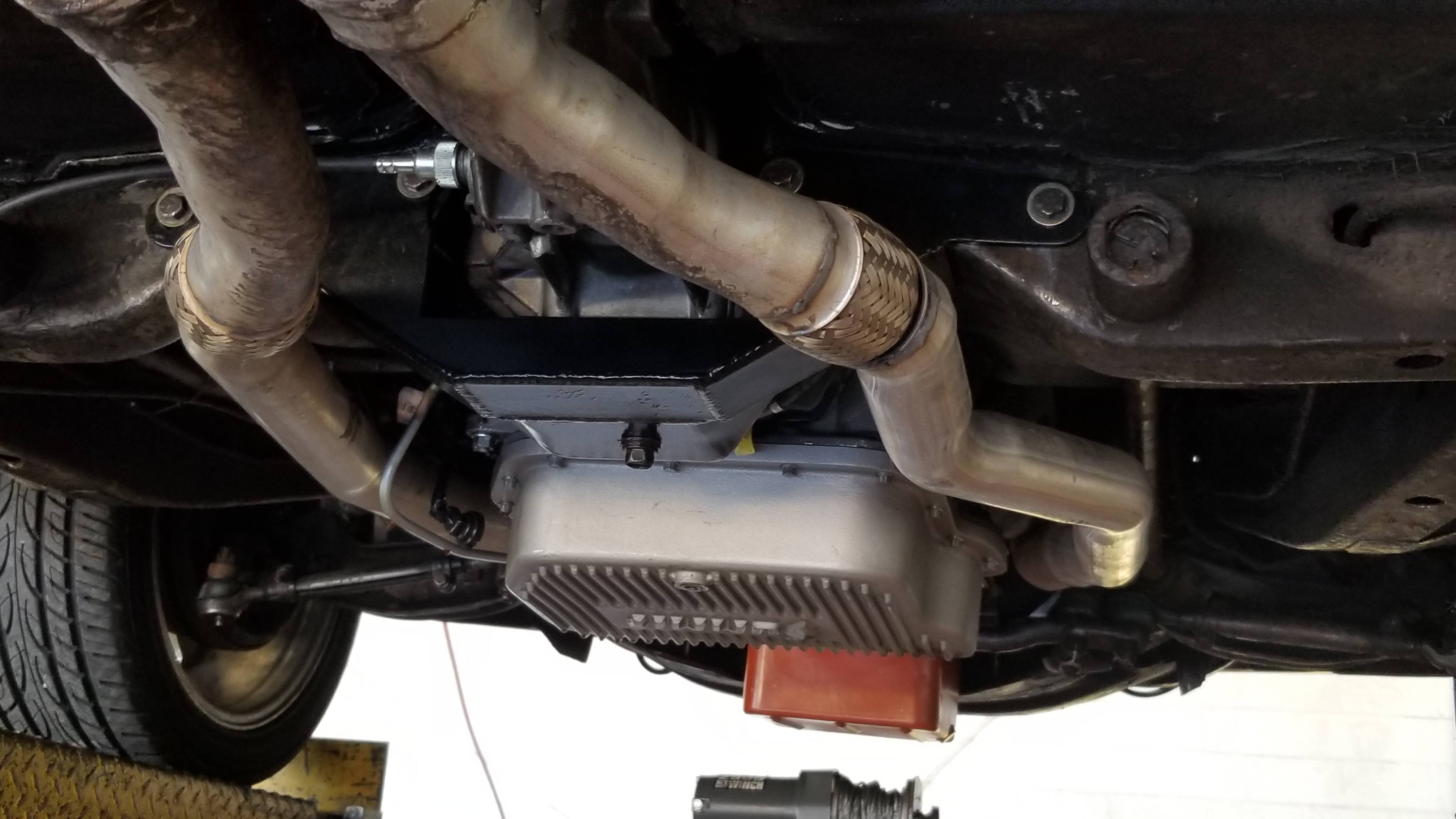

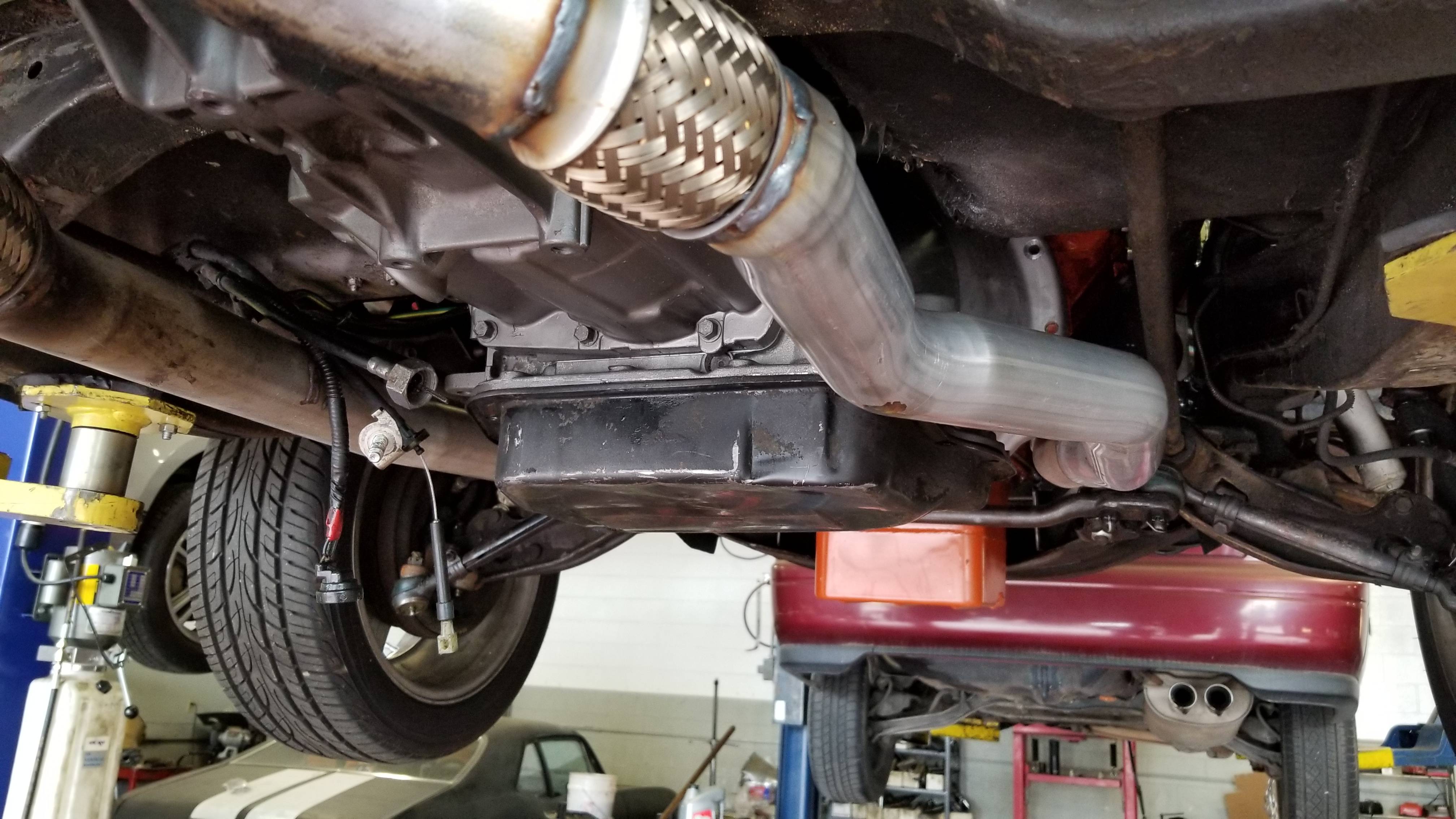

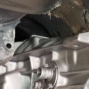

727 (3 speed) => A-518 (4 speed) swap

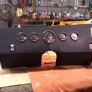

Custom Dash / Autometer gauges

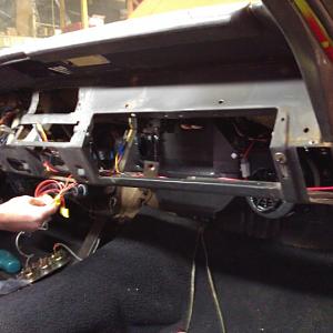

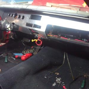

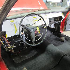

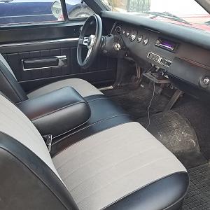

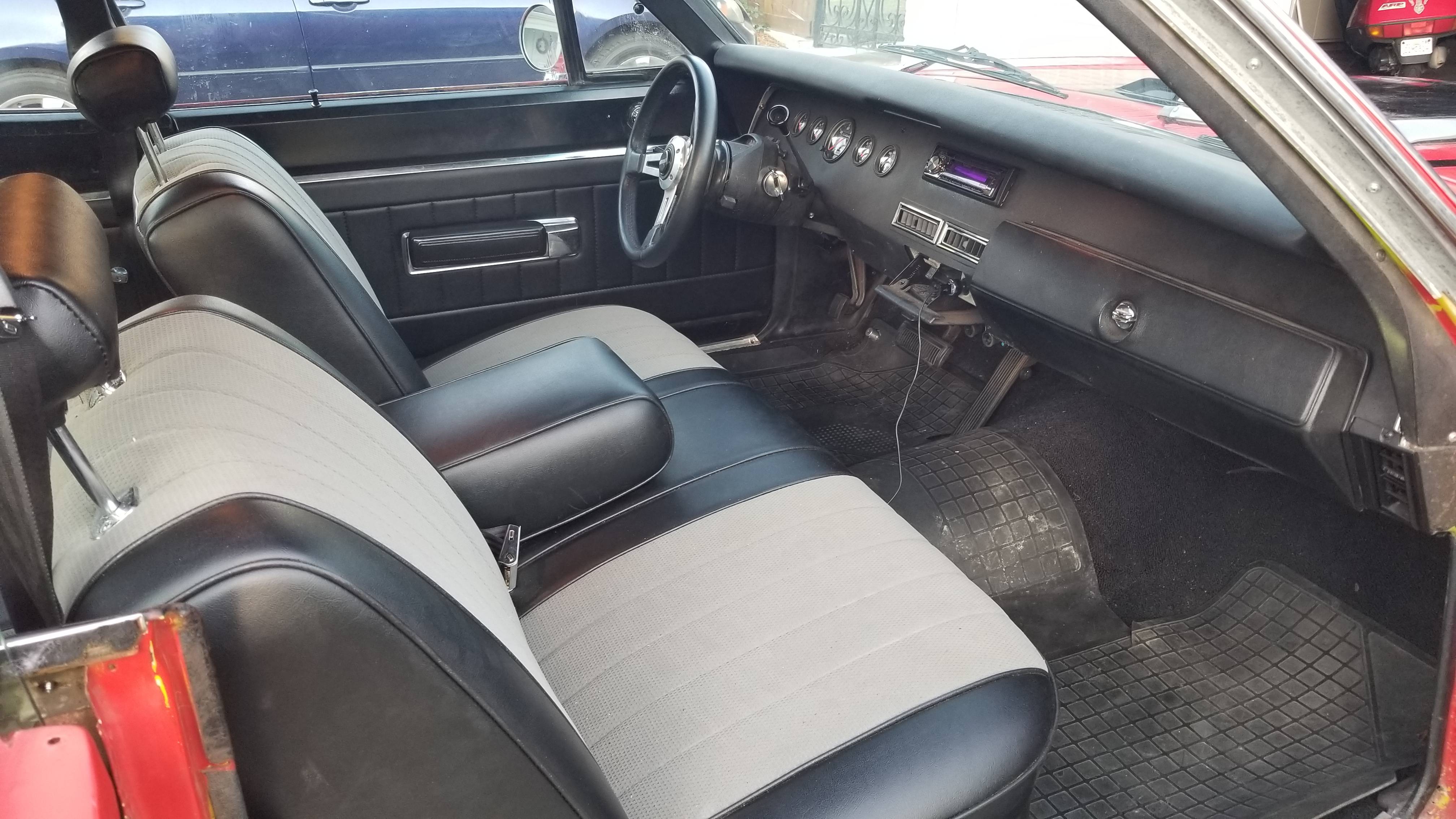

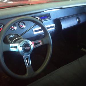

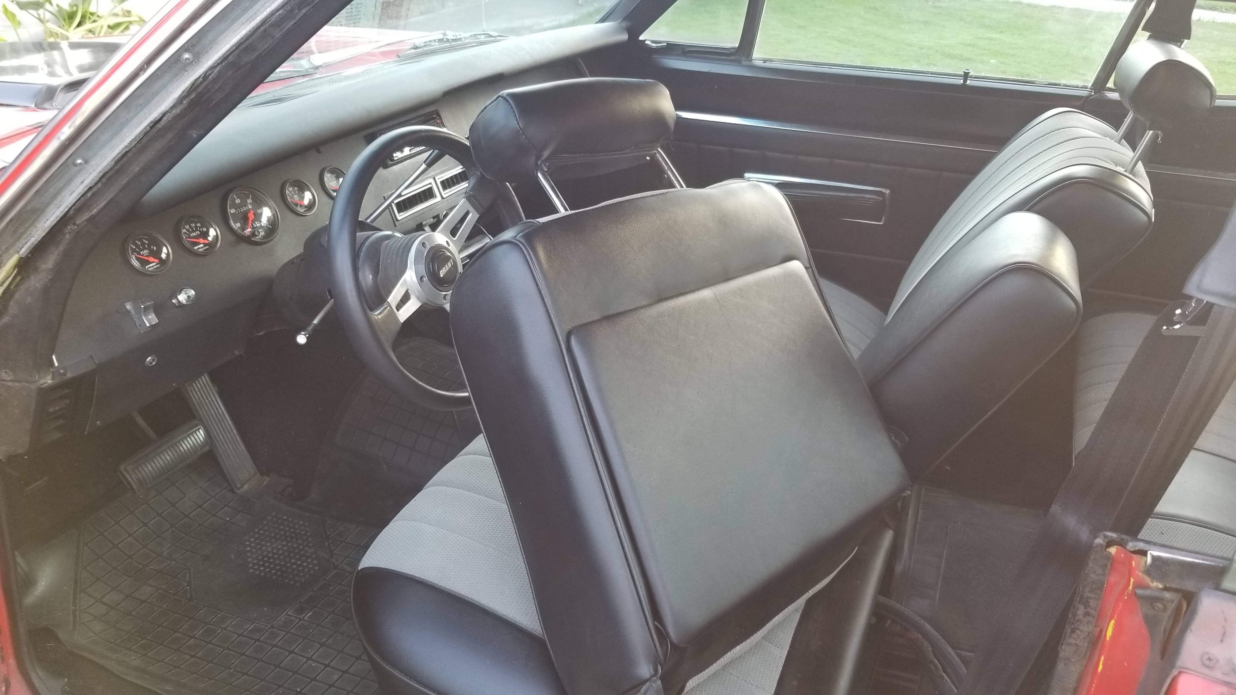

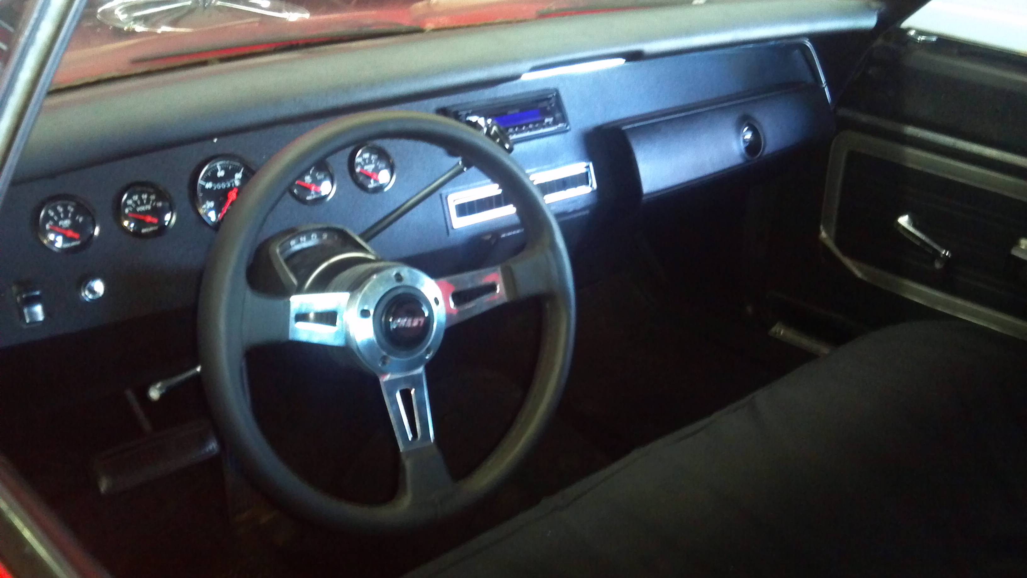

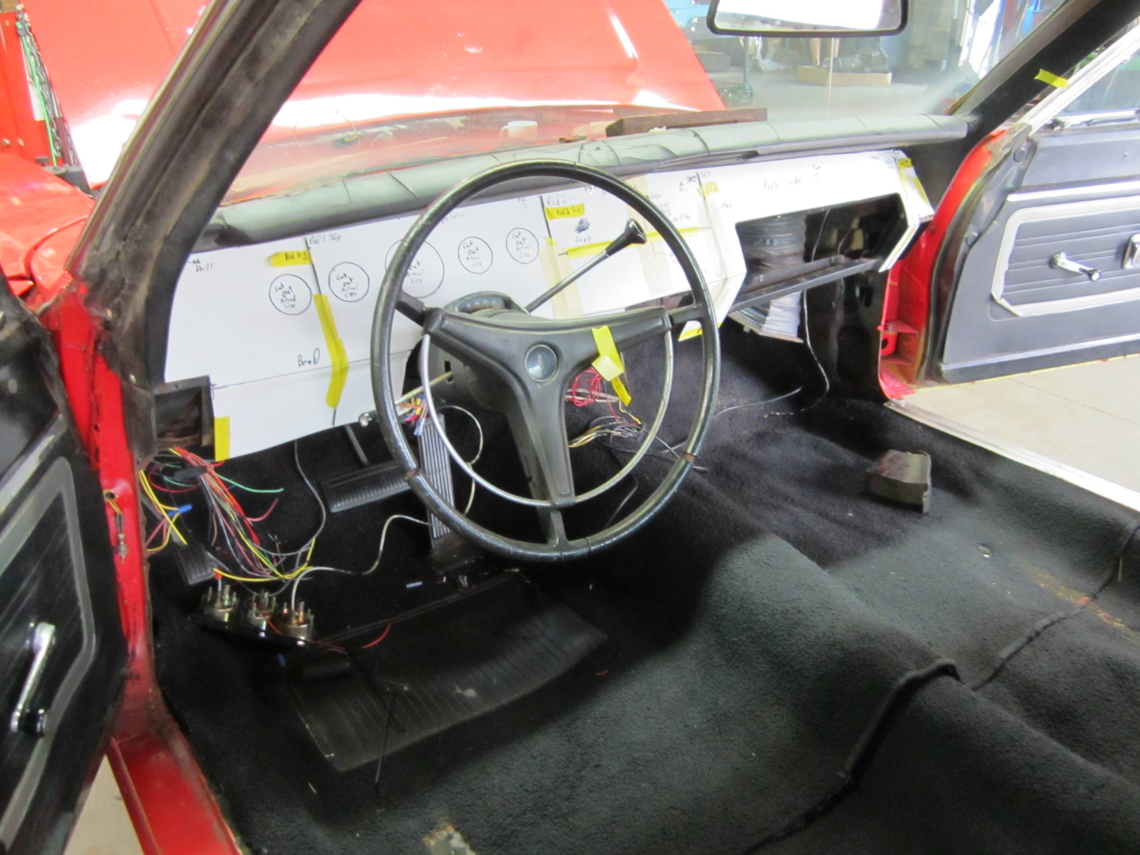

Nice Work! Where did you hide the ac/heater control panel.
You can see them under the dash. (3 knobs).
They made a kit to replace the stock controls - it is Vintage Air, but my mechanic did not order. It works and the original controls were clunky anyway. Horrible even.

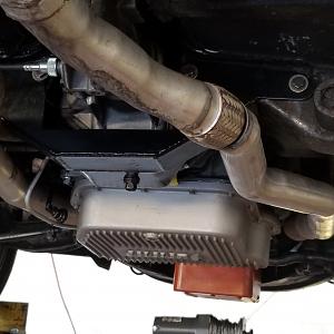

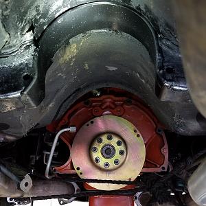

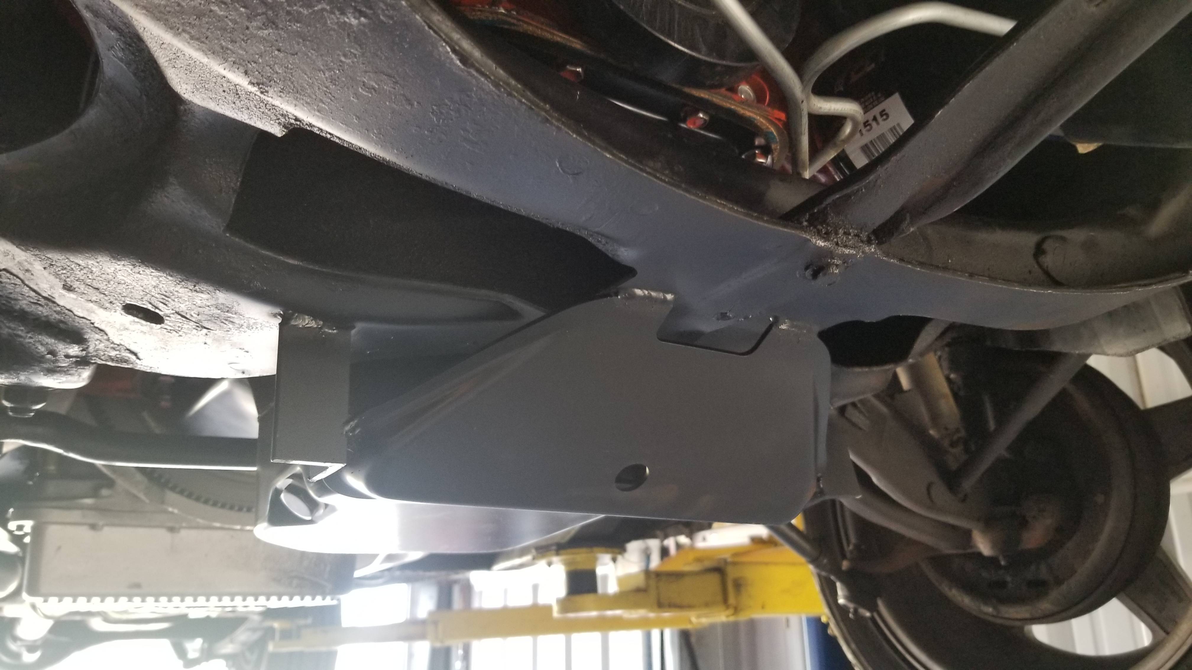

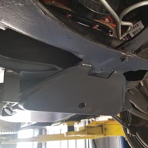

Nice. How did you set up the overdrive and/or converter lockup switches?
Used a PATC kit:
https://transmissioncenter.net/shop/patc-727-to-518-46rh-conversion-kit-click-here-for-727-to-46rh-swap-wiring-diagram/
We had to use a switch that hooked up to the speedo for going in to OD at 43 mph.
The vacuum switch just was not gonna work with my cam / stroker engine. It would shift down with ANY acceleration. Would have been simpler...
Hmm....we have something like this for the kickdown:
https://www.lokar.com/assets/instructions/INS0046-ChryslerKickdown.pdf
