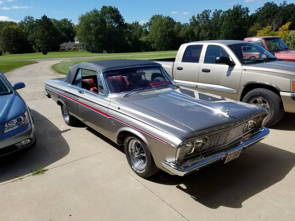

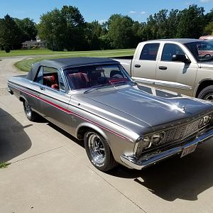

I have made a lot of posts over past year getting a lot of help from smart forum members to do the resto. Thought I'd post a pic here. It's about done but some other things to finish yet. Though I don't think there's a finish line with our vintage rides! Used to be white with white top until my brother talked me into color change. Must have looked over a 100 colors to find this one and a mopar color it is. Tell ya there's a lot more than 50 shades of gray! Ron h

tbone is right, need more pix. the red side moulding absolutely kills against the grey paint!!!

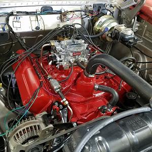

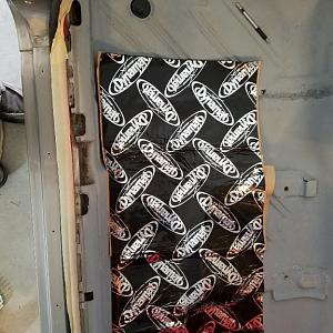

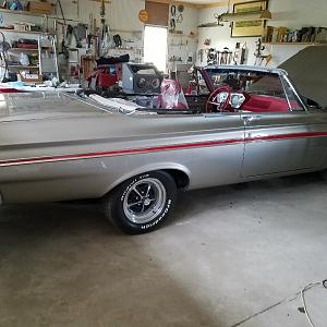

Here's a couple more pics I'll get some more new pics of the body. Dyna-matted entire inside new carpet, mats, and another pic of car in garage before getting black top installed. Engine is the redone poly re-machined with .60 bore, 5-way valve job, mech lifters, slightly mod cam, new edlebrock, 3-inch X exhaust with TTI headers, firm-feel steering box, discs, 3:55 gears, new TC, installed later B-body headrests on buckets, and if wondering about dash it's a '62 dash as liked the look of that over the '63...hard to remember all the s*** done offhand, went to coker for 15-inch magnums P235/60 tires. Then had to find a fan shroud (got an original from a fellow forum member) and 7 blade fan to knock down hotter engine temp.
