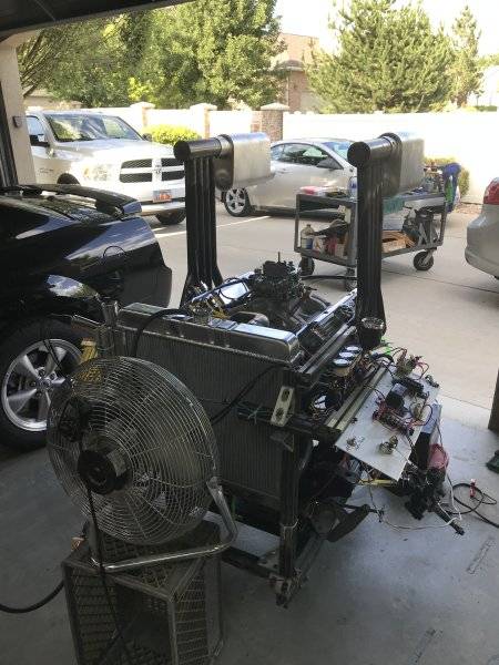

440 took its first breath in a decade..
Fired right up with no drama
I have videos but can't post

Getting ready to fire up the 440 for the first time, check for oil leaks and hopefully break in the cam without any drama...
65Bel
65Bel
Fingers crossed and :praying:
