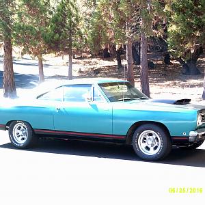

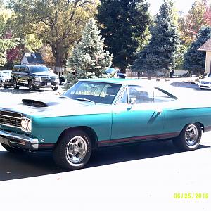

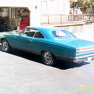

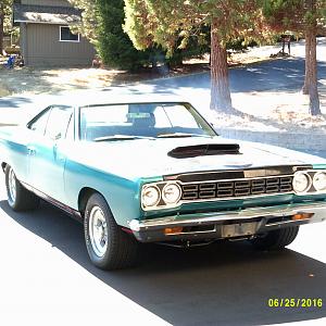

Latest 1st time out in the sun
still no cut & buff 10-29-2017
never mind the date/time stamp this was an hr or so ago
Oct. 29th 1:00pm

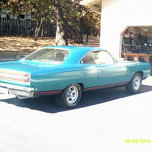

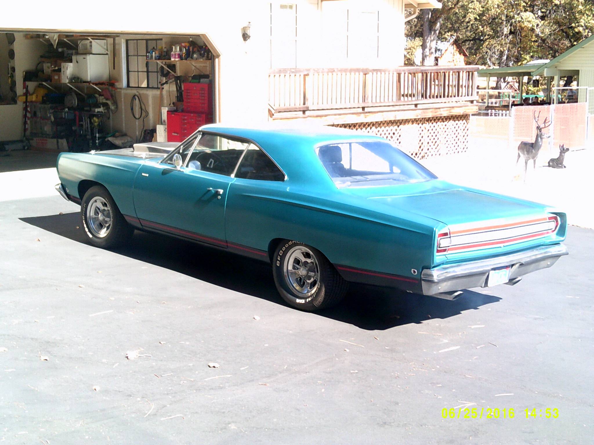

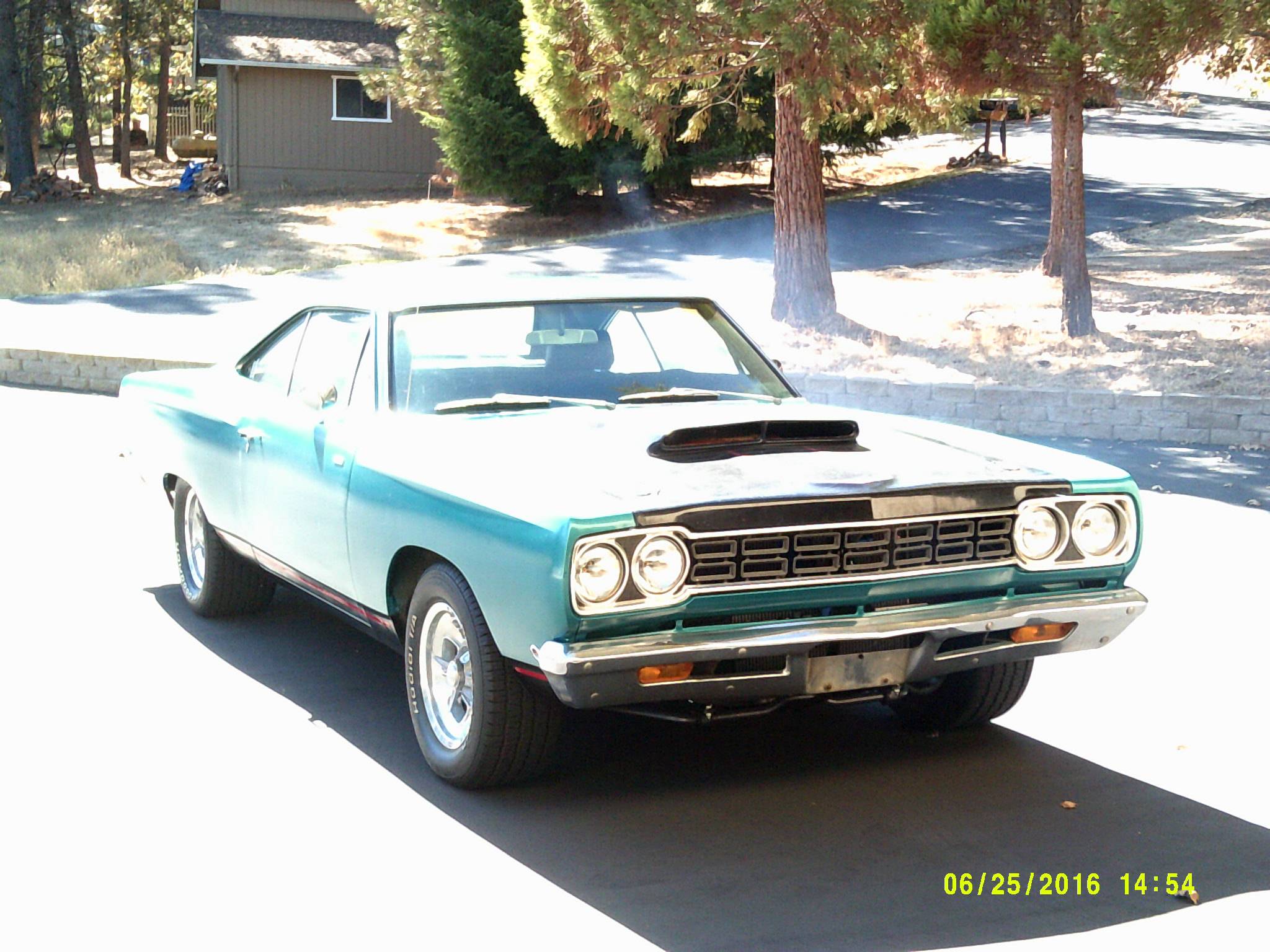

STILL Not finished
, but I figured I would share a couple more of photos,
The B_I_T_C_H as she's know 63,000 {now has 67k 10-2013} original miles
She was under a tree for 10 years in Sacramento/Rio Linda area
& had a 3" deep crease down the drivers side when I got it...

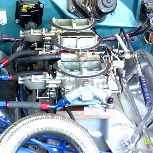

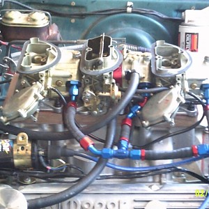

Outside is some what stock appearing with a A-12 6bbl lift off pinned hood
& Polished Edelbrock/Halibrand Kidney Slots
15x7 & 15x9 with 245/15/60 BFG Ta's & 295/15/50 BFG Ta's.
68 RR HT 383 auto 0.040" over 4.290" bore,
ARP 12 pt. &/or stainless hardware everywhere, tons of aluminum stuff,
Edelbrock RPM heads, MRE Custom rad, MP Alum water pump housing
& Pro-Comp electric 38gpm pump, MP cast polished valve covers...
Custom Crane Hyd. Roller camshaft & Retrofit lifters, 1.6:1 Super Gold roller rockers...
3" mandrel bent Flowmaster exhaust, Delta 50 Racing series mufflers,
with H-pipe, 3" tailpipes all the way out the rear...
OS Hellwig sway bars 1-3/8" front & 1" rear...
{currently 3.23:1}

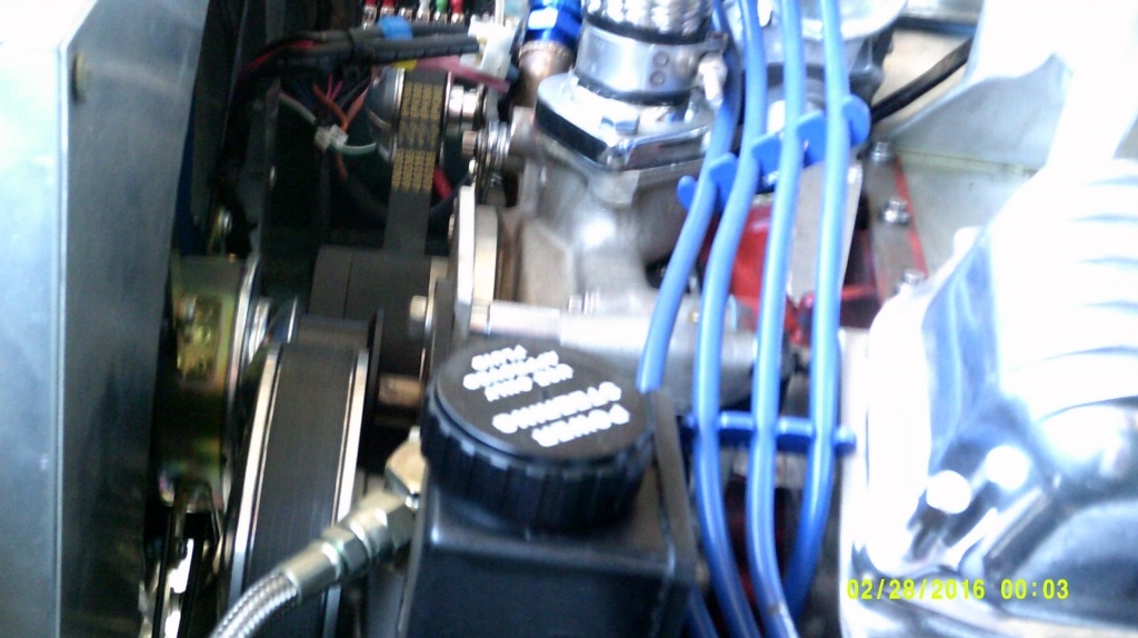

Unisteer rack & pinion steering, Edelbrock IE Gas shocks
& SSBC Force 10 disc Brakes...
Original Black Decore interior & Scat-ProCar Elite 1100 series Bucket seats,
Tuff GT wheel, custom Painless 4 switch panel & complete electronics
on a custom relay panel system...
Soon to be a custom gauge panel {see below}...
MP chrome ignition box & adj. vac. adv. MP CEI distributor, new ign. curve,
dual electric BeCool fans 16" 2950cfm puller in a custom alum. shroud
& 13" 2650cfm pusher...

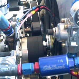

All Aeromotive S/S 175 gpm Elect. fuel pump,
Quick Fuel in the Center 2300 carb & Promaxx performance parts
& adj. jet plates in the outboards, Holley 6bbl set-up,
HP 50cc pump & different springs in the outboard carbs,
New fuel system, new fuel tank, sending unit
& #6 AN feed & #4 AN return lines, Aeromotive bypass style fuel reg. & gauge...
i10317.jpg 68 RR #29 479ci-6bbl #6 AN lines & phenolic spacers.JPG 68 RR #27 479ci-6bbl.JPG 68 RR #30 A-12 6bbl pan & fresh air air-cleaner w-phenolic spacers.JPG
68 RR #36 479ci Fuel reg. fron to engine rad etc..JPG 68 RR #37 Power Steering Pump for Unisteer rack & pinion serpintine belt acc..JPG 68 RR LL1 10-29-2017 #1 DS frt.JPG 68 RR LL1 10-29-2017 #2 DS rear.JPG
68 RR LL1 10-29-2017 #3 PS rear.JPG 68 RR LL1 10-29-2017 #4 PS frt.JPG 68 RR LL1 10-29-2017 #5 frt hood.JPG 68 RR #27 479ci-6bbl.JPG
68 RR #30 A-12 6bbl pan & fresh air air-cleaner w-phenolic spacers.JPG 68 RR #36 479ci Fuel reg. fron to engine rad etc..JPG 68 RR #37 Power Steering Pump for Unisteer rack & pinion serpintine belt acc..JPG 68 RR LL1 10-29-2017 #1 DS frt.JPG
68 RR LL1 10-29-2017 #2 DS rear.JPG 68 RR LL1 10-29-2017 #3 PS rear.JPG 68 RR LL1 10-29-2017 #4 PS frt.JPG 68 RR LL1 10-29-2017 #5 frt hood.JPG

based on "description area above" it looks like you stroked the 383. I've thought about putting a LB stroker 383 or 400 back in my RR (44O 6 BBL motor now) car for the weight savings and a little extra room for exhaust. If you've had comparable stock 440's how would you say they compare power and torque wise by seat of the pants?
tallhair; yep it's a 0.040"over @ 4.290" 383 block I've done several of them had pretty good luck... but a larger bore block, like the 400 low deck with a "std bore of 4.34" or larger" or a 440's 4.32" & up, will give you more cubic inches for the same money, or less, more combos available with out ordering custom pistons, for the 383 stroker, the larger bore will also allow the heads to flow "a little better & make slightly higher power"... but the 383 stroked is a decent combo, if you use good hardware & studs, plus a block girdle, which I would recommend on any 2 bolt main Mopar Big Block 361-440 B or RB...The 400 B-Low deck Block is a slight bit stronger in the main bearing web area too, even stroker than the 440 blocks...
