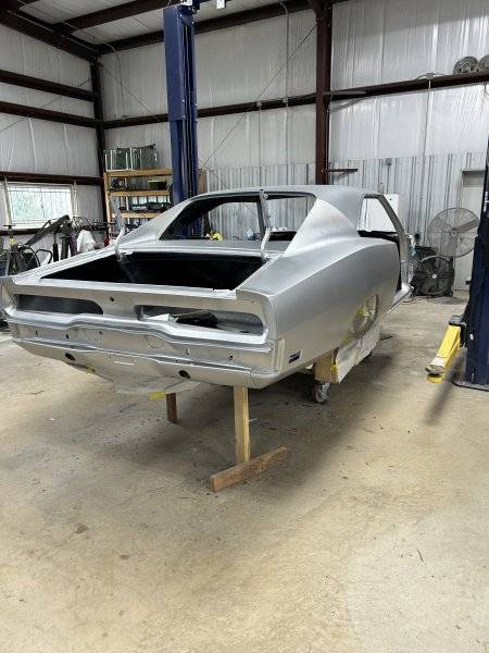

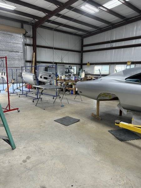

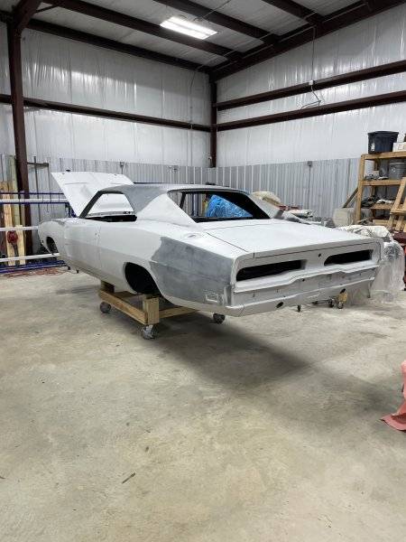

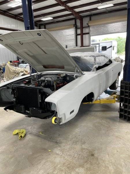

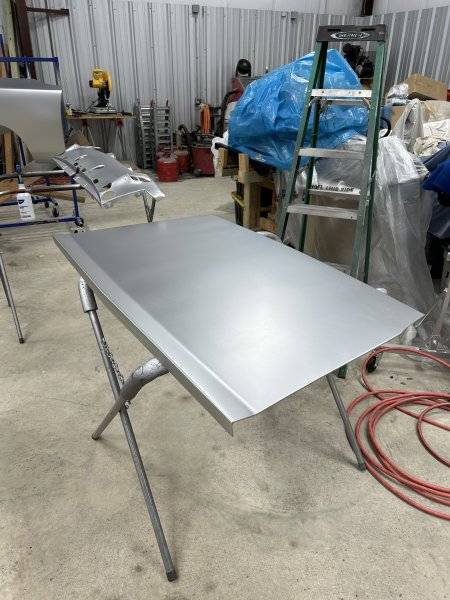

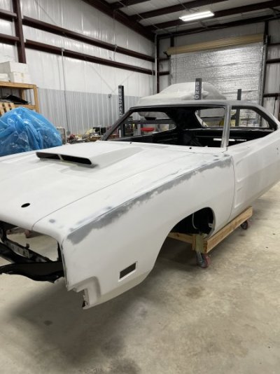

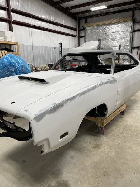

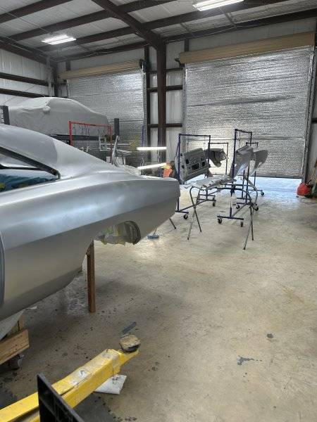

Sanded everything to 600.
Eastwood epoxy primer reduced 20% as a sealer which was a disaster . Had to sand all that smooth.
Silver base coat is on. Next, flake coat, candy then clear, with Pearl in the first coat.
Then on to color sanding etc.
Not going fast but I have a daytime job as well (Photos attached, drilling in 4,000ft of water)

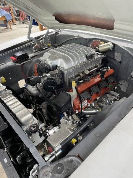

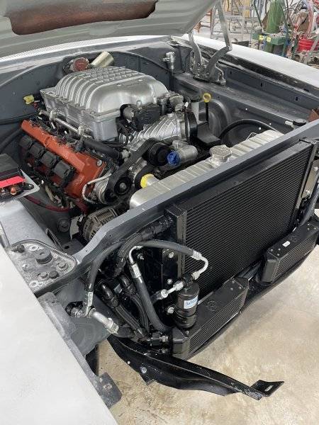

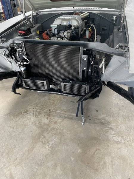

Got the radiator, oil cooler and PS cooler plumbed.
A few AC hoses left.
Still gotta do the fuel line and brake lines.
Heater hoses still have a way to go.
I’m tired of fittings and hoses, etc.
Gonna switch to paint for awhile. I have the layout figured, so time to blow it all apart.
