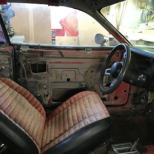

Complete interior replacement, salvage what I can replace what I can’t, a few surprises along the way.
About this Mopar:

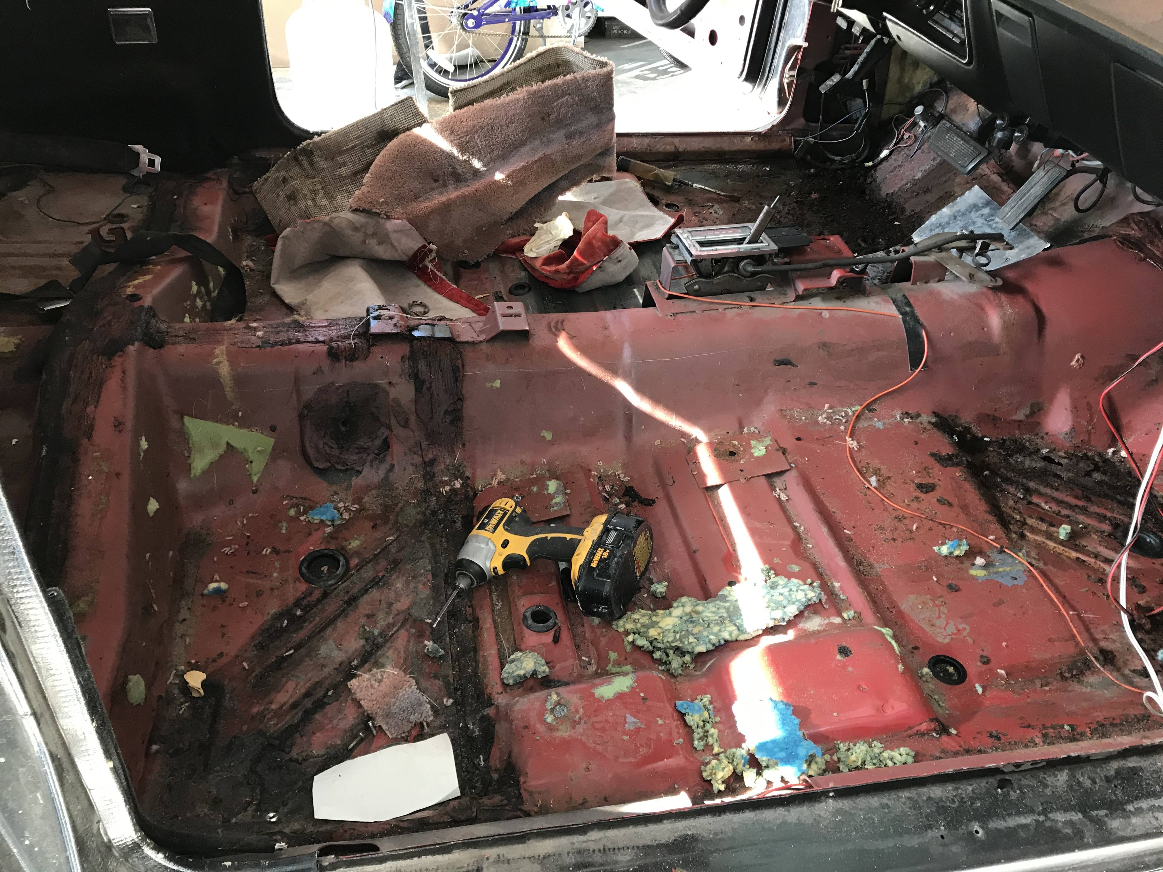

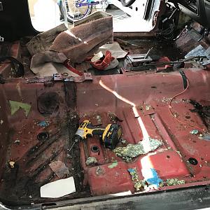

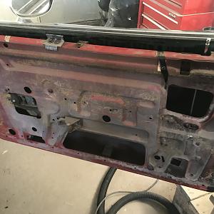

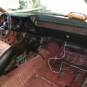

I completely removed all the interior out of my car and starting repairs.

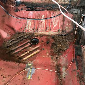

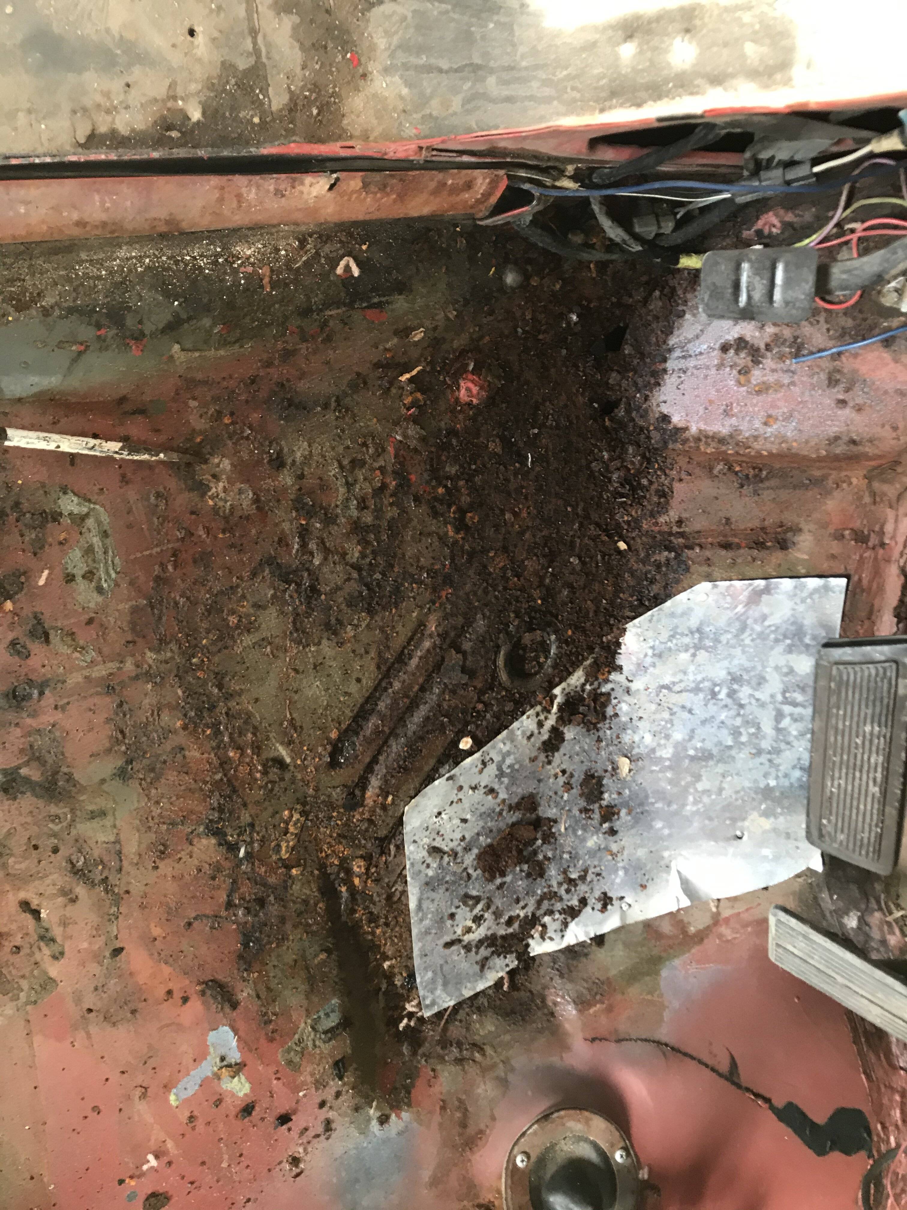

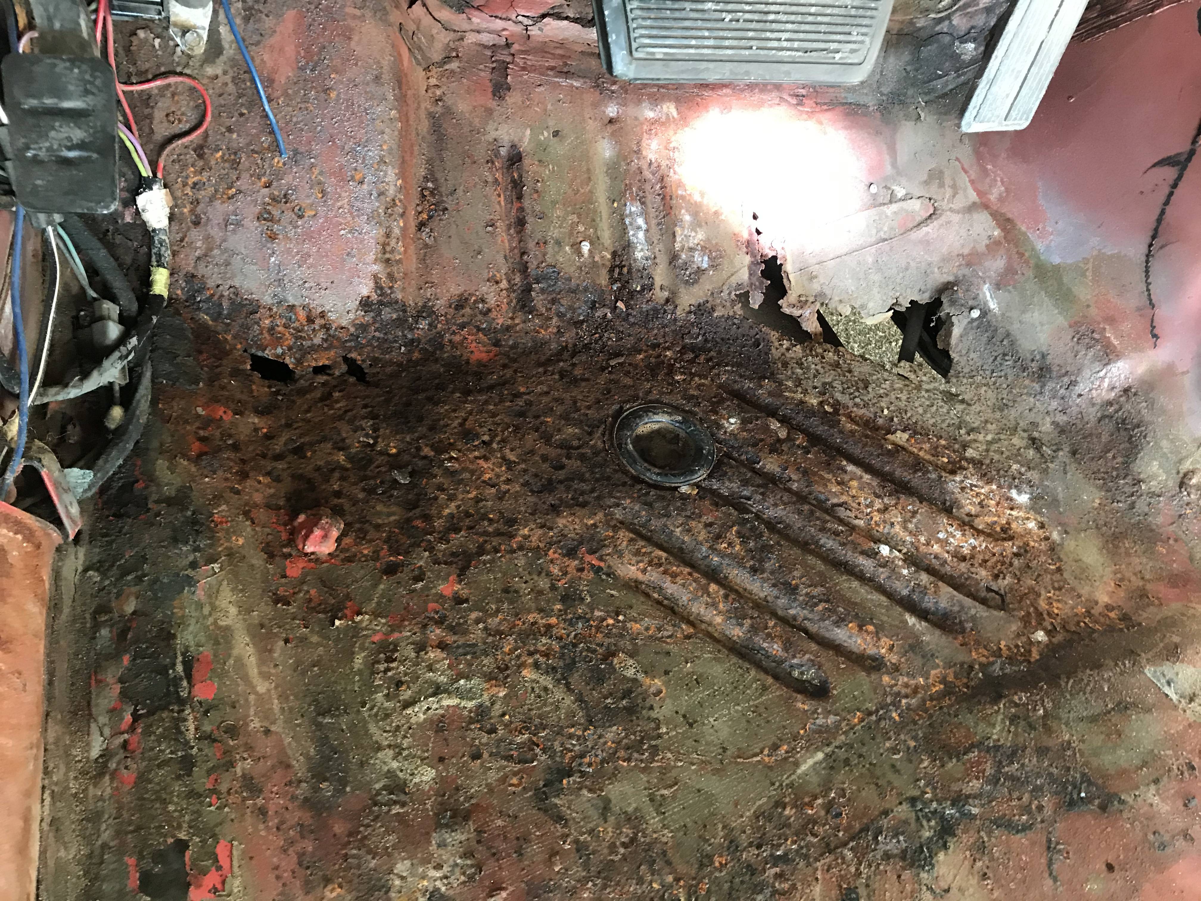

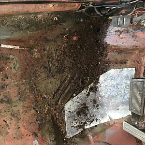

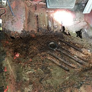

found a bit of rust in the floor pans up front but trunk and rear seat are solid.

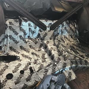

Kilmat 1/2 the floor while I wait for more to arrive.

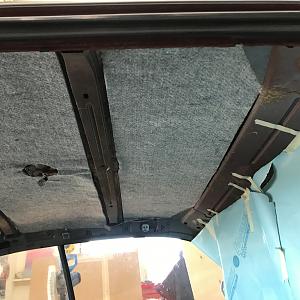

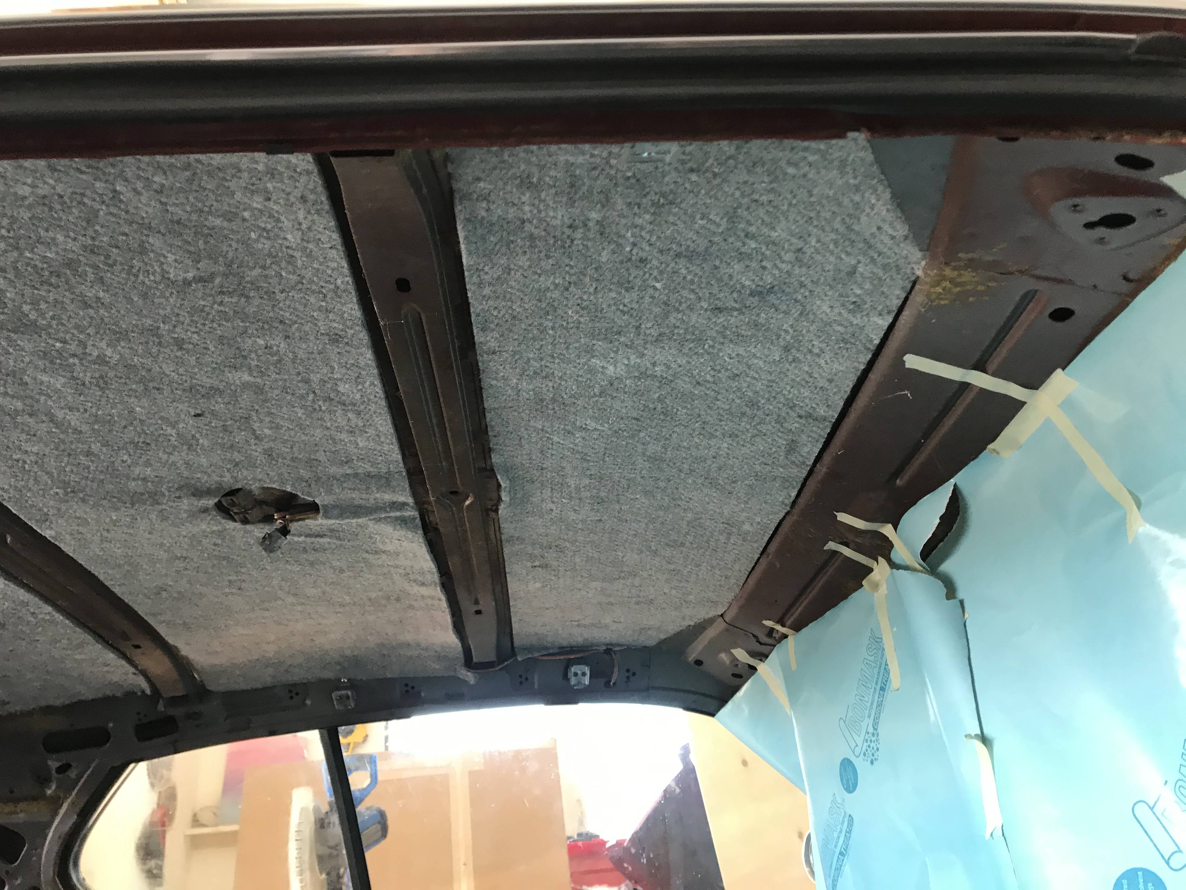

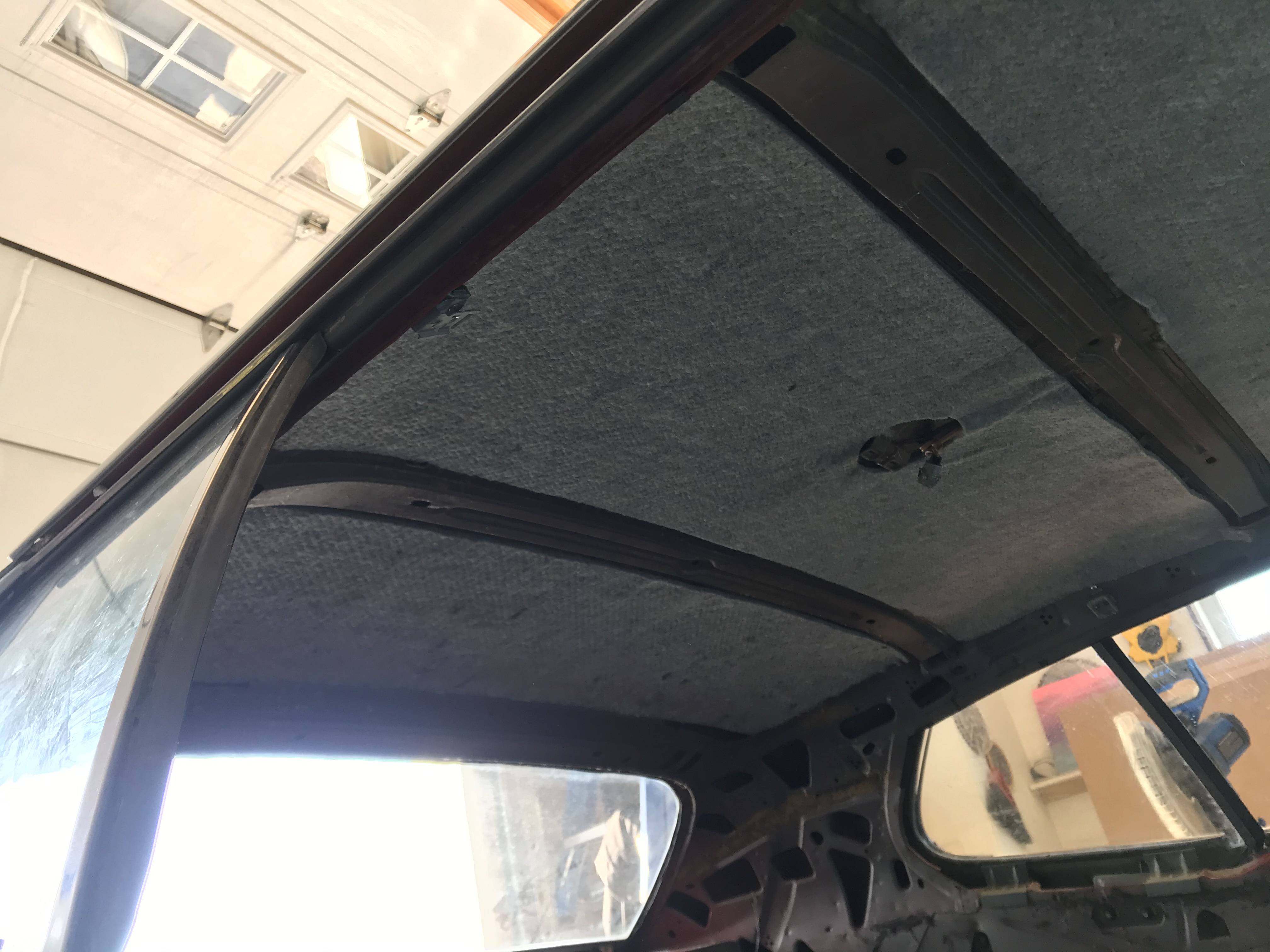

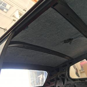

Insulated the roof hope it sticks used permatex spray adhesive

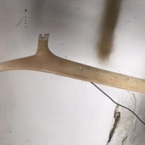

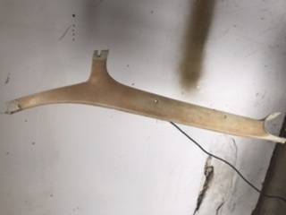

I cleaned up my plastic with goo gone , super clean and brake clean . The latter works best. Now I’m hitting the plastic with a dead match Color coat and plastic adhesion promoter !
Comments
What did you use for insulation on the roof? Have to do the same on my 68 Charger. Looks good!
I bought the kit from classic industries it’s a jute fabric. Actual manufacturer is REM ... not sure where it’s cheaper but shipping for me was the kicker so I got it at classic industries. WWW.Remautoinc.com
Got my roof insulation from summit X matt. Made for roof's and under hood app. Hey good job and a nice start to the restoration. Keep us up on the project.

sorry for the late reply , the GTX is Rallye red ,painted roof, Black&White interior. fairly basic w/power drums only "standout" option is the machine gun tips.
It came with 2 -440 4 bbl engines original and a replacement (in the car). original was removed after machine and rebuild #3 failed compression test. This original engine is a winter project.
Nice to see another GTX coming together. Mine is RalleyRed with white interior & black top. It had very nice legendary black seat covers in it when I bought it, so its staying black for now. Tell me more about your GTX.
i started the interior this summer but , Ive been waiting for a legendary interior 6 months to finish the interior. this gave me time to replace both floor pans and Kilmat the interior.

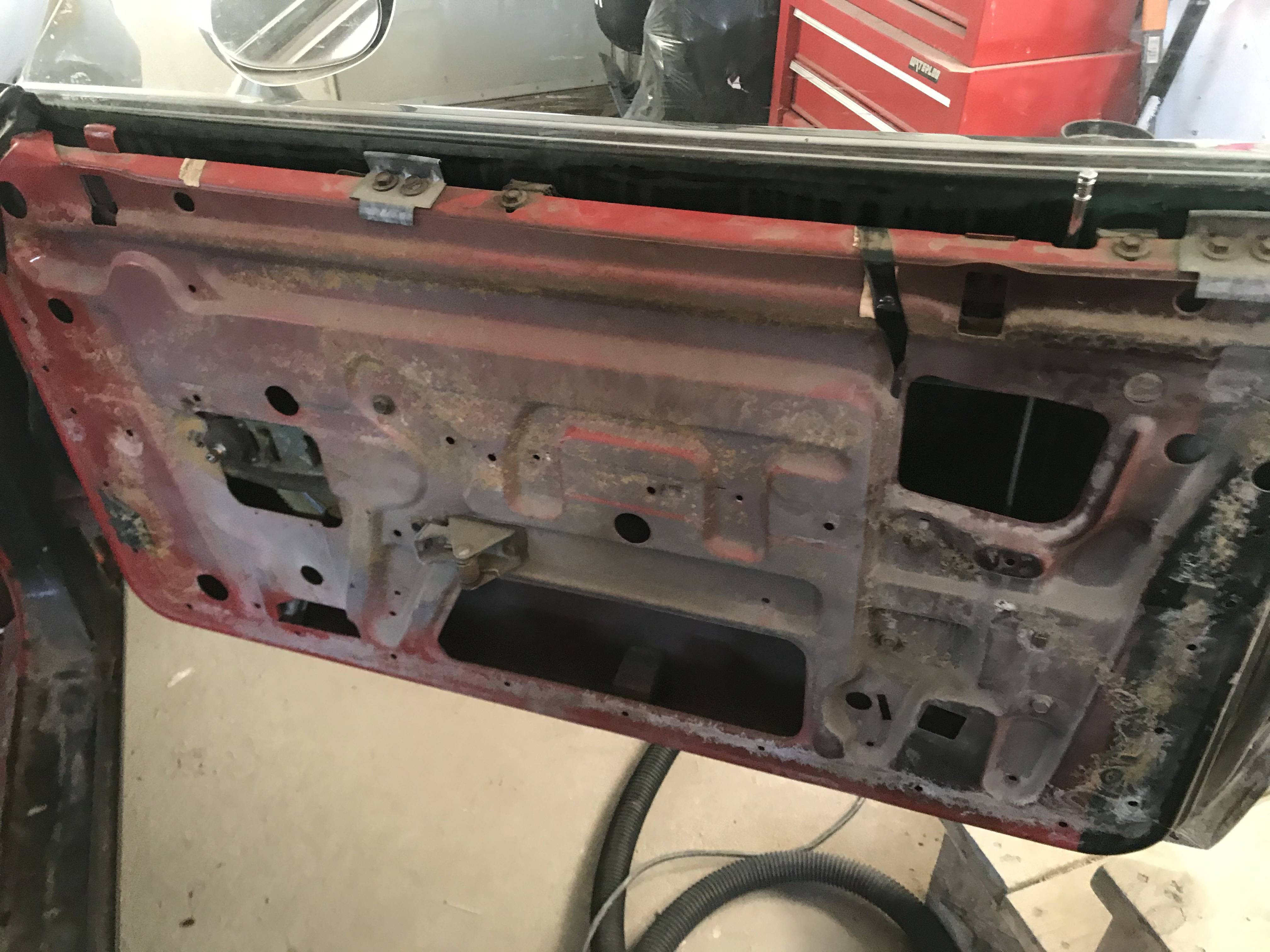

nearly no rust ...couple spots in the wheel well and bottom of the door skins, and what looks like a bad bondo repair in the back pillar passenger side.
what about yours looks like you have 2 ...
