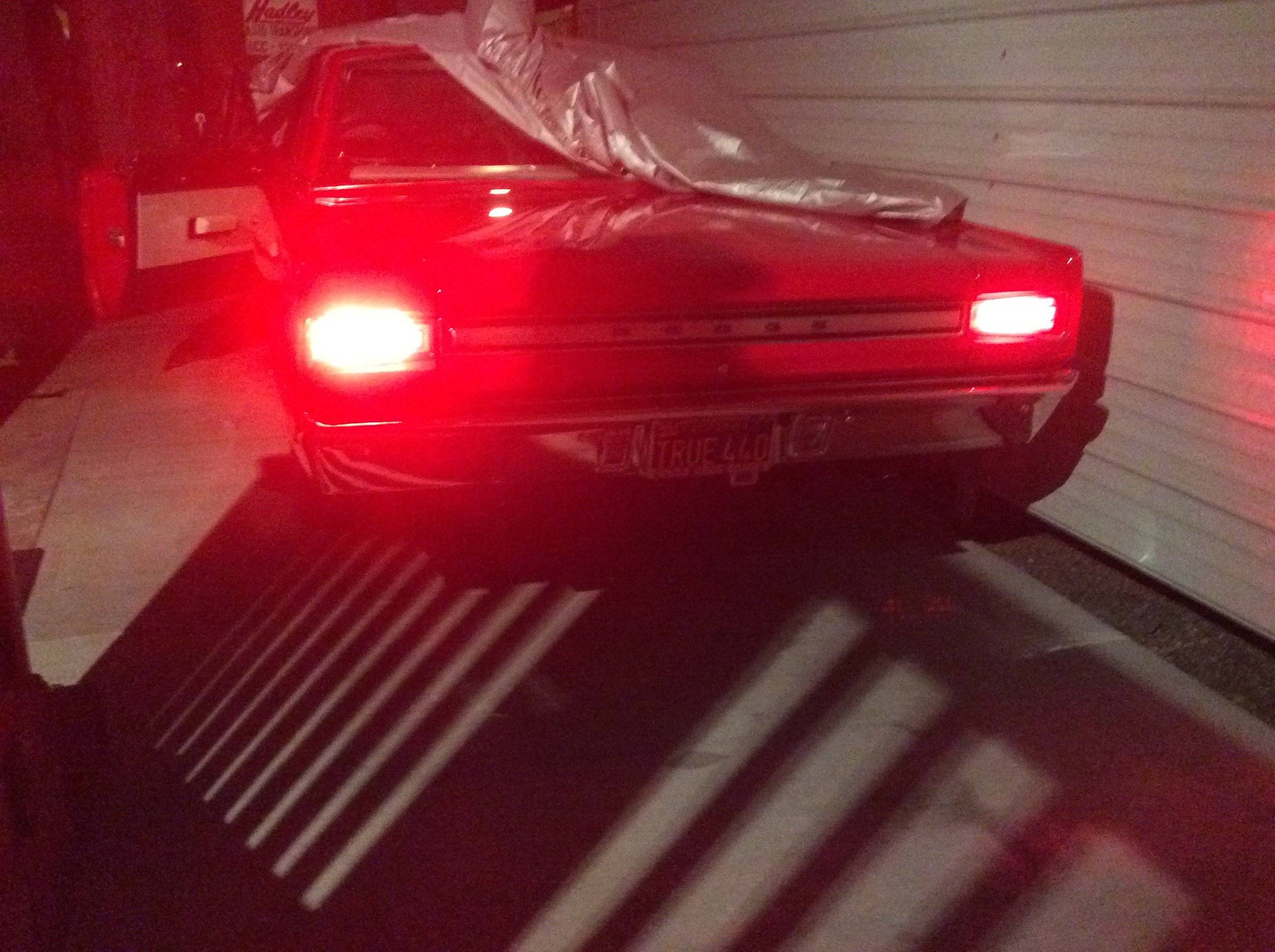

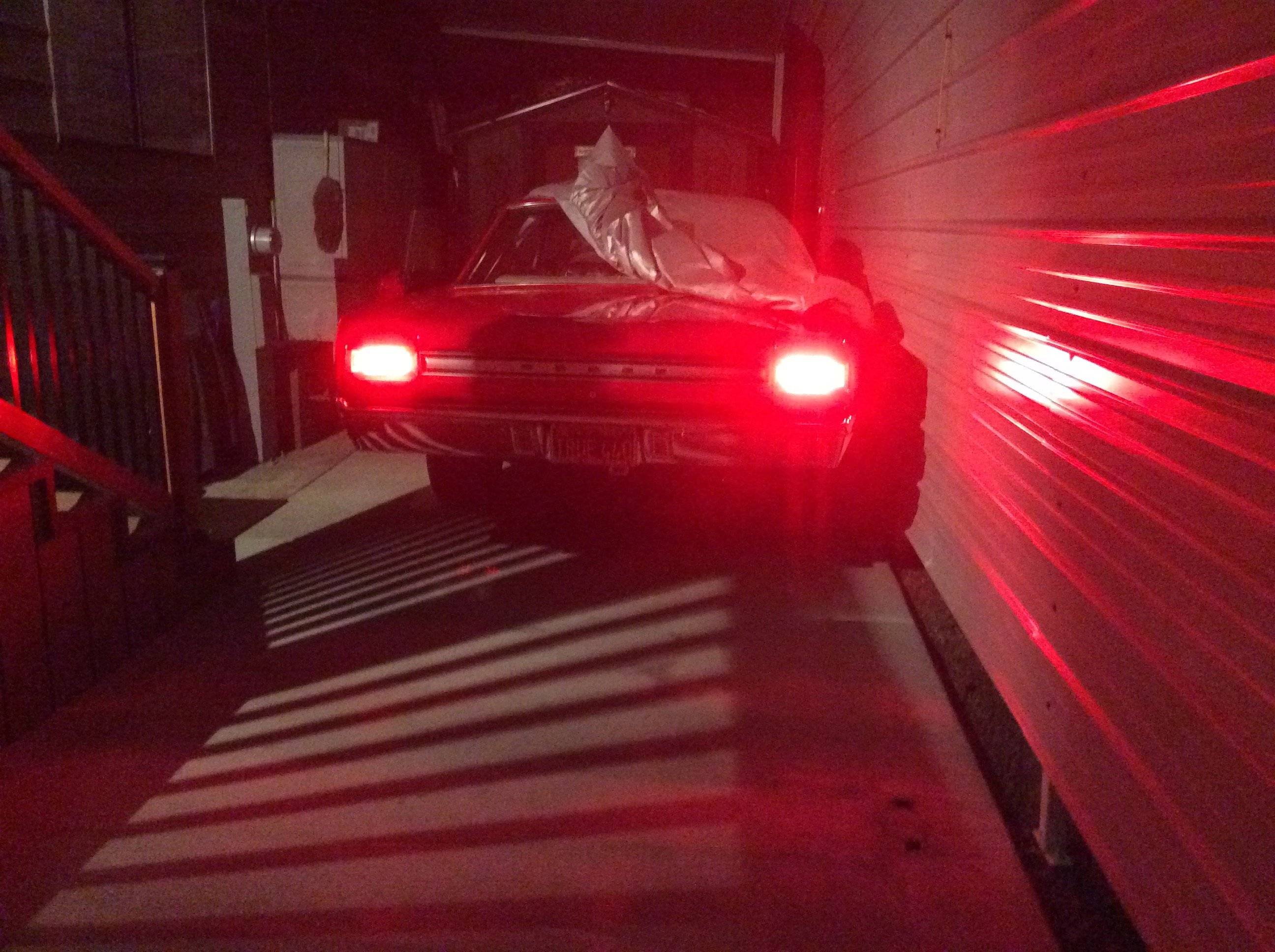

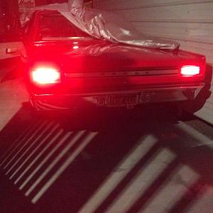

There a little bright to shoot at nite but this is the best I can do with an iPad.
Comments
Where did you get them.
Hi kraig, I made the light out of diesel truck trailer stop, turn, brake lights. There 7 x 2 in. Red led lights that run on a straight 12 volt, no relays needed. Hard wire into existing tail light wires. Mounted in buckets with dense foam to hold in place. About 40 dollars and 2 hours start to finish. 10 times brighter then reg. Lights and a lot cheaper then custom led lights. Go to a truck stop or a truck store that sells led lighting.
