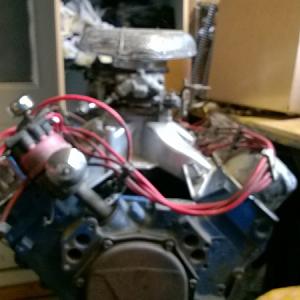

1973 440 RB 0.30^, forged crank 0.10 under, TRW flat top pistons, stock 440 LY rods, six pac push rods, 10* Titanium Locks, dual Springs w/ Titanium caps, stock valve train w/ positive vinyl seals. MOPAR 452 heads fully ported and polished with skirts and shrouding corrected and port matched for intake. M1 single plane, Holley dual feed 750 CFM, Mallory Electronic Distro & coil, all the chrome bits and aluminum pulleys. Mini starter. MH water pump w/ large flow through passage.

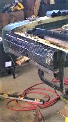

Front bumper recurved, resectioned and shortened. Ends shaped to match and hug the front fender outline contours. Air scoop cut into the center.

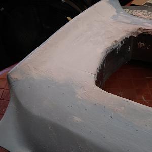

Front fenders sectioned and the noses swept back to a 90* angle with the front of the car.

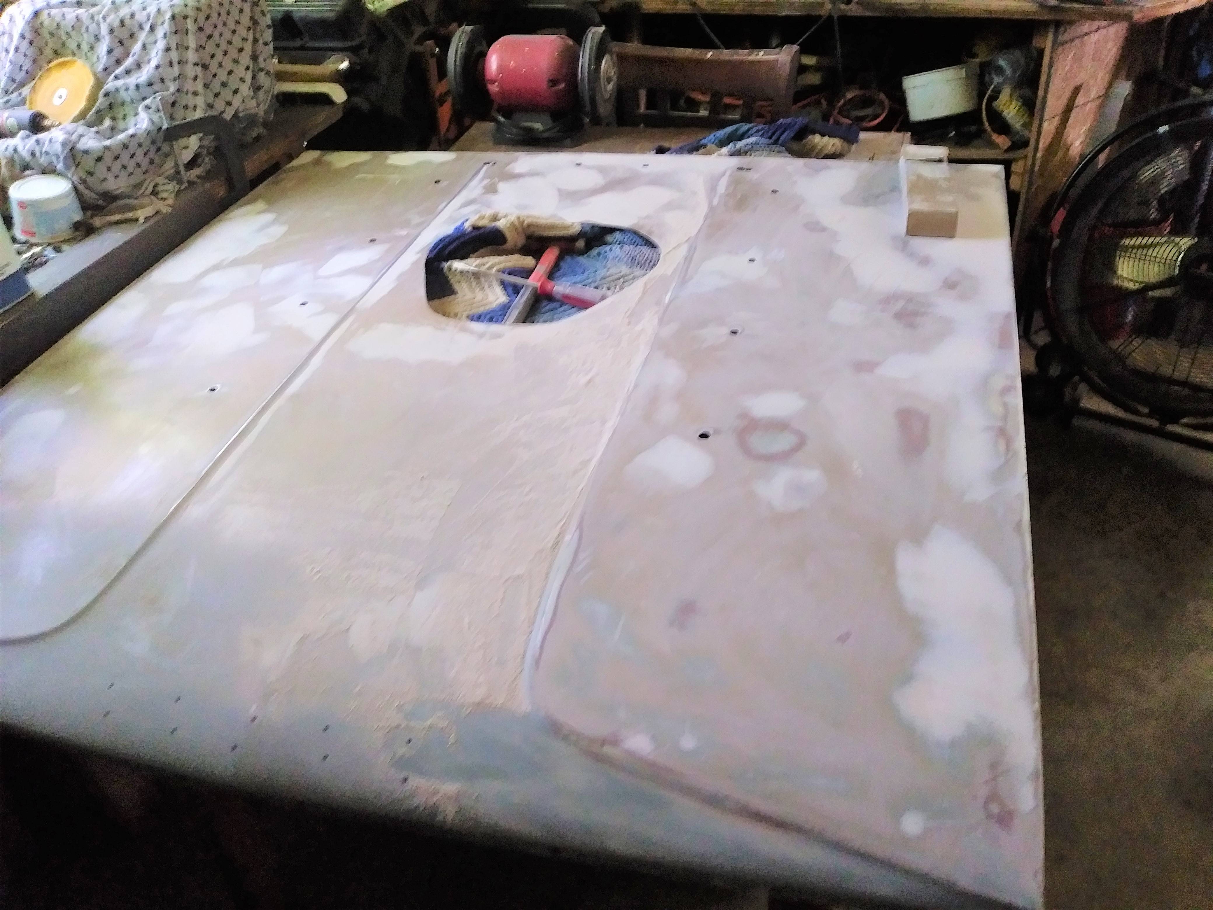

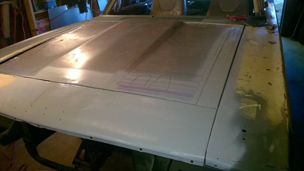

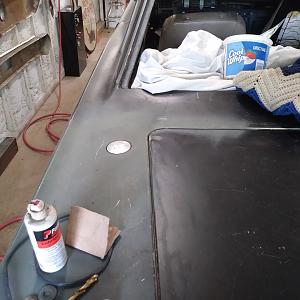

Hand fabricated Hemi scoop, hole in hood.

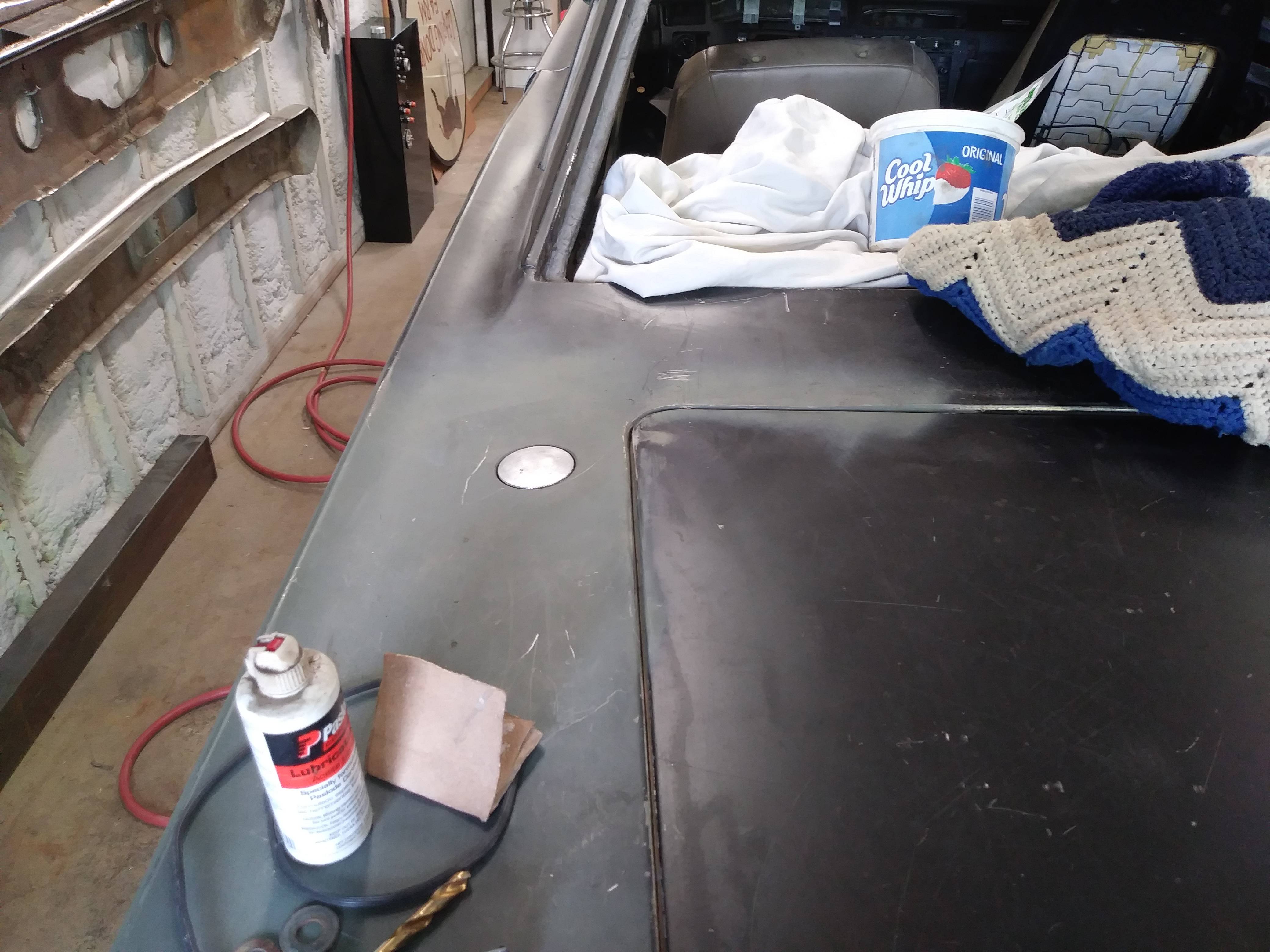

Rullo Motorcycle pop up gas caps on top of both quarters.
stock filler door shaved.

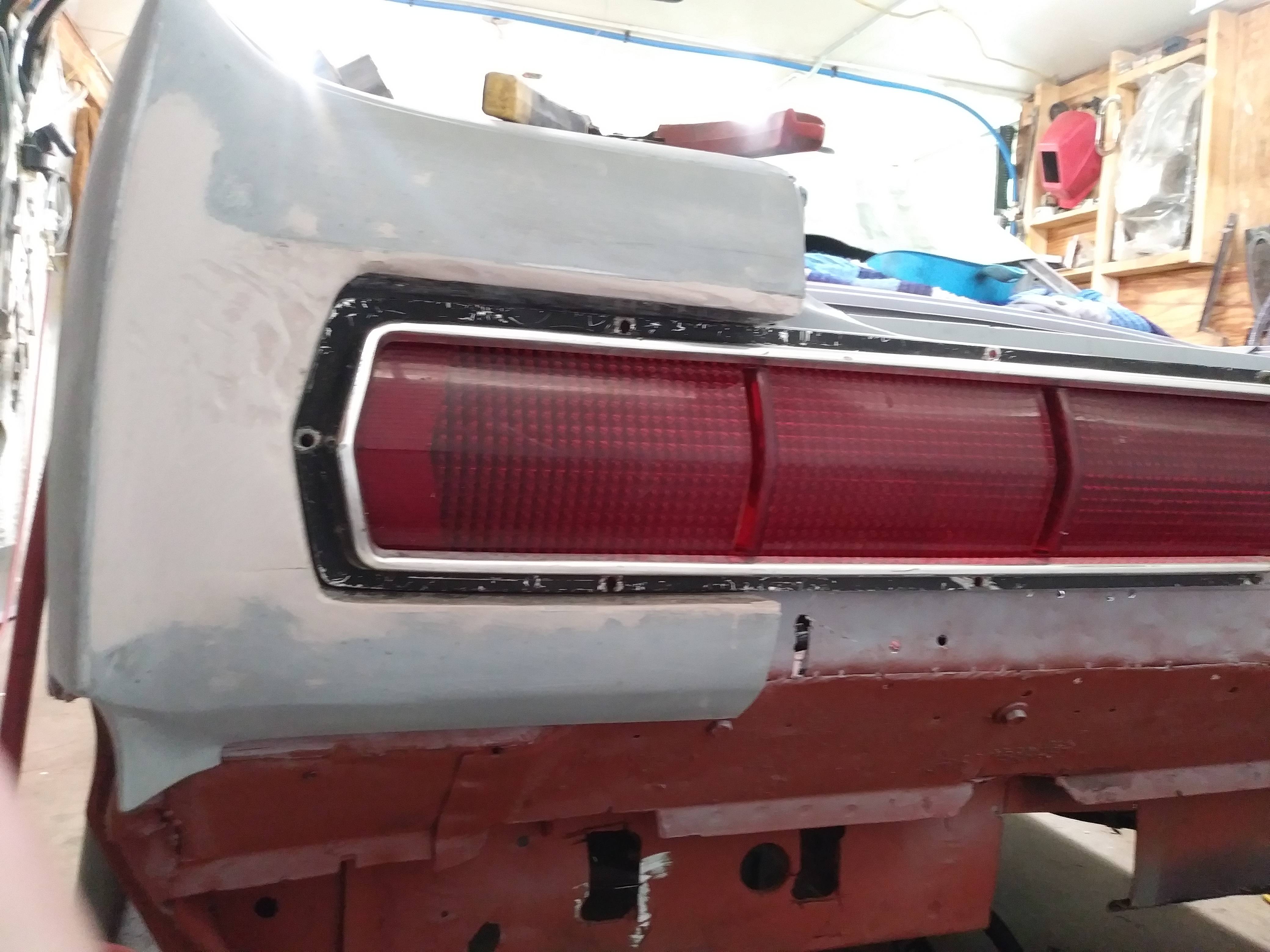

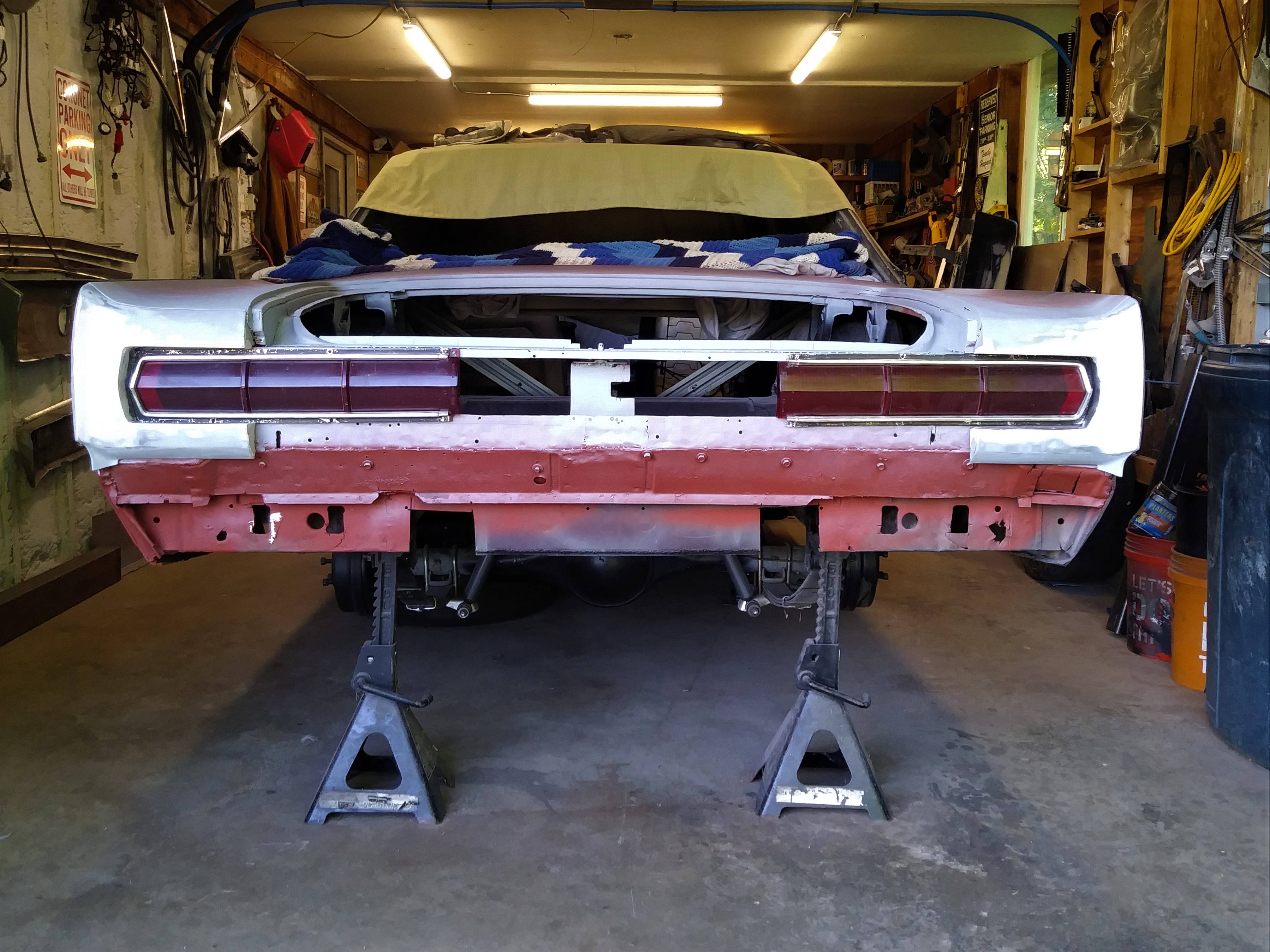

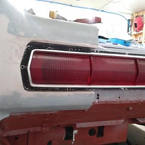

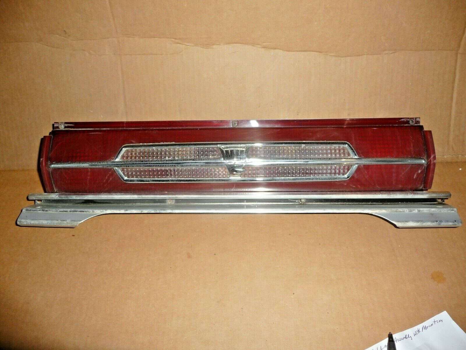

entire rear face of the Coronet reimagined to include custom fabrication to accept 1966 Ford ThunderBird tail lights.

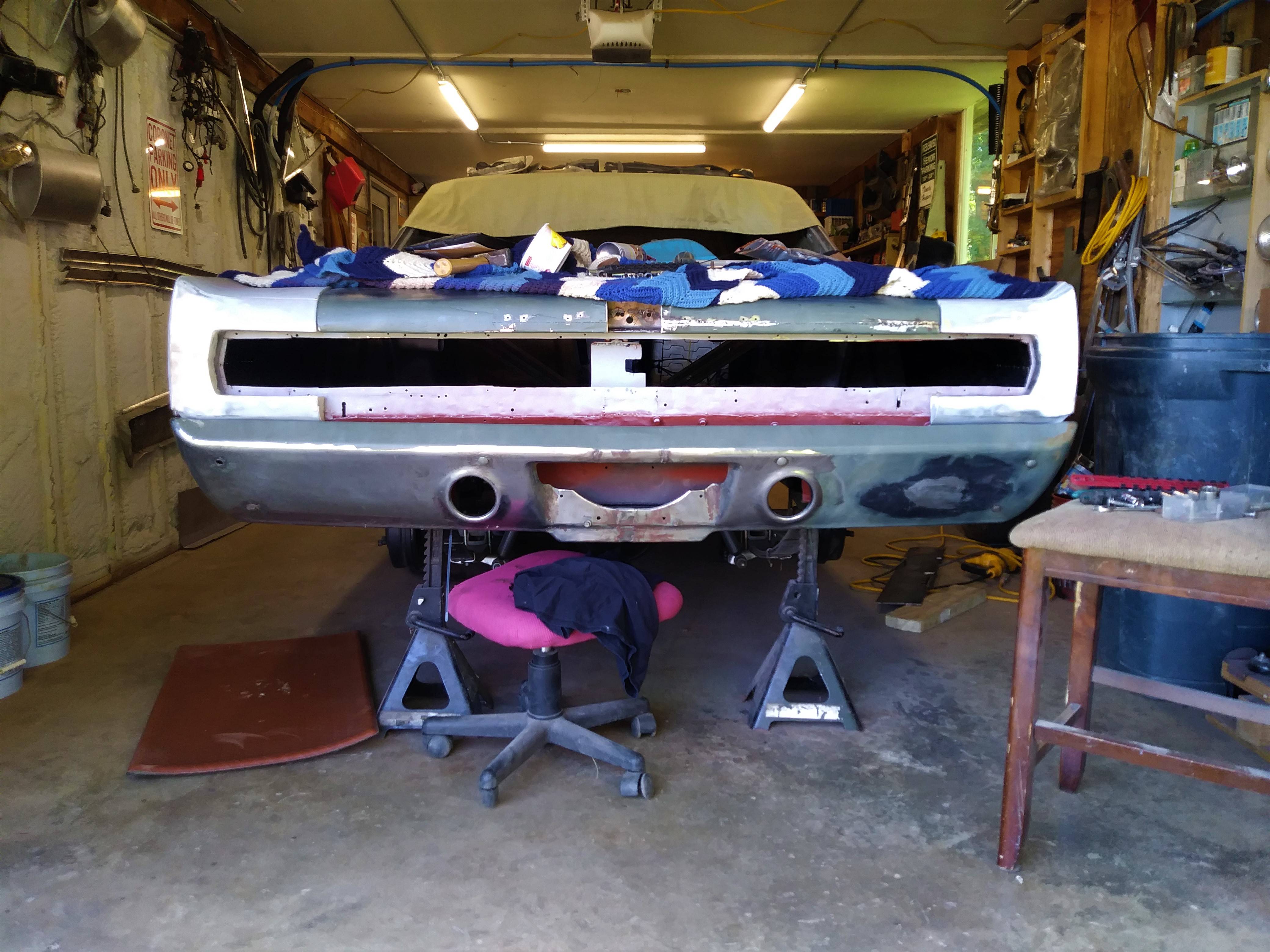

Exhaust tips to extend out of the back up light holes.
Trunk floor replaced with a flat floor.

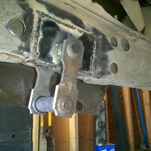

leaf spring relocation kit installed
leaf spring axle pads relocated inboard

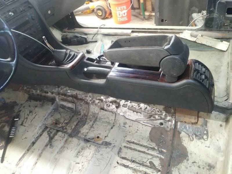

2004 AUDI A-6 dash-console-stereo-digital/ programmable heat/AC, center pull E brake, floor shift console, Audi steering wheel. custom hand built door treatments incorporating sections of the AUDI door panel including the release and pull handles, the lower storage cubbies and the CD changer controls. The doors have the accordion wiring pass through boots and frames installed as well as the white puddle lights on the bottoms and the red marker lights on the rear facing of the doors. Audi Symphony Stereo speakers ( 9) with three in each door.

Custom fabricated shift lever mount, E brake mounts, Console mounts and linkages. Pistol grip shifter custom formed with Black Ash wood handle.

1966 ThunderBird Sequential tail lights with controller.

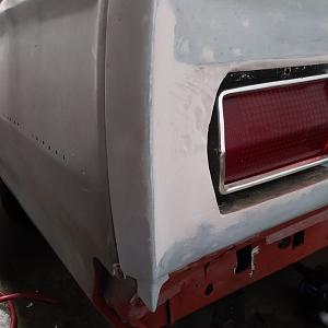

Tail light extension fabrication

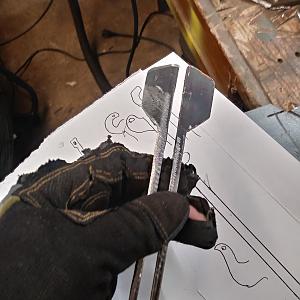

Door pull fabrication

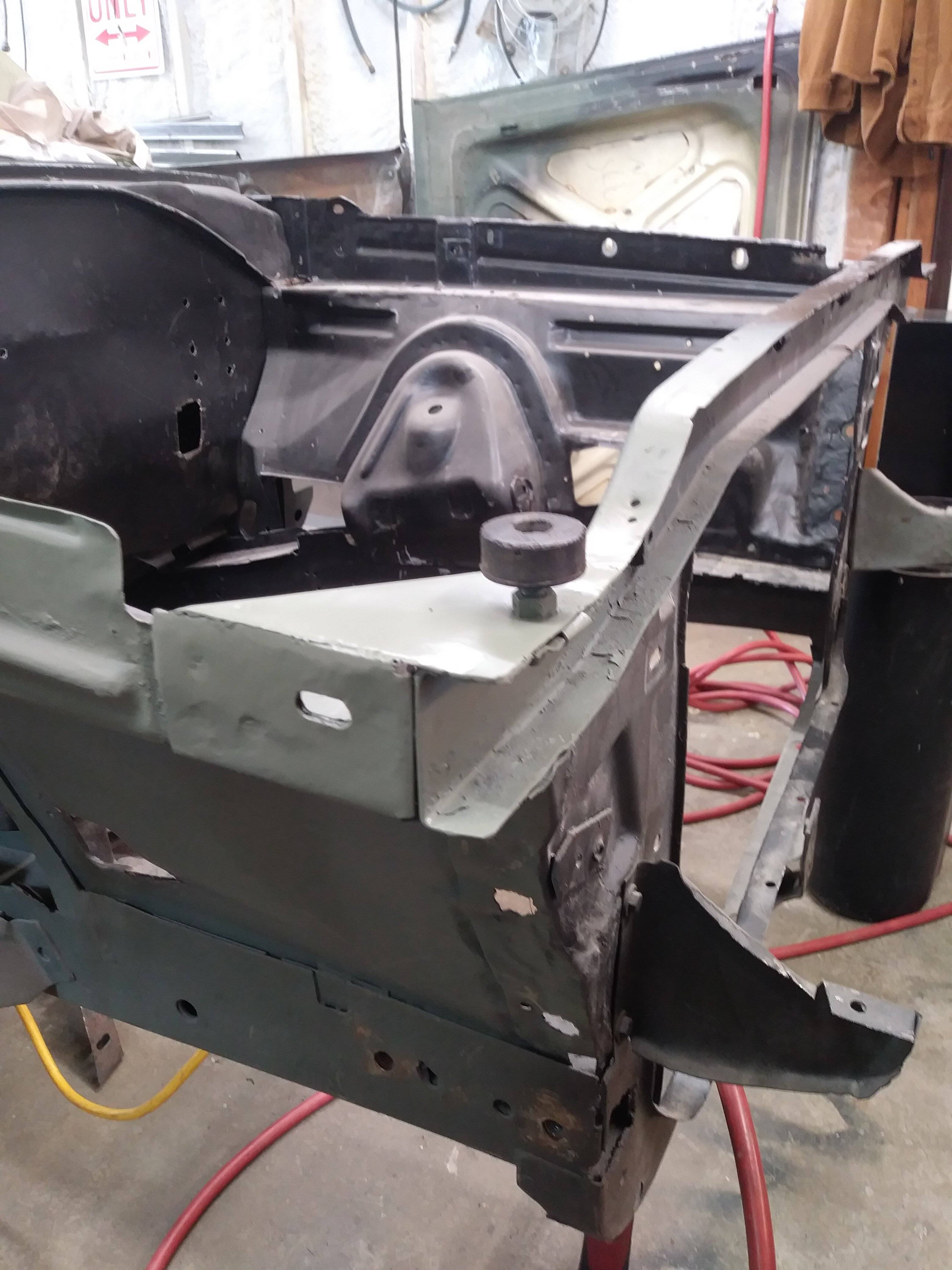

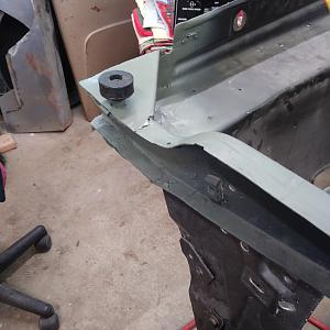

hood bumper stop mount fabrication.
left side extension finished shape

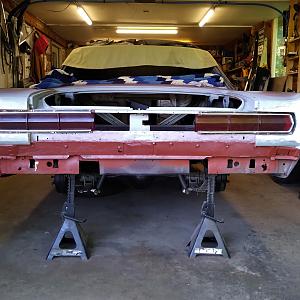

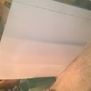

rear face fabrication final with and without rear bumper.

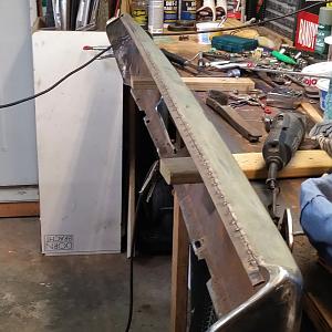

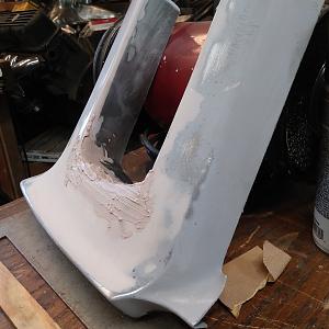

adding 1/2" to the top front of the bumper edge.

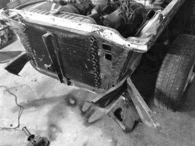

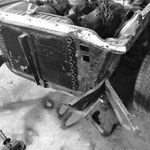

the car during dissassembly of the front end

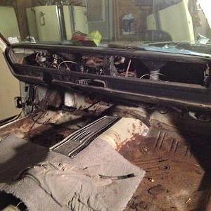

Audi dash initial mock up of bare shell

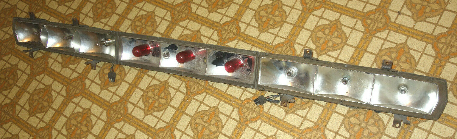

1966 thunderbird tail lights that are on the Express. Reverse light detail.

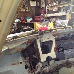

Bare dash area during decision making about steering and brake pedal mounting & removal of stock heater assembly.

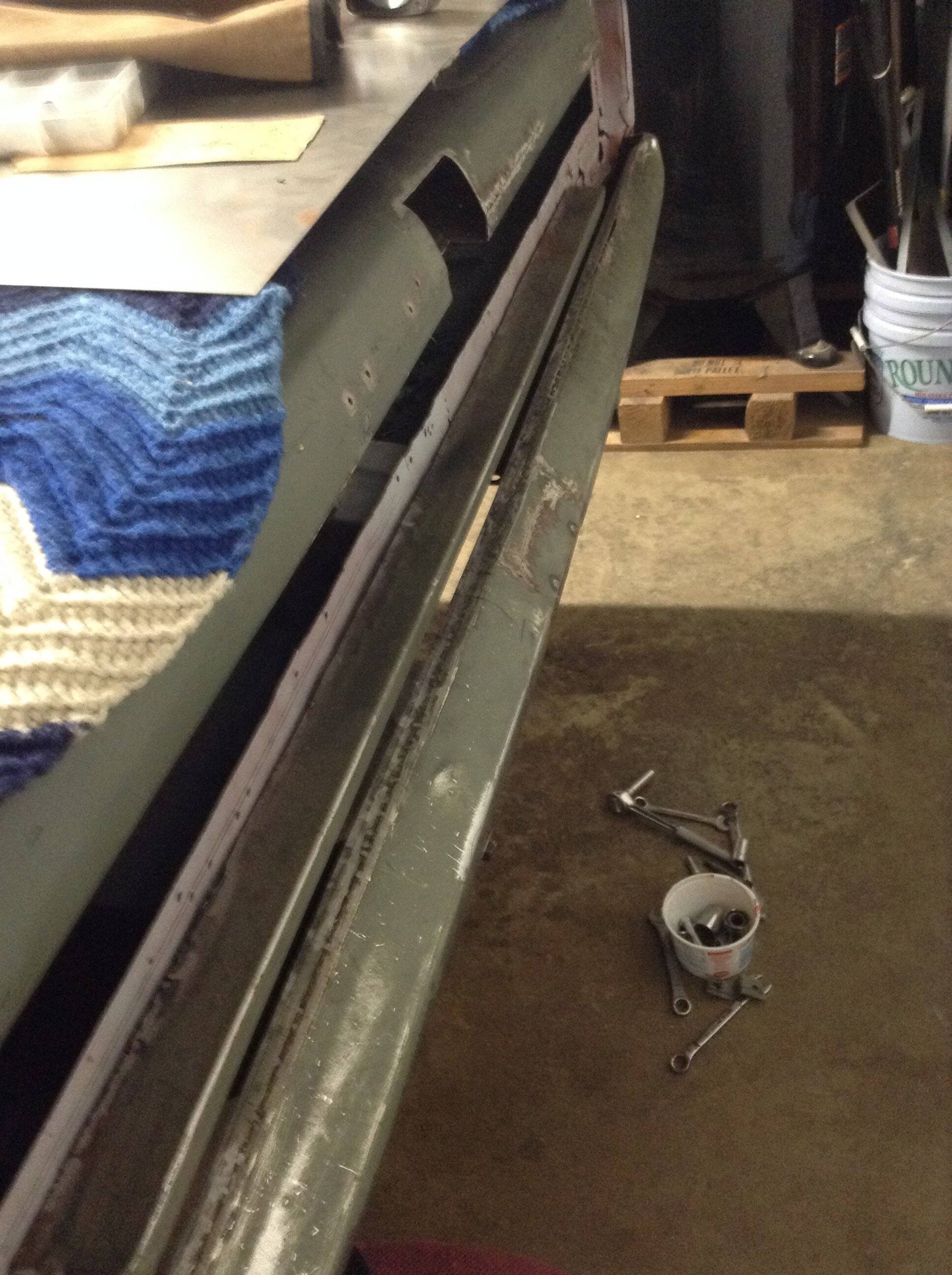

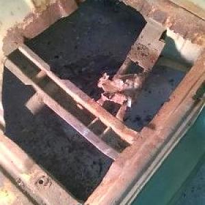

open right front floor while replacing panel

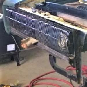

right side half of 66 Charger headlights and grill mocked up and the side view of the front fender nose in final swept back form.
leaf spring relocation fabrication efforts in primer

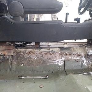

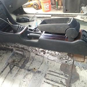

Center console during fabrication of shift lever mount and center pull E brake mounting.

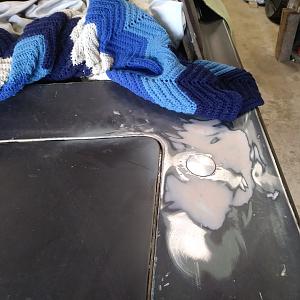

left and right pop up gas caps

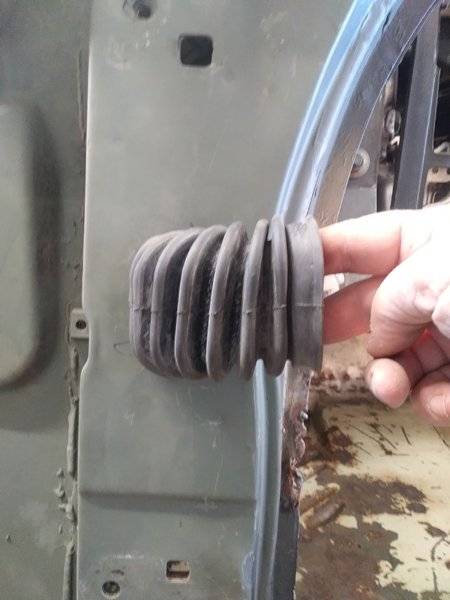

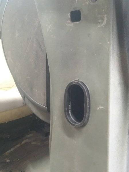

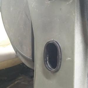

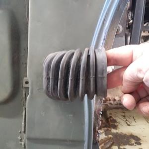

Audi door wiring passthrough gasket system mounted on 67 Coronet door and A pillar

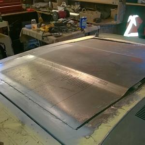

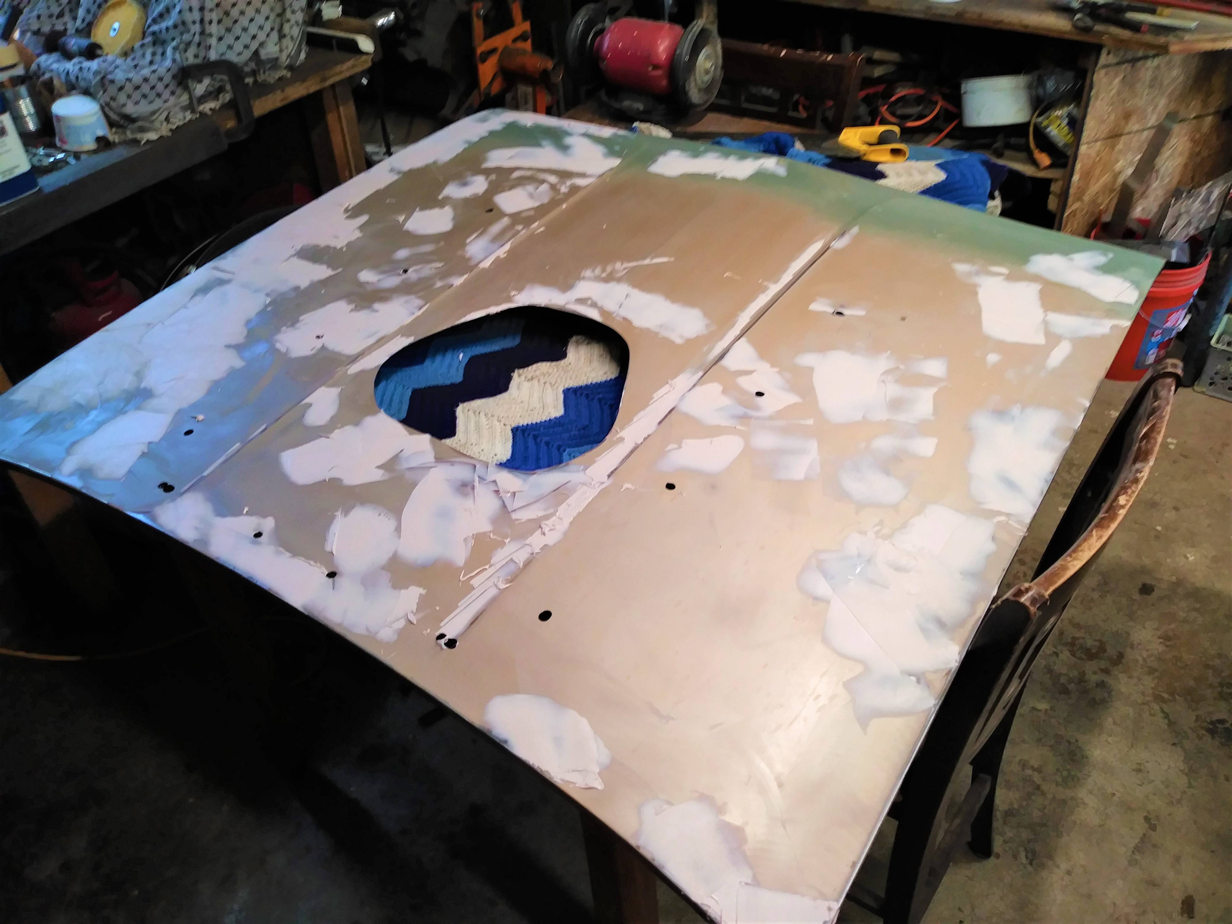

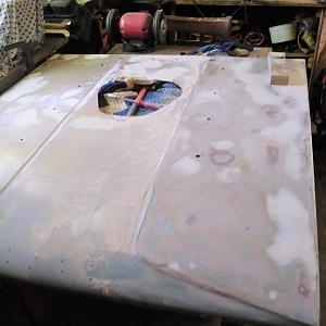

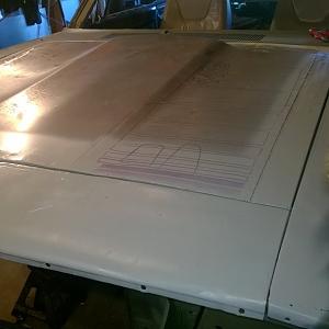

Mock up after fabrication of two piece hood treatment for flip front hood and RR style reverse scoop.

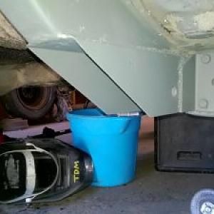

Rear relocated spring perch

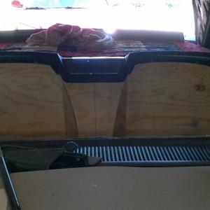

close out mock up of roadster panel area behind front bucket seats.
440 again...

Really nice Ghost, I like how you integrated the modern Challenger reverse light into the taillights.
Thanks but those are 1966 Thunderbird tail lights and the reverse is built in. It would have a chrome bezel around it on the Ford. Behind the clear section are two small clear bulbs and three larger bulbs which have red plastic covers over them so when you hit the brakes or have the parking lights on they light up the clear section in red so it appears to be red all the way across. Unless you are in reverse.
Your are making it come back to life for sure. Know their is hours of work involved with restoring these old car's. So keep the pic's coming and showing the progress. :thumbsup:
I considered LED's for this set up but these lights are really bright after dark. You cant miss the back end when they are on ...at all. There's 9 lights in that thing. Big 'ole 1157's. Plus the inside of the lenses are patterned.
