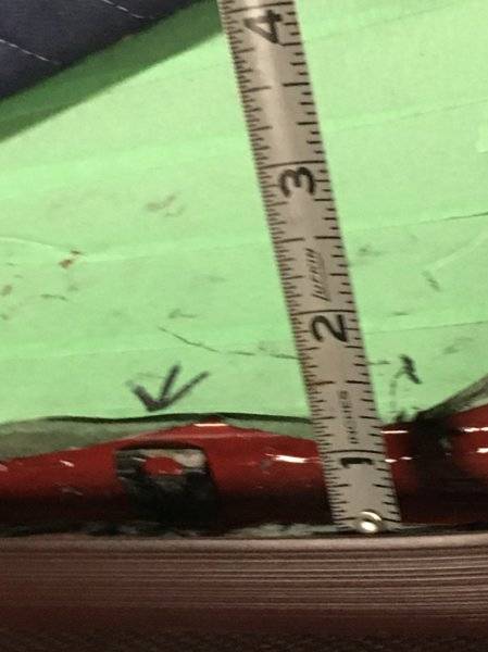

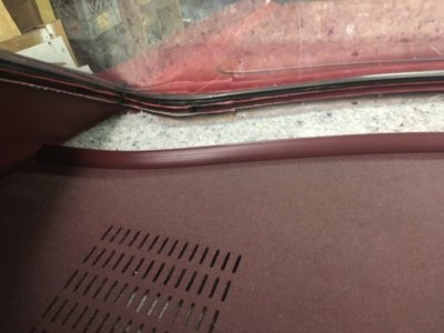

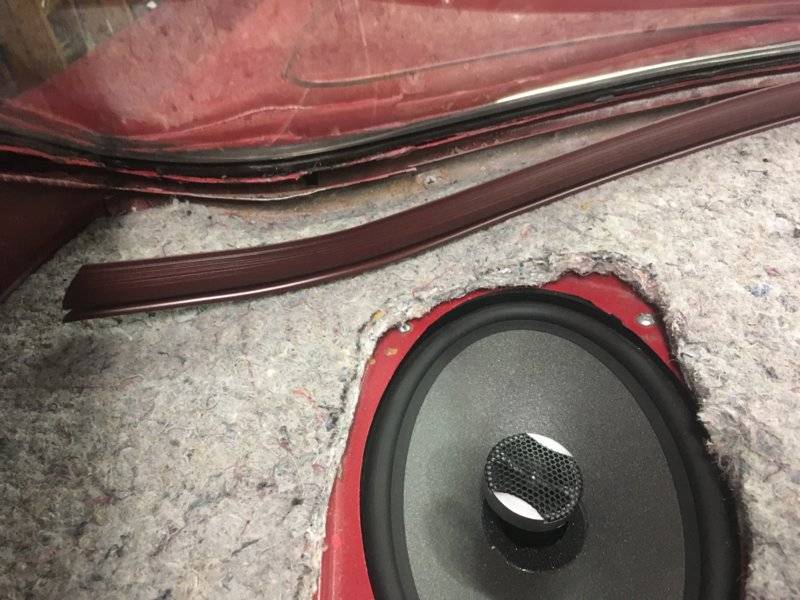

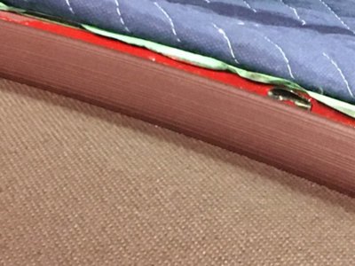

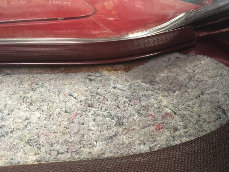

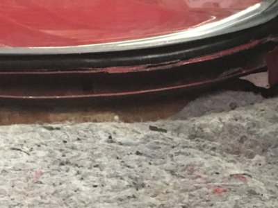

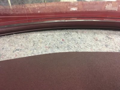

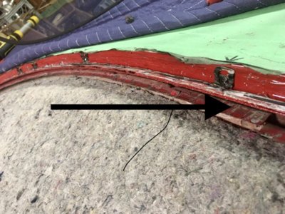

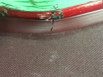

I’ve been meaning to do a restoration post w/photos sometime on my car. But now I’m looking for some answers. At this point the rear window was taken out to speed up the installation of new package tray and the associated plastic trim. I bought the new 4 piece set (there is a 6 piece set for Coronet’s). The 4 piece had a bottom trim that seems to stick up 1/2” while the side pieces are even with the pinch weld. I tried getting this trim & tray installed with the window in but no luck there. Here are 5 photos while the window is still in and 3 more with window out. The arrow points to the channel that was widened to except the trim (hopefully it doesn’t go below that channel, that wouldn’t make sense). What are your thoughts. I look at a few resto thread but didn’t find an answer.

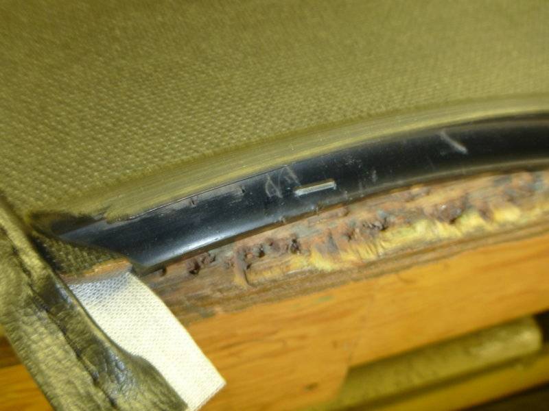

I don't know why there would be 4 or 6 pieces. In my 69 RR which is the same as yours, there are only TWO pieces - the long upper which wraps the pinch weld from bottom corner up and over to the other bottom corner. The bottom trim goes on the hardboard package shelf and slips in and butts against the rear window glass. Some models - I'm not sure which - have lower corner pieces but the RR didn't have them. The repro lower trim is made of "plastic" and is quite rigid compared to the original trim which was much more flexible. If you're using reproduction trim that's probably the problem.
And I sure wouldn't be putting this in before the glass.
Just so we're clear ... you removed the rear window to replace the "metal" package tray or the hardboard package tray ?

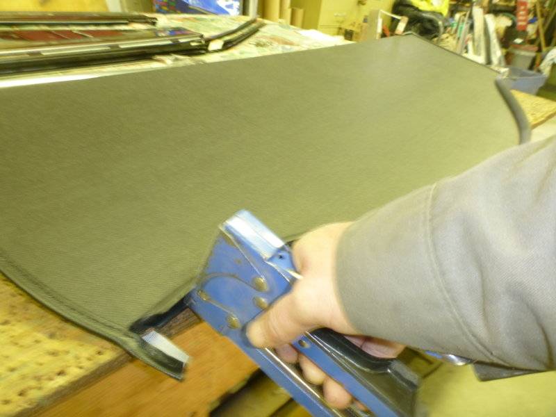

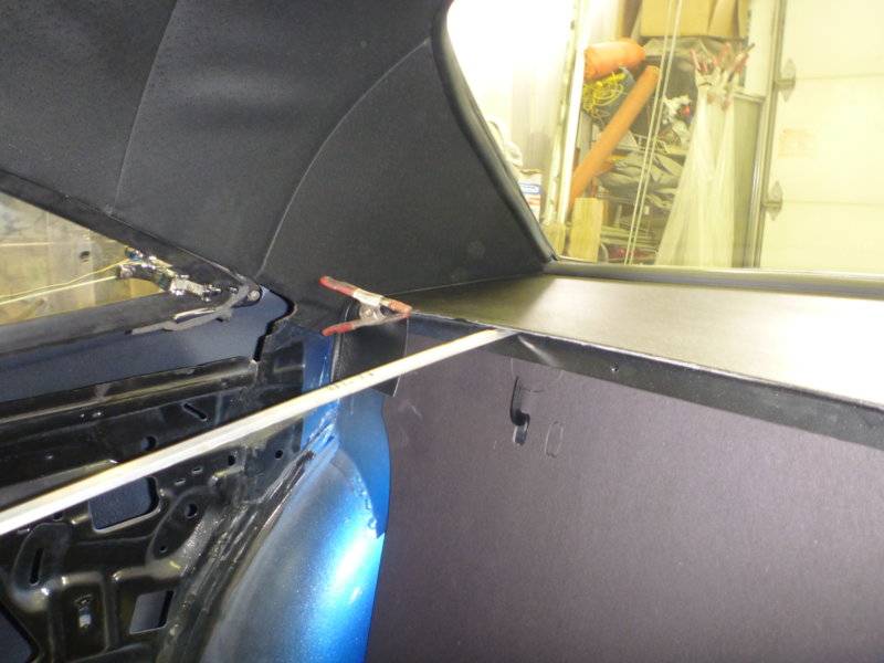

Plymouth is easy, staple that thing to the tray cover and while sliding the entire thing back as a unit lift it up with a yard stick underneath so the trim sits up on top of the pinch weld. Went through this on my Bee, that has always had a plymouth trim piece in the back as long as I can remember. Dodge you need to install the lower plastic trim BEFORE the glass goes in as it clips ONTO the pinch weld prior to the butyl strip install, as per the FSM.

You’re right Staton, it’s reproduction and it’s very stiff.

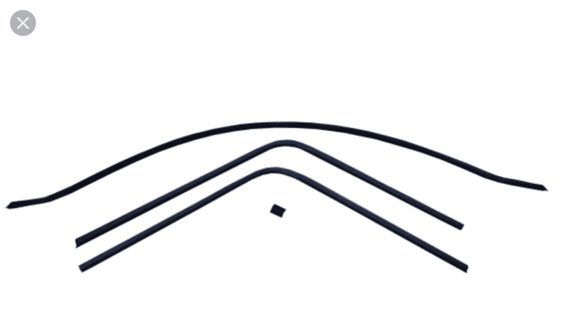

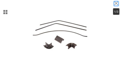

Here’s photos of the 4 & 6 piece repo stuff. And the tray is hardboard. I actually cut stress relief “v”s on the sharp curves. Anticipating problems because of the stiffness. Those 2 areas were bowed.

I tried to slip the package tray & plastic trim in, but to no avail. I didn’t staple the trim (nice tip!). I tried lifting the tray with my hand. Even after the window was out I used a 4x4 in the middle and a 1x1 on the sides to slip it in. And that was after widening the channel it slips into.
So I thinking out loud now and this tray trim is so stiff that maybe a heat gun could be used to reshape/loosen it up. Of course it has turned into more difficult than what it should be. I did read the fsm, I bought some 3/8” butyl round window ribbon and even have some butyl primer ordered. Thanks for your input.
Got mine from Laysons. Looks like the OP's ... crappy repro.
I forget the manufacturer but I recently purchased off e-bay.
Well it looks like it’s supposed to curl up towards the roof. I’ll have to see how that will work out.
No, it doesn't curl up towards the roof.
Thanks for clearing that up and even though it seemed like a pita the tray & trim need to be installed after the window is in. Well, what the hell, I taught myself how to remove a rear window. I’m going to a big Indianapolis Mopar swap this weekend and I’ll see if there is a more pliable piece.
