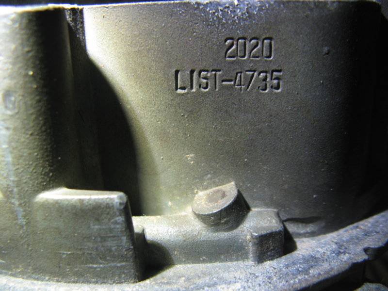

Never looked into 4 speed carbs as mine were both Autos. Got a date coded 72 440 N-96 Holley Carb for my 72 RR/GTX. Anyway I know the 4137 is correct for Auto/Air Grabber for sure as I have a low mileage N-96 carb from a 71 383 Hp Air grabber someone modded a bit... I got a standard 71 holley to convert back the mods...
I guess the book could be wrong too..

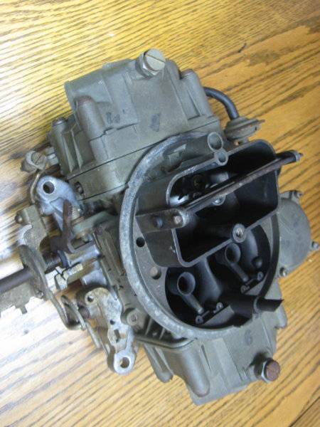

you have a 6152 ? or 51 (IIRC)
that might be harder to find then a 6193!

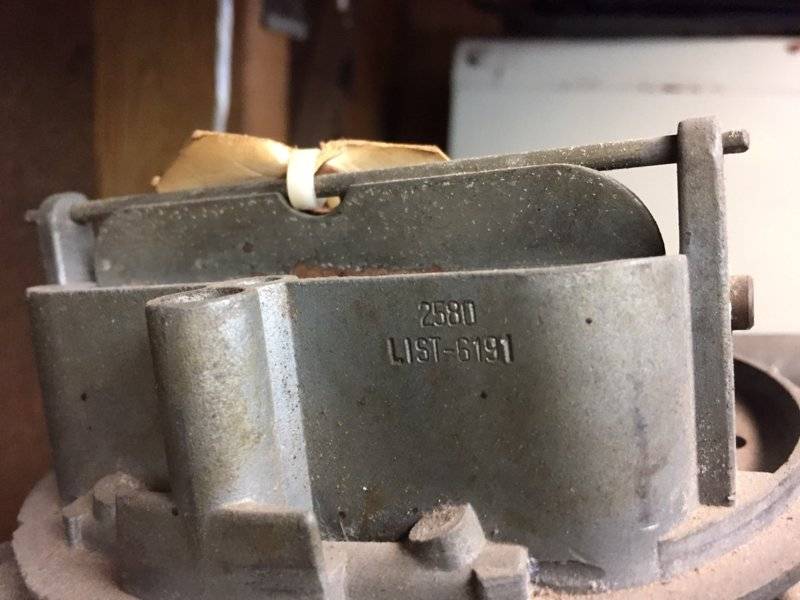

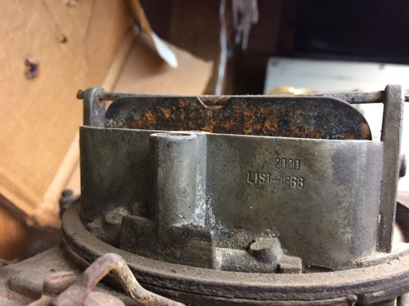

I have these two on the shelf and a NOS 6193 in a box somewhere

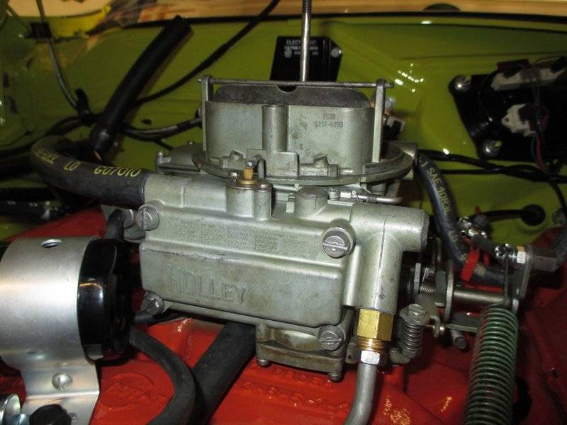

OK my 71 383 4 speed w/Ram Charger carburetor: 6193
