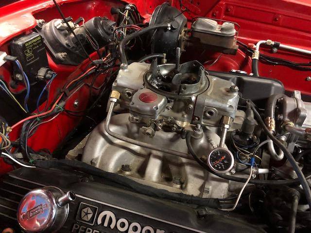

Just a thought , but check your fuel pressure at idle and were its starting to miss fire. You should have at least 8lbs or a hair more under load. Idle at least 5
No offense meant but mine idles around 3 1/2 to 4 psi but it jumps right as soon as I crack the throttle.
I hear you , :thumbsup: 4 to 5 , I think is fine prob my cheap gauge lol .
Then the jump at throttle hit under load should for sure show a problem or not with fuel , just what the Op was describing made me think of a dying pump.
Possible to plumb in a gauge he can see and take it for a short spin.
