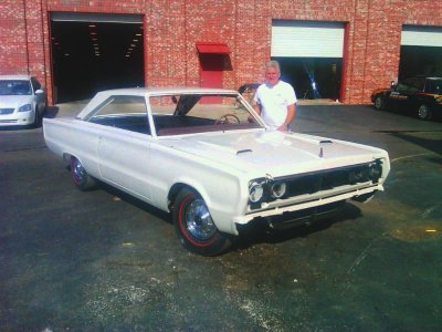

Here is a picture from today. I sanded and buffed it and drove it outside. The other picture is from March.

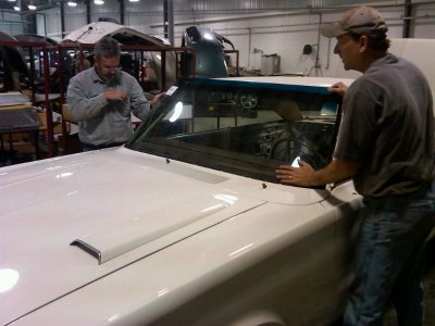

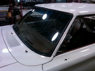

Got the headliner and windshield installed

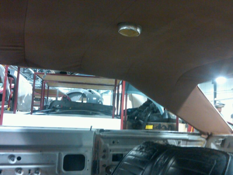

Headliner. Some wrinkles but they should fall out, I hope.
