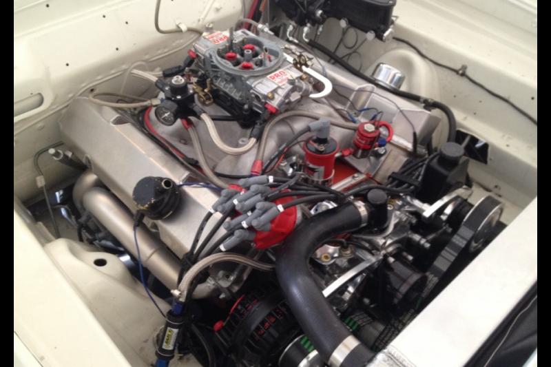

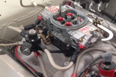

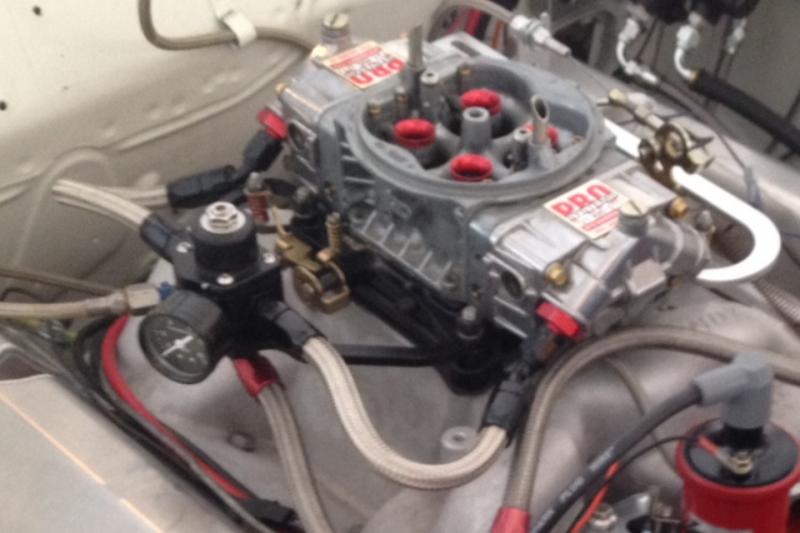

Pro Systems built a 1200 cfm dominator for my hemi. It's based off an 1150. From what I've seen, you need a very serious combo to utilize the bigger 1250+ cfm carbs on a street/strip type build (you didn't mention the application?). The throttle plates and venturi are so large that it causes some low speed issues.
I'd call Patrick at Pro Systems and let him set you up w/ something. He's done 2 for me and I've been very happy w/ them.

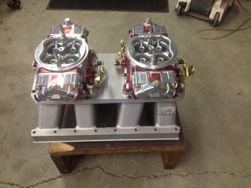

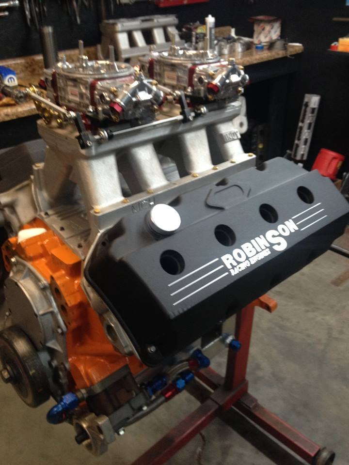

I have a 572 Hemi going on the Dyno this coming week that has a Indy Tunnleram and a pair of Quick fuel 4150 style carbs I'll let you know how it preforms

For what it's worth my 572 has been 9.02@151 with a pair of Pro-Systems 750's. Been 9.11@149 (with tire spin) with a pair of box stock Eddy 750's. Both on a Indy cross ram.

Well my buddy Sam found a good combination of a carburetor stroker Hemi he went with the Quick Fuel 1150 Dominator
