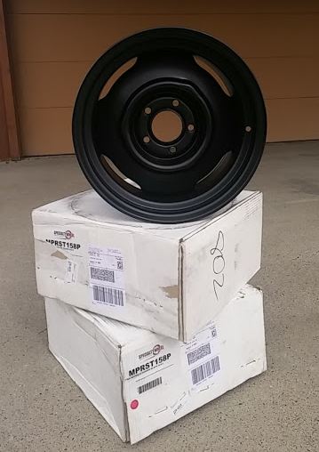

Wondering if anyone is running a 15 x 10 with 5" backspace and a 275 series tire on a 67 Coronet? Like these:
http://www.specialtywheel.com/produ...d-steel-large-bolt-pattern-powder-coated.html
I am currently running a 15 x 8 with 4.5" and a 255 series tire, looking under the car there is some clearance on the inside, but zilch at the outside.
I want to see if I can get a 275 series under there without a serious rub with the 5" backspace wheel.

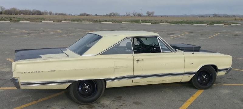

Concept Photoshop:

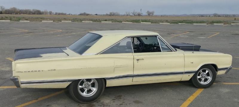

As is:
