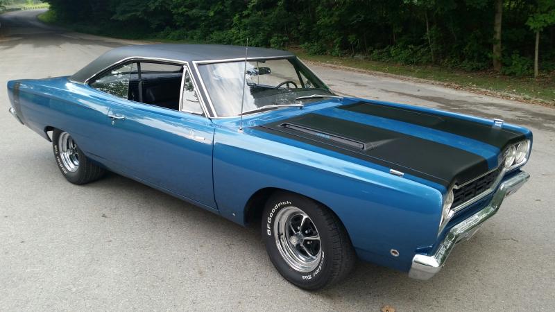

Here's a shot of mine with 7's in the front and 8's in the rear. 225/70 in front and 275/60 tires out back fill the wheelwells nicely.

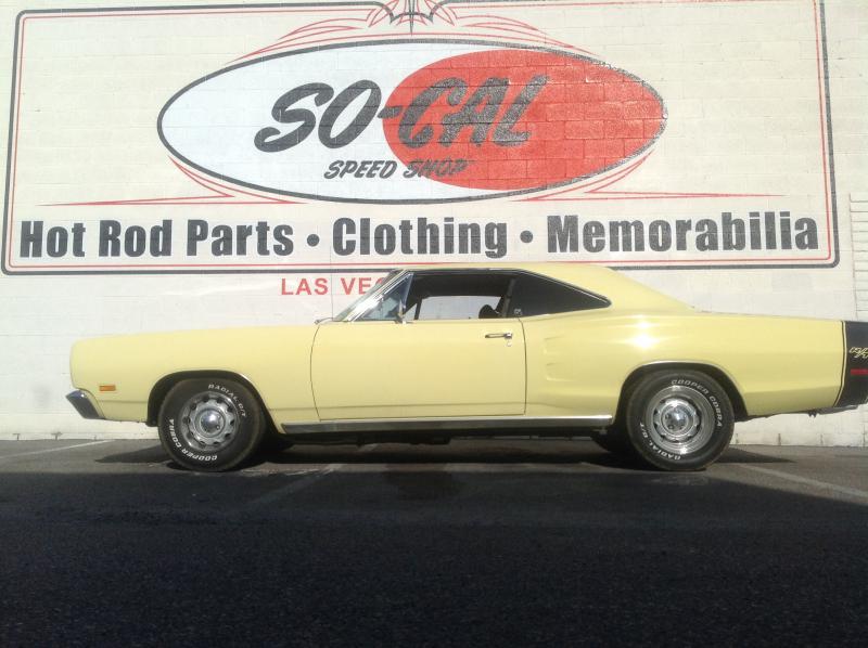

image.jpg225 70 14's front. 295 15 50's rear. Stance nice for me and feels good at triple digits. No drivability problems.
Ive got 7's in the front and 8's in the back. Dont have the car on hand for sizes but I love the way they look and how they give it a bit of rake.Car.jpg
