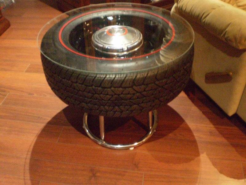

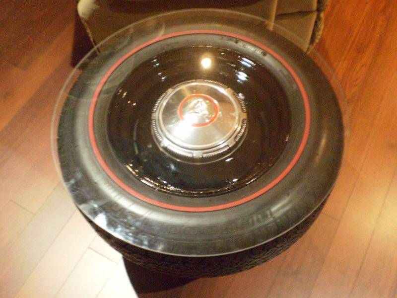

Coker Redlines? They are a Piece of $hit! I had same problem with mine requiring so much weight to balance. Then, at 4,000 miles, the plies separated on one of them. If you still want Redline look, try DiamondBacks. They run true on the rims and balanced with little or no weight. However, I did find a good use for Coker tire. Made a nice side table for my Mancave. They should NEVER be driven any faster than this!

Coker Redlines? They are Piece of $hit! I had same problem with mine requiring so much weight to balance. Then, at 4,000 miles, the plies separated on one of them. If you still want Redline look, try DiamondBacks. They run true on the rims and balanced with little or no weight. However, I did find a good use for Coker tire. Made a nice side table for my Mancave. They should NEVER be driven any faster than this!
Those are the ones.
