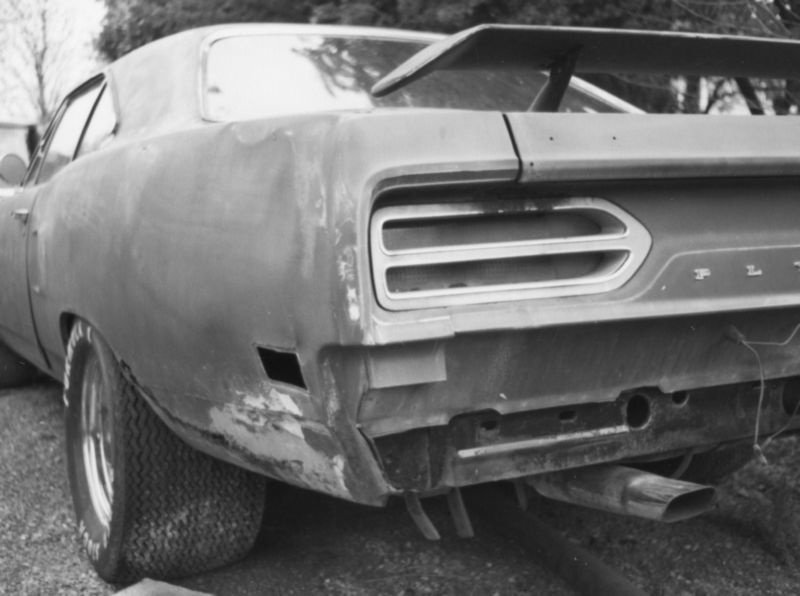

I did have 15 X 10 35 years ago, but no idea what the backspacing was. Those were Appliance 5 spoke wheels with N-50 Formula 1 tires. The outside rubber was almost touching the quarter while the inside would polish the paint on the inner rail on hard corners.
