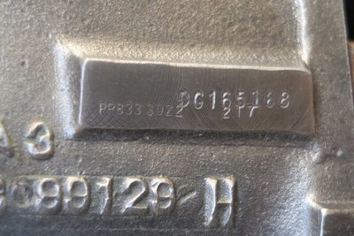

Hello,
I have fresh rebuild transmission with vin stamp: 0G165168
For 70 Charger R/T, Super Bee or Coronet R/T... maybe will someone find and reunite...
165036 is a WS car. 165240 is an XS car so that VIN is good for a Dodge model but not a Plymouth. Likely SPD of B24.
How do you know that everything in between those numbers are Dodge vehicles? Plymouths were also built at the St. Louis plant.
based on the SPD, model sequence and how VINs were assigned. Coronets (W) preceded Chargers (X) when sorting VINs. Belvederes (R) come before W. Since the VIN in question falls between two known models, both of which happen to have the same SPD and be Dodges, the tranny came from a W or X based car and not a Plymouth (R).
So if I give you an 18 spline trans number, you will be able to tell me what car it came out of? (I already know, but I want to see if this holds true)
Here's the number... 0G191536
Nope. Cant' help.
