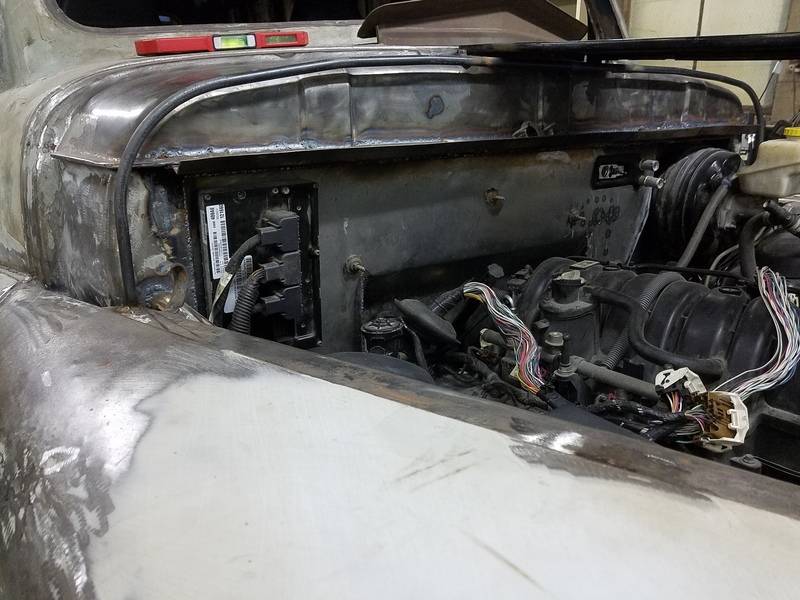

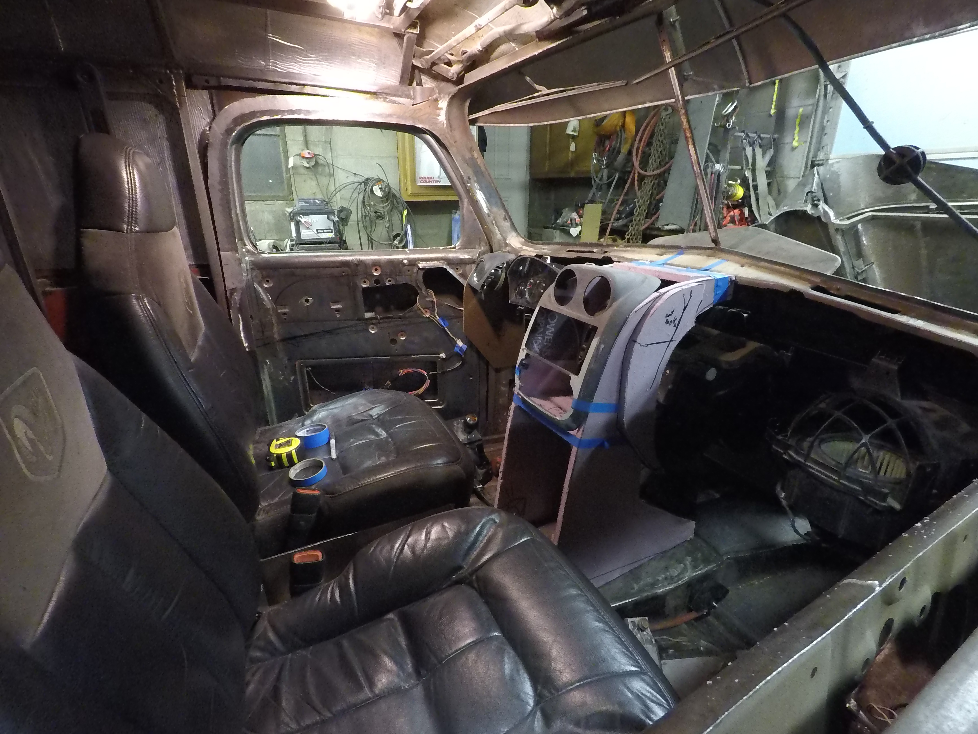

I finally began working on the new dash over the weekend. First thing I did was make a couple more mounts for the heater/air box so I wouldn't have to worry about it moving around or breaking the three wimpy little firewall bolts that were kind of holding it in place. With that solid, I removed all the wiring I had loosely placed where it needed to go for test purposes. Then I began to dream outloud with my hackzall and a sheet of 1/2" pink insulation board. When I made this video, I thought I had a pretty good shape, and I still do, but I know it's got some room for improvement. I've thought about throwing an LX center console in the panel van, but I'm thinking it would be a big waste of space since the LX chassis has a humongous trans hump it goes over and my floor is nearly flat. The other thing I really don't like is how close my knees are to the dash I laid out. I can't deal with how cramped it makes it feel. Rest assured, it'll all work out.
Here's a video of what I have so far:
And here's a quick picture of the dash:
And here's a quick picture of the lack of knee room:

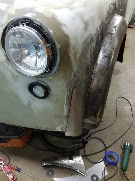

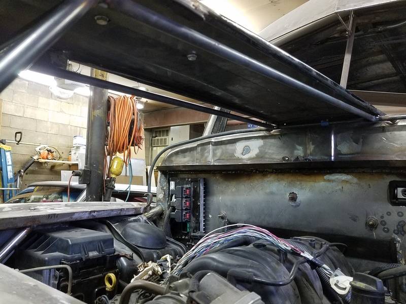

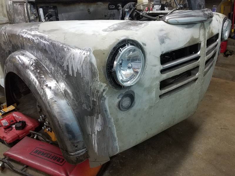

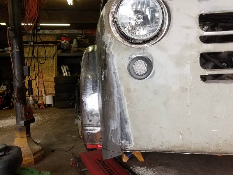

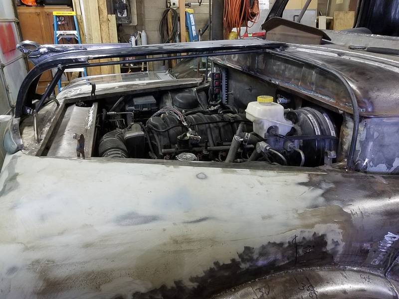

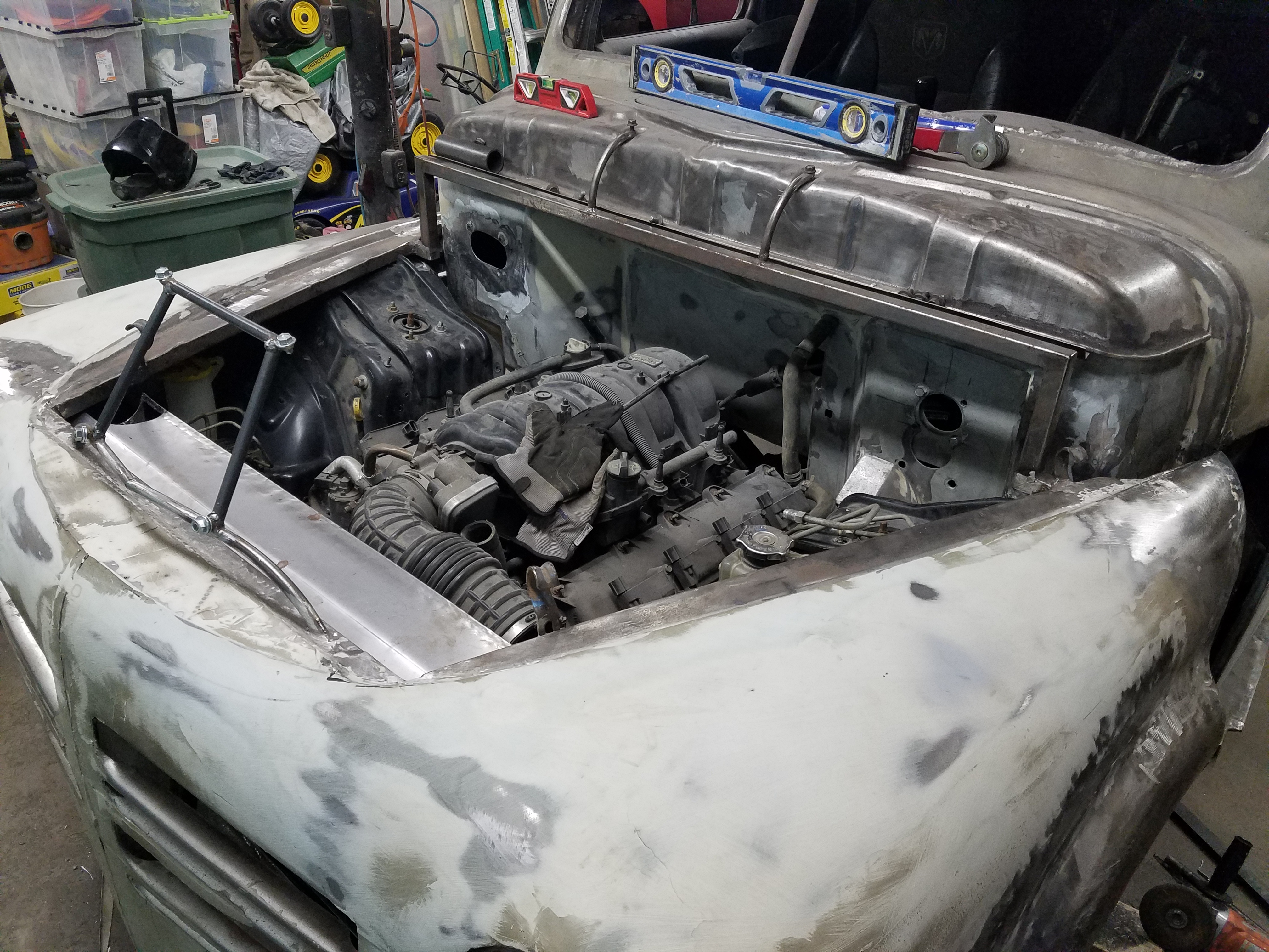

I finally replaced a brace I had originally made with square tubing with one I just made from 1/2" round-bar. I also started to correct an issue I created on the front corners of the nose of the truck. The front corners of the truck took on a new angle when I made the nose of the truck come to a more drastic point. So, I started by making a cardboard template and then made some more appropriate corners out of sheet metal. I still need to make the compound bottoms of the corners, but the truck already looks much better from the front. It is so satisfying to stand back and look a project that's finally taking on a good shape! I need to take more pictures, but you'll get the idea from the pictures I have.
Here's a shot of the brace I had originally made with square tubing, for reference.
Here are some shots of the new round-bar brace that spans the distance between the two fenders (connecting at the top rear corner of each fender).
Here a couple shots showing just how far "in" the bottom of the front corners were.
Here are a couple shots showing the new corner shape.

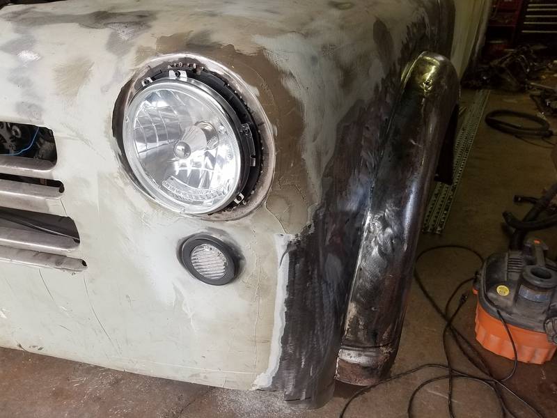

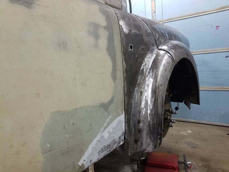

Made some progress on the front fenders this weekend. They're looking better than they ever have, but it's taking a ton of work. Still (obviously) have to do the bottom of the front corners. I'll remove the little fluted thing at the front of the fender I welded on as I work on the compounded corners. I may need to invest in a bag of sand and a teardrop neoprene hammer for those. Anyway, progress is good.
