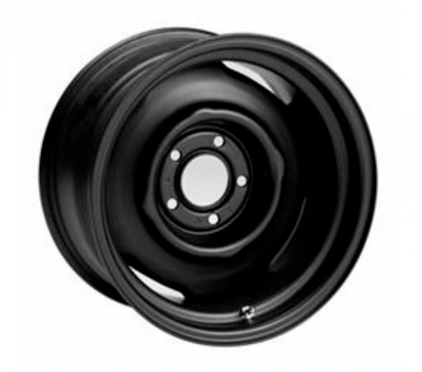

I've got to thank the khryslerkid for this thread. I've been looking for more correct wheels for a long time. If you hadn't started this thread I would have never known of Speedway Motors. Thanks! They look great!I know there has been discussions on these before but I need some clarifications.
My first pic is of the Vintiques 63 series wheel.
Isn't the design from the 70's and not the 60's ? I'm not too keen on the smoother look for my '62.
Second picture is what Speedway Motors offers. I'm thinking this is the design for '62-'65 Mopars.
I'm not worried about any dog dish cap fitment. I'm not useing them.
The Vintiques advertise a 2.875 center hole.
The Speedway Motors wheel has a 2.840 center hole. 2.840 is what my factory 14" wheels measure. I don't think the.035 difference will be a problem. My only concern is if a upgraded front disk hub would be to big for 2.840 center hole.
