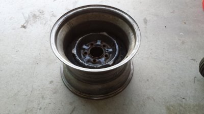

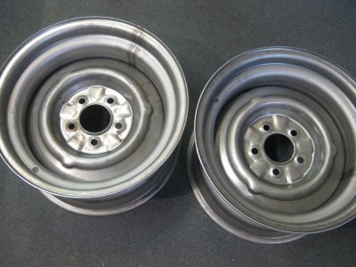

While we are on the subject, can someone identify this wheel. I found 4 of em and they are free. 4.5x5 bolt pattern, 15x6.5, chromed, large hub cap mounting nubs. I'm pretty sure they will work, maybe not correct though. I didn't measure the hub which may be the deciding factor.
I would get a set of the Speedway wheels if I were sure the larger dog dish caps would fit on them. Can someone confirm? A review on the Speedway site claimed dog dish caps didn't fit.
Confirm the register is 2 ¾" and if so grab them. Can't say I've seen them before. When you get a tire dismounted you'll find a bunch of info and a 5 digit sequence stamped between the beads.
4.25 seems to be the norm from what I've seen.
4.25 is farther away from the leaf springs than 4.5 but closer to the fender edge. Should give you 3/4" clearance there with a 60 series tire.

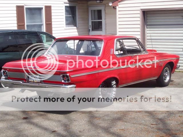

These pics are of the steel wheels I run now. They are actually 15 x 7" wheels as they fit better then my 15 x 8's. I run the Hoosier 30 x 9 radial slicks on these wheels and the car hooks great on them with a best 60 of 1.50 running 10.70's on just SS springs and the Mopar longer shocks. Ron

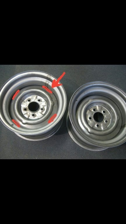

For them to be perfect they need the four openings in the center along the rim. But I'm willing to overlook that, for the fact they look more correct, for the '60's cars, than the Vintiques. The Vintiques have the 70's look.

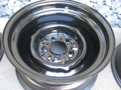

Forgot to say... yes I'm painting them. My car has a 1970s $99 incorrect white paint job. I'm in the process of doing a color change to 1964 Chrysler Formal Black. I shot the engine bay when the motor was out, so the wheels are next. I'm no pro, but I paint stuff with a spray gun myself.

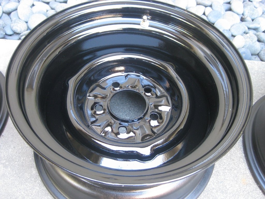

The Speedway Motors wheels are made by Wheel Smith (website with the same name). I got them all painted 1964 Chrysler Formal Black with new stems. I'm off to the tire shop for new shoes.

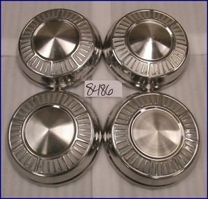

I know they are all over eBay, but I thought I'd ask if anyone has any dog dish' like pictured.
