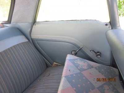

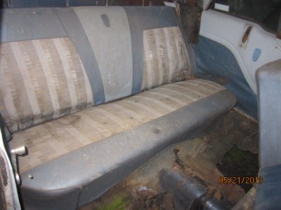

62 d 012.JPG62 d 013.JPG62 DART 012.JPG Here are the only pics I have, hope they help. 2 door and 4 are pretty much the same.
Thank you Tallhair for editing my post. Thanks to 65NUTCASE and khryslerkid as well. Still looking for the elusive 2d sedan though. Hardtop has the solid piece that goes along the entire top rail and 4dr utilizes the windlace. I need to see an image taken from the front seat looking back into the package tray with the quarter window visible. Then another angle from the back seat capturing the quarter window and pillar.

Not a sedan but maybe it will help...

Maybe you can search "for sale adds". A lot of fully restored vehicles will have detailed pictures of there interiors. We'll keep looking. There are members on here with post cars. Pm them as they probably just haven't seen your thread yet.
