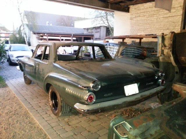

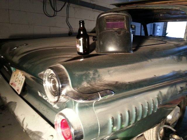

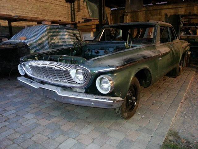

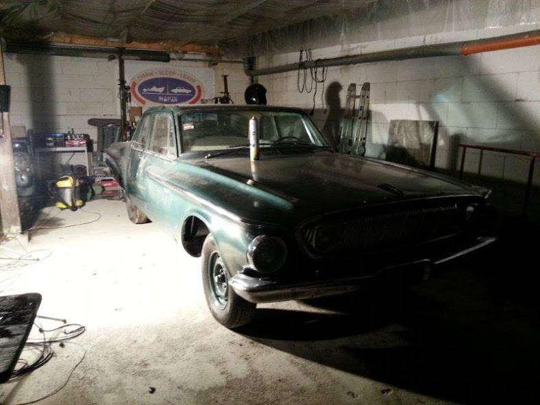

1962 Dart 2dr Sedan in Hamburg, Germany
No, not planning on putting a hot V8 in it.

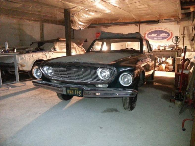

I have a 1964 Dart 383 833 project. That will be enough V8 for me.
There are just two of these 2-dr Sedans in Germany.

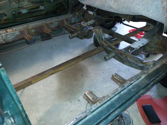

Got the Crossmember in. Next will be the floorboards.

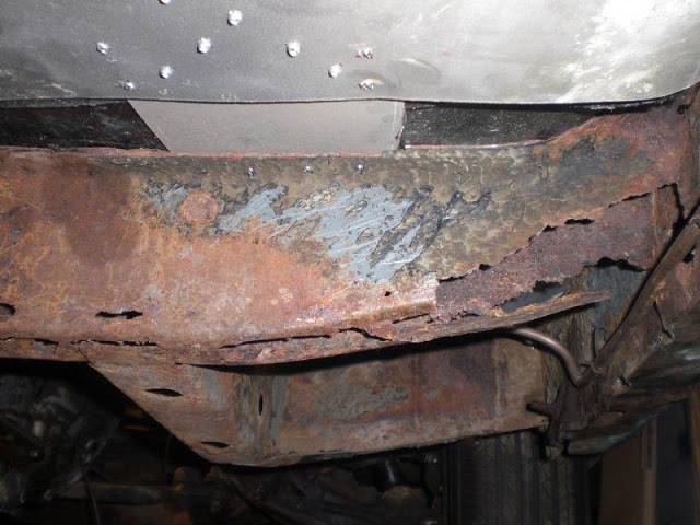

I did like mouses, but this is over now since they took so much of the structure off the car.
Next will be the floorboards. That will be no big deal, I hope

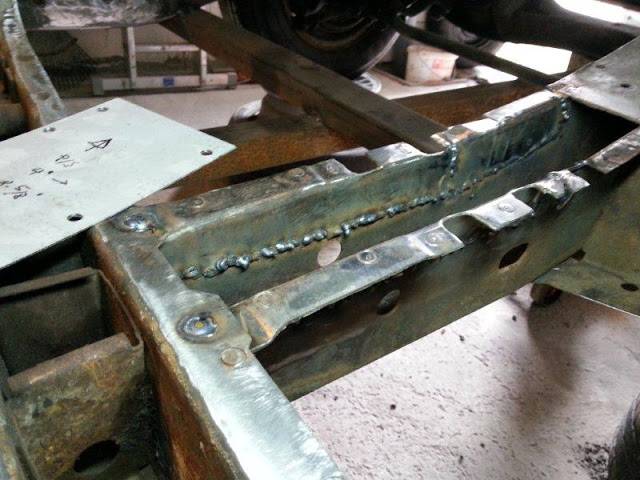

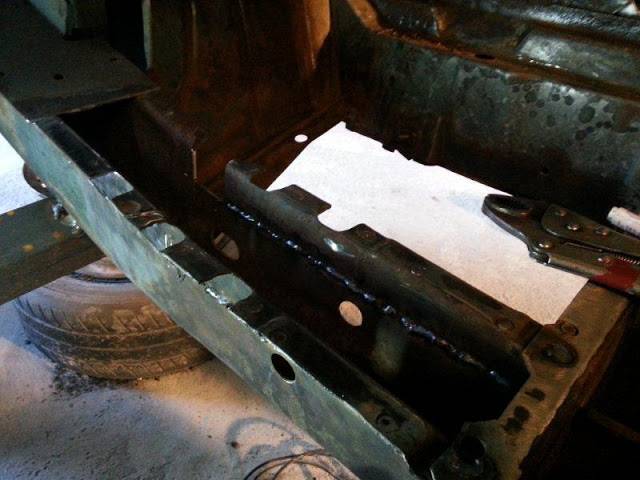

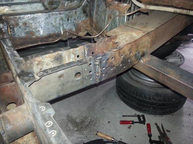

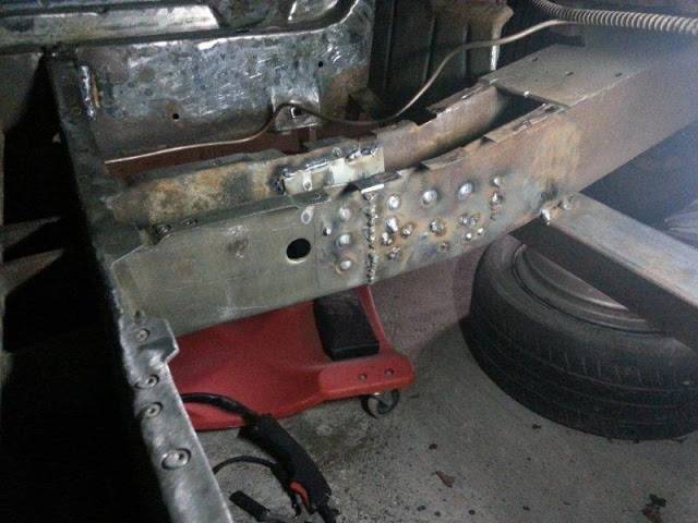

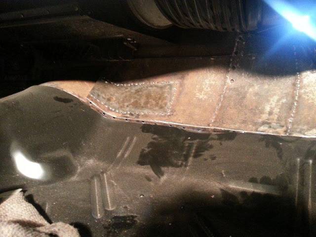

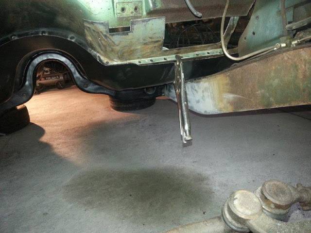

patching the driver side of the frame rail

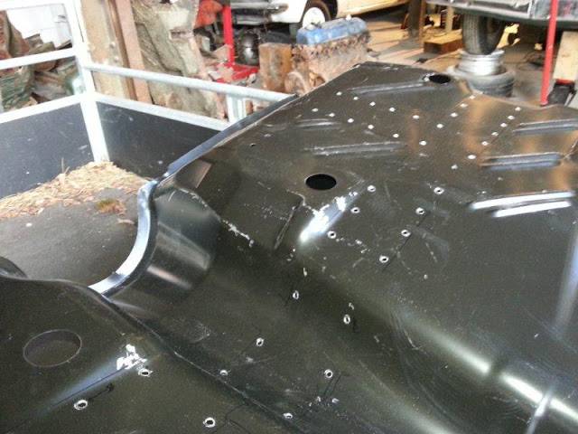

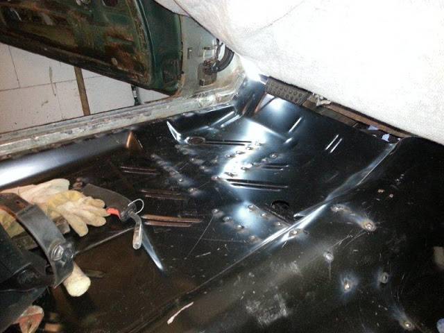

and a final look at the empty floor
preparing the board
and it is in. Beertime!!!
looks great. I don't drink beer, so you'll have to drink mine for me.

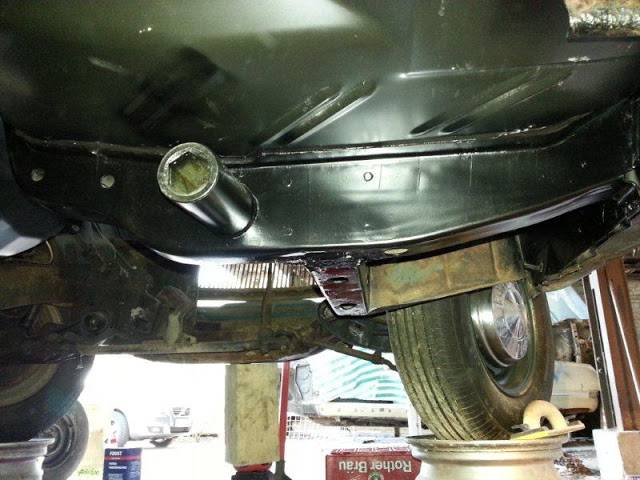

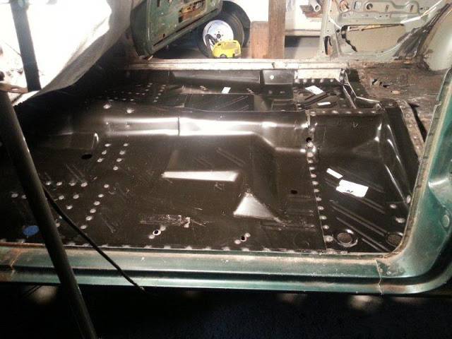

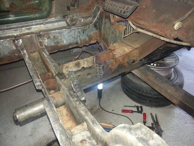

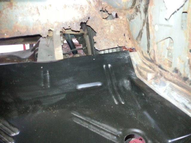

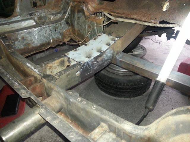

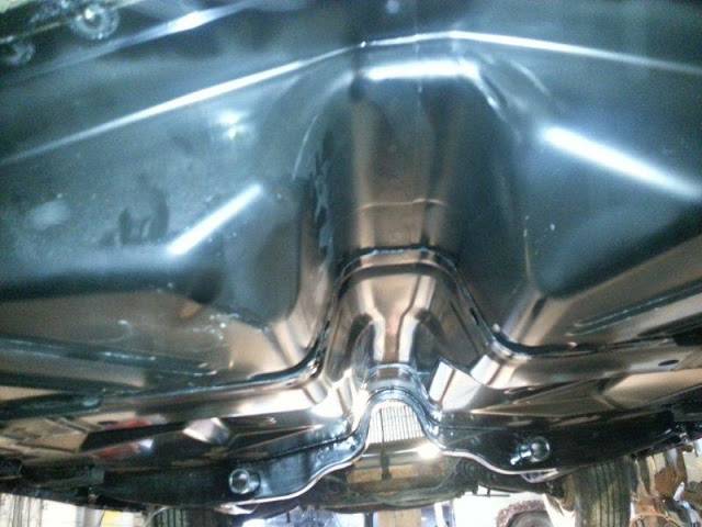

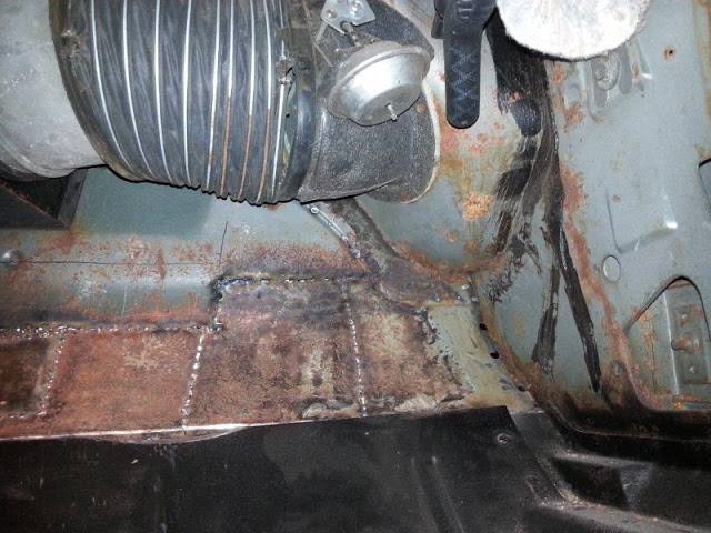

Finished the floorboards and patchwork at the framerails
But there is still a little gap to close between the floor and the rusty firewall
Next weekend should be end of metalwork.
Looking forward to the enginework!

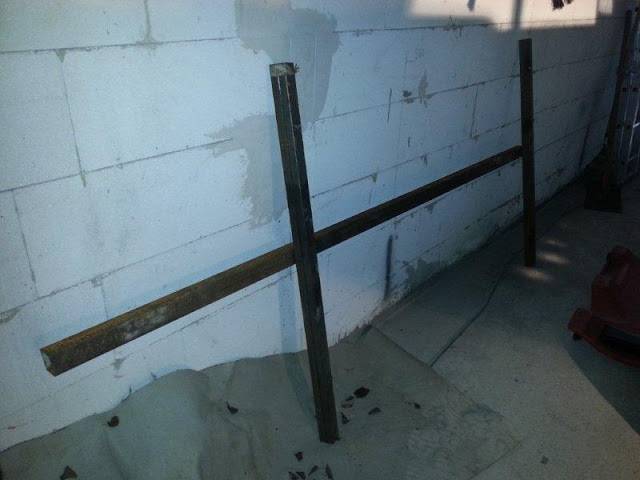

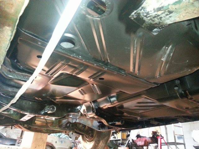

OK. Finally I could take the supporting frame off.
And I think the floor looks really solid now

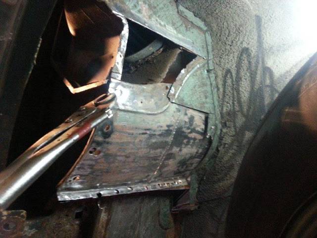

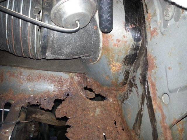

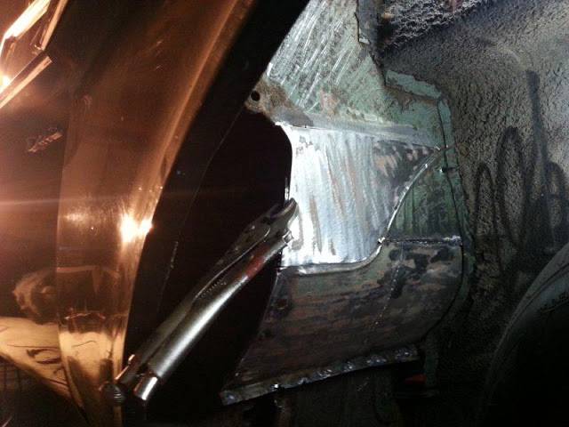

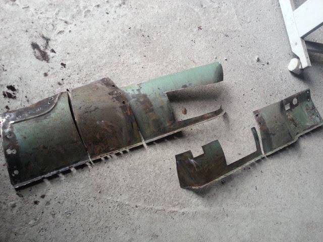

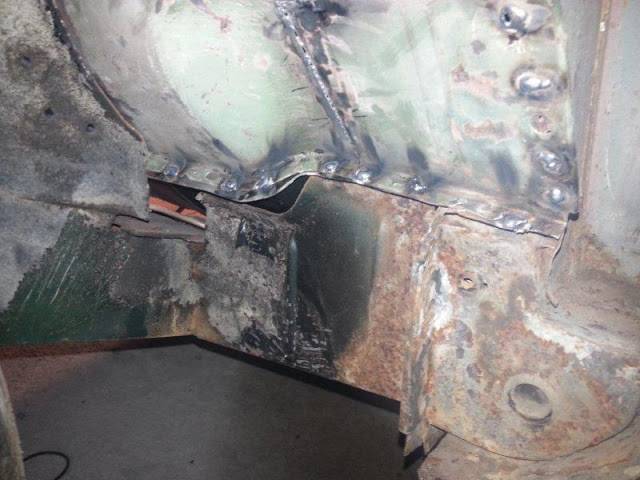

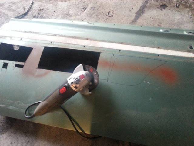

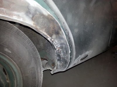

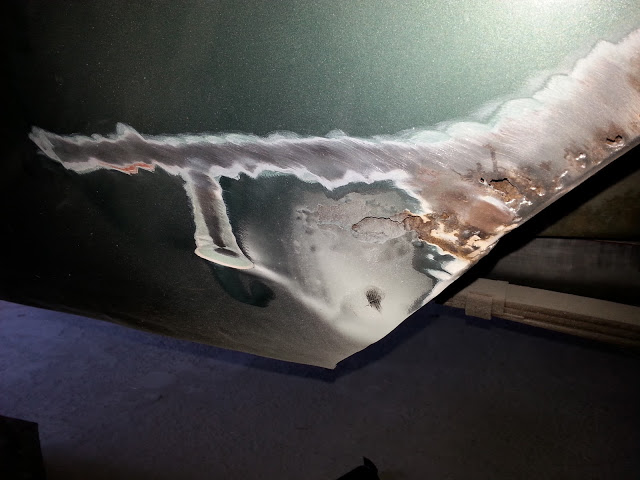

Did some bodywork at the framerails..

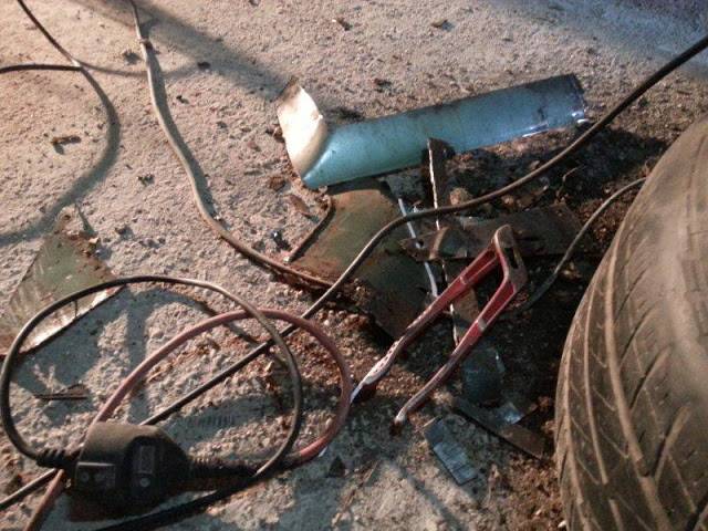

..and started working at the firewall. Too much air there.
Parts from Marcel's Fury

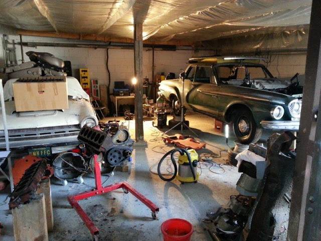

and a nice shot from my open-air-shop

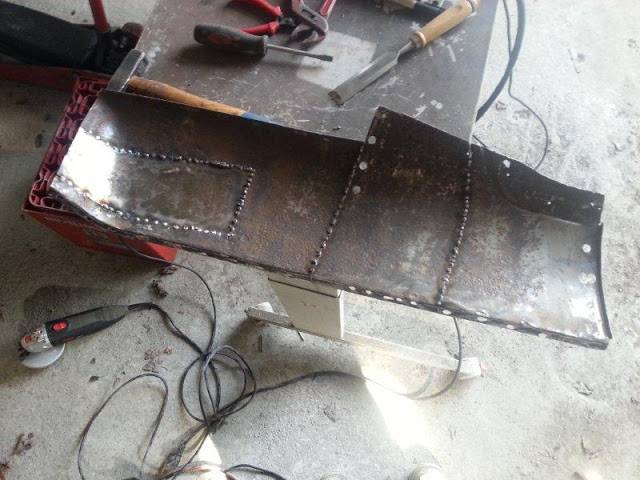

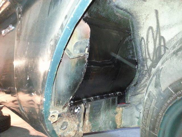

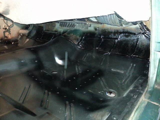

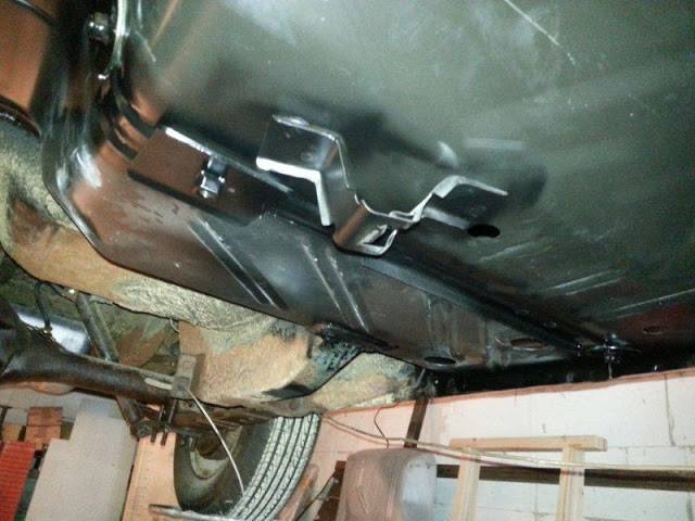

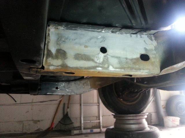

Patchwork
seam sealer and EP primer
Brake cable bracket and seatbelt hardware
And this is OK for now!

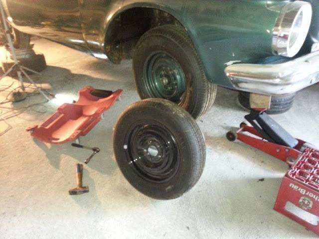

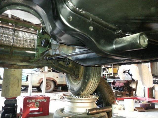

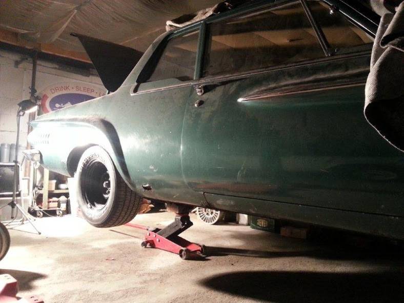

Pushing in the torsion bars..
.. changing the wheels to 4x15" and 8x14"
and getting it back to the ground

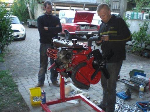

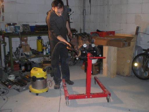

cleaning the engine parts
ready with the rear window
ready with the first few beers

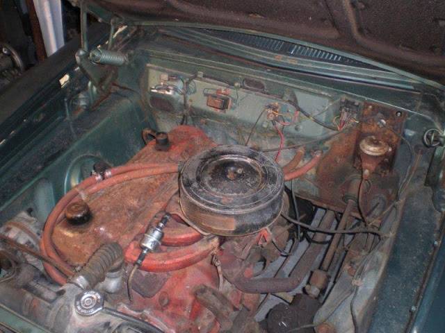

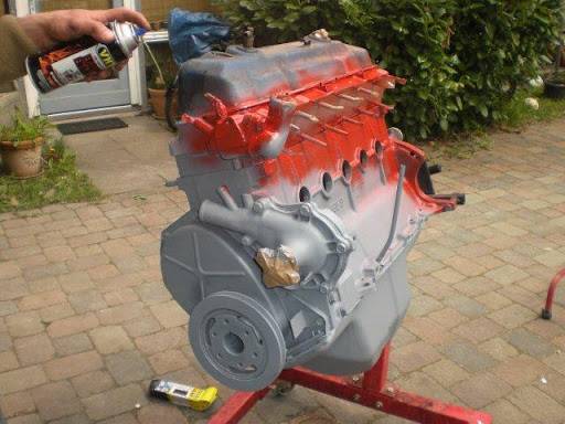

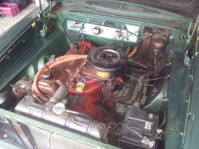

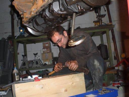

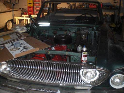

cleaning up the engine bay

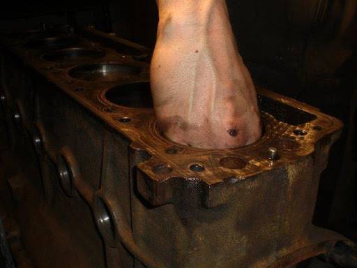

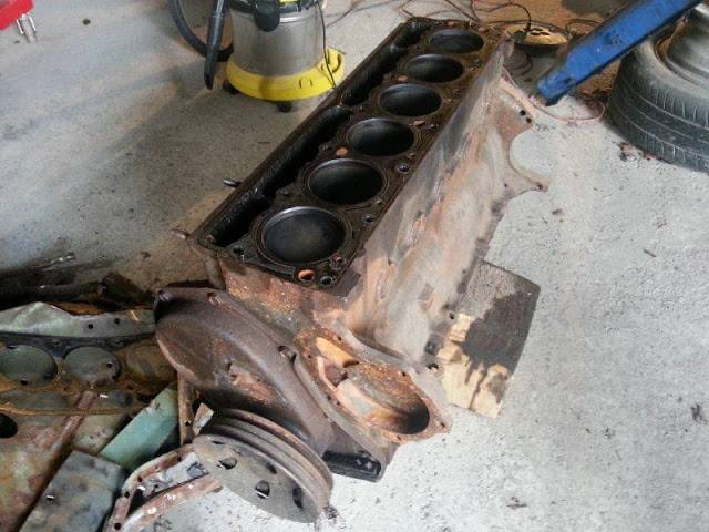

cleaning up the sixbanger shortblock

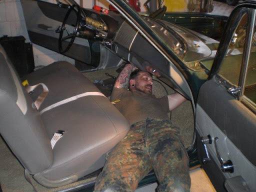

cleaning up the interior parts

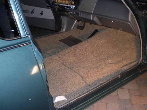

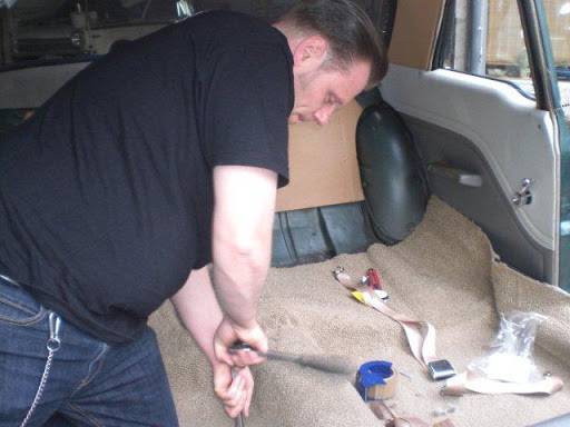

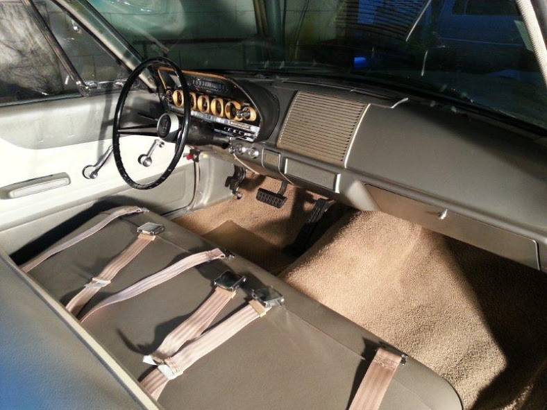

installing seatbelts and carpet
installing the rear bench. Felt good!
Postman from sixbanger view
Svensson from Postman view
finished carped

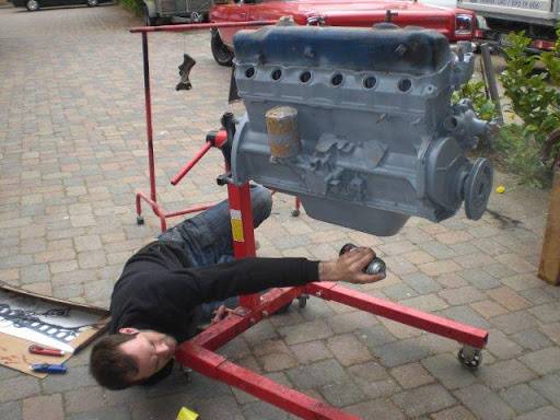

cleaning engineparts
installing front bench
installing engine dummy. In German dumm means stupid. Correct, Wedgy?
finishes interior also felt good

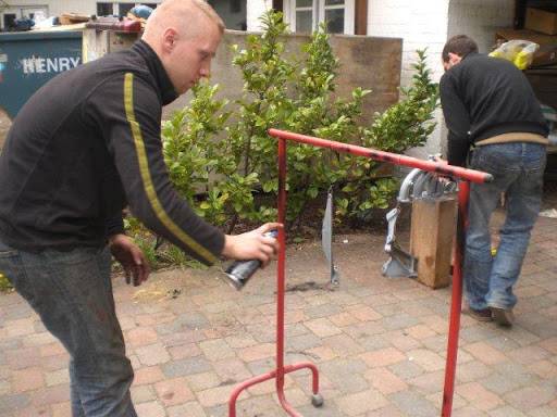

in the morning starting paintwork at the 225

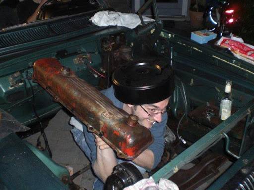

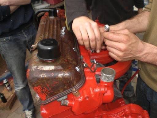

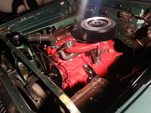

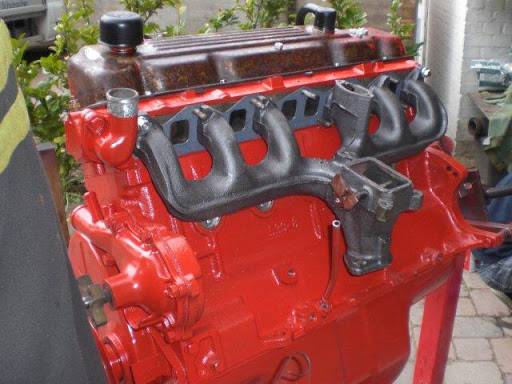

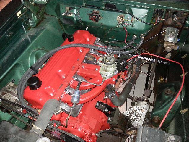

installing the exhaust manifold. Painted with POR15

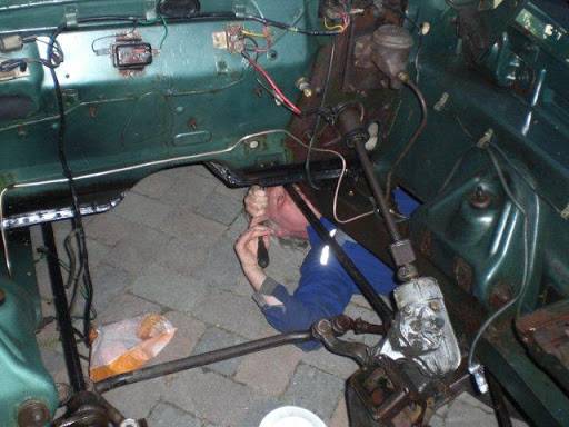

parking brake cable and throttle cable. In Germann trottel is an idiot. Am I right, Pille?
enough people working. We are having another beer
and in it is
not ready yet, but it went in fine and looks really fresh

The engine didn't want to start today. Ok. Plan for the day was exhaust, which we did.

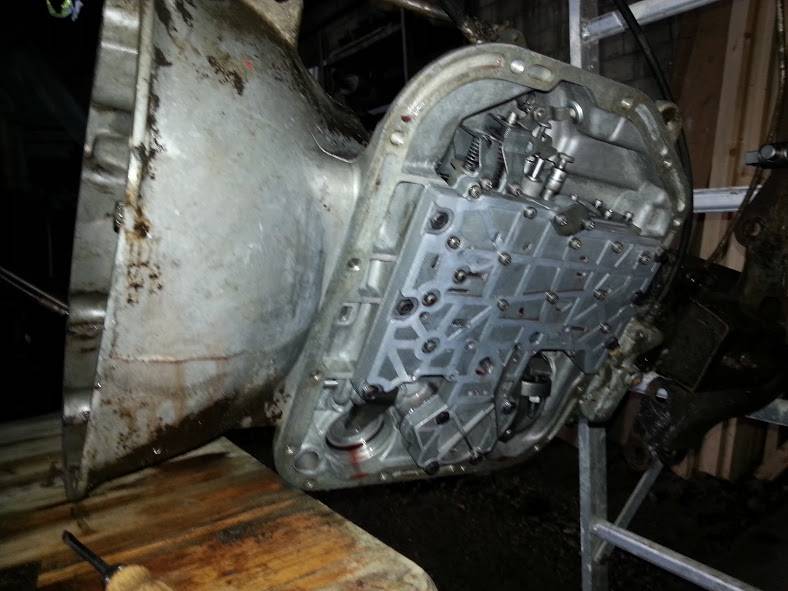

did a little cleaning to the 904

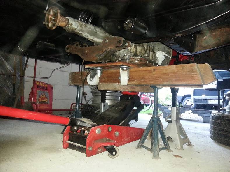

and put it in alone. No problem with the 904. It is lightweight

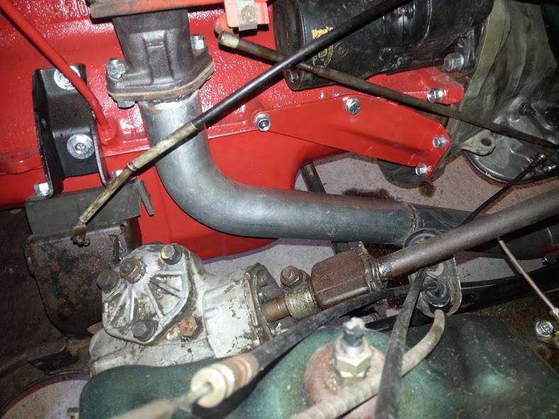

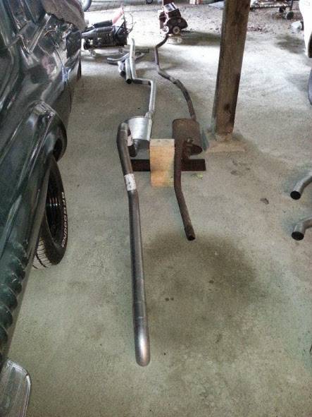

got me a B-body exhaust system from summit. The cheap one. After a little cutting and welding it went in.
I had enough tubes to do a comlete system for a single exhaust from exhaust manifold down to the turndown
I like these nice decals as nice details

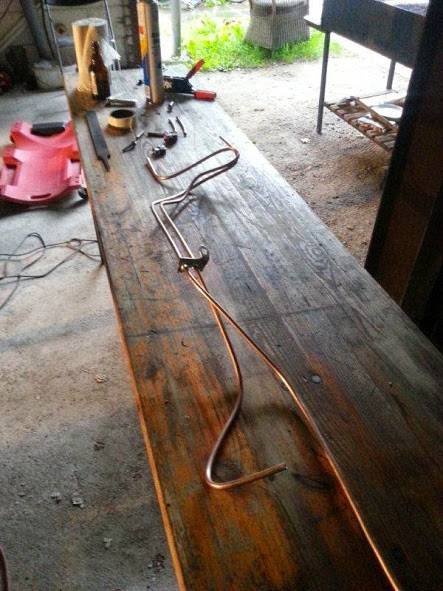

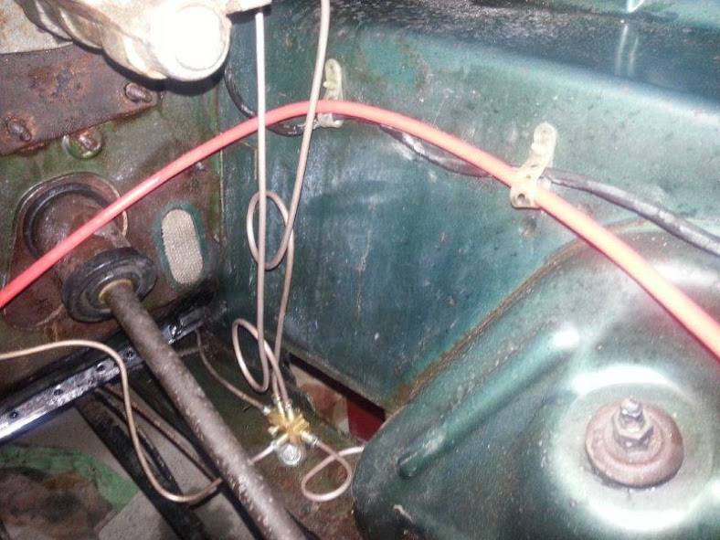

Transmission cooling tubes. Bending and trial fitting under the car really sucks

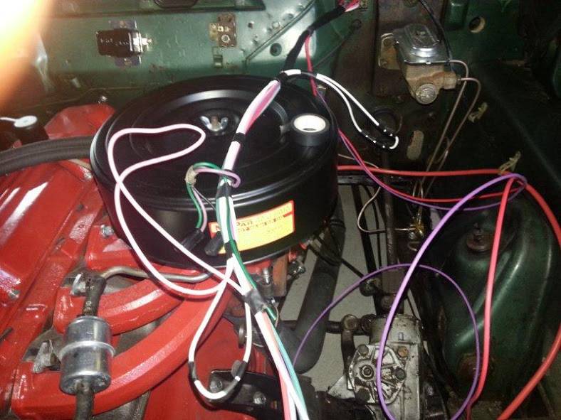

building a bracket for a nice oldschool battery

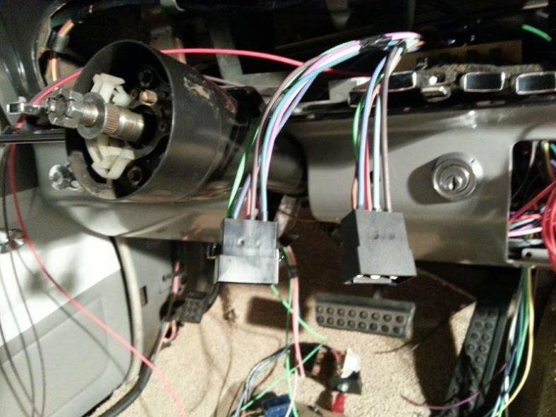

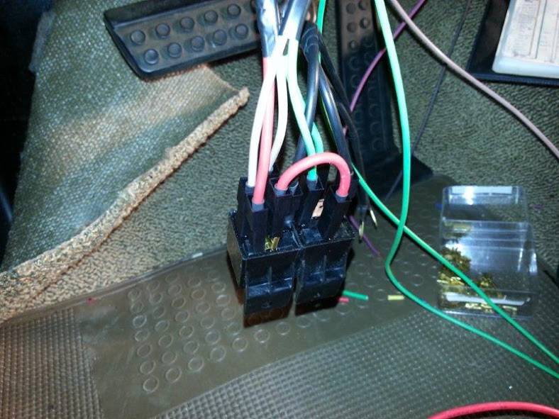

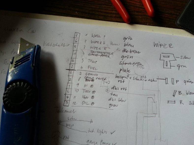

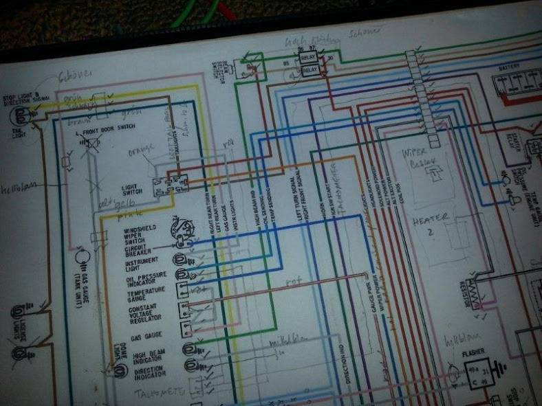

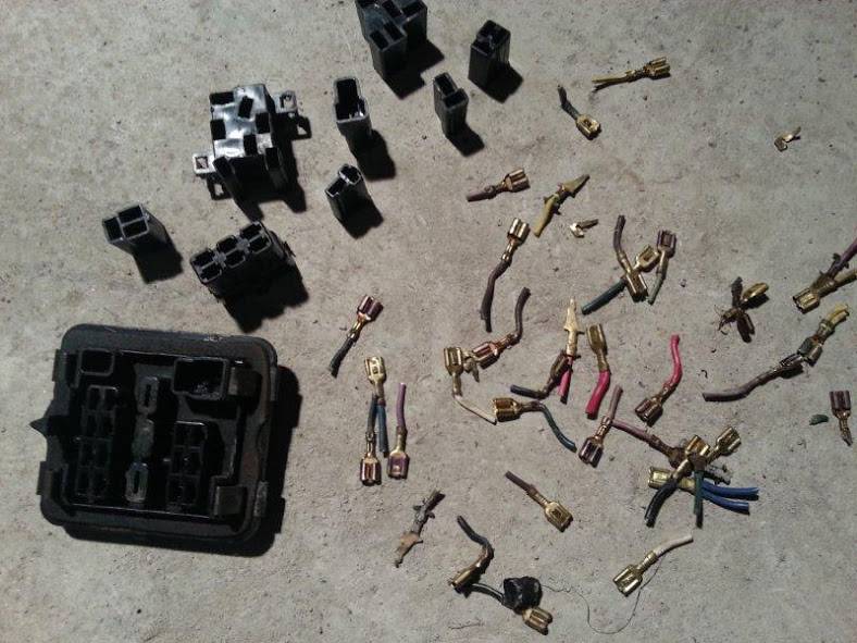

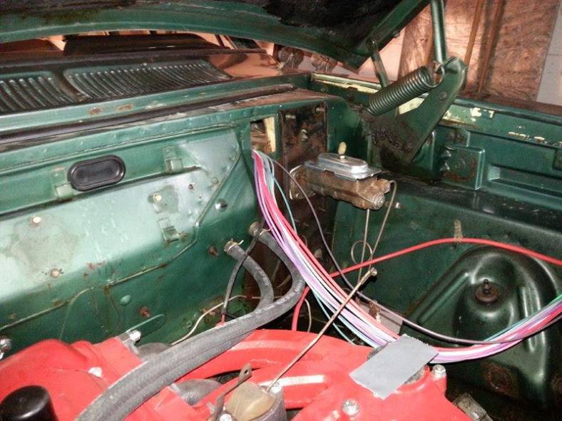

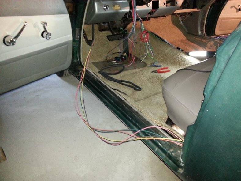

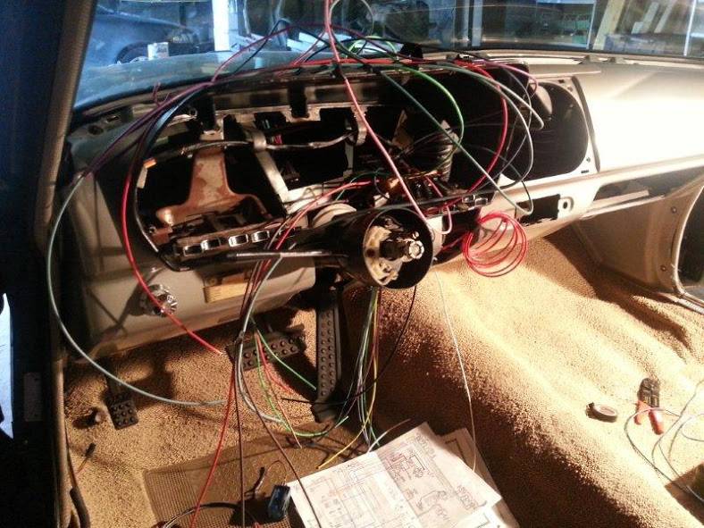

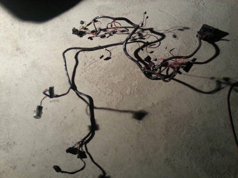

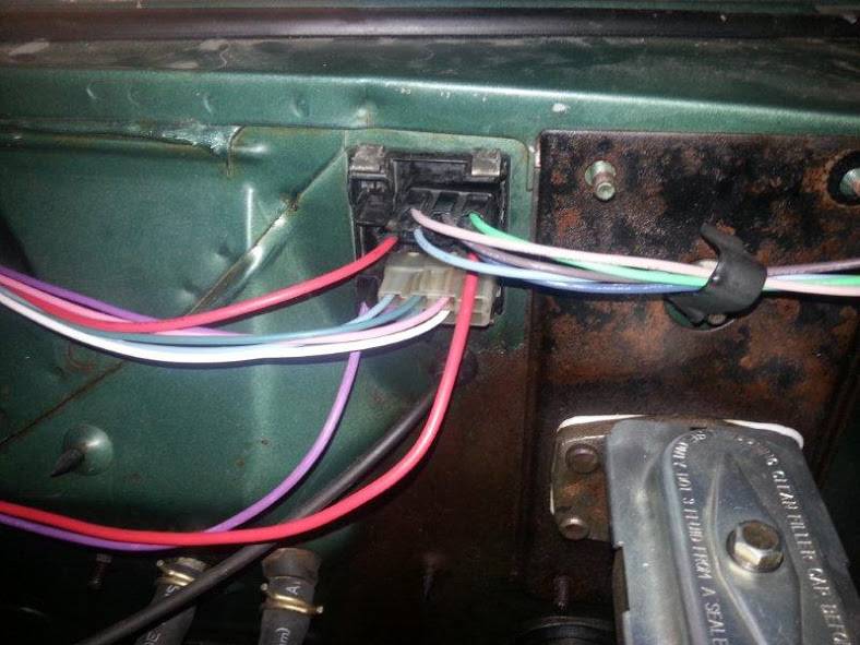

and getting rid of all the too old wiring. Everything went out

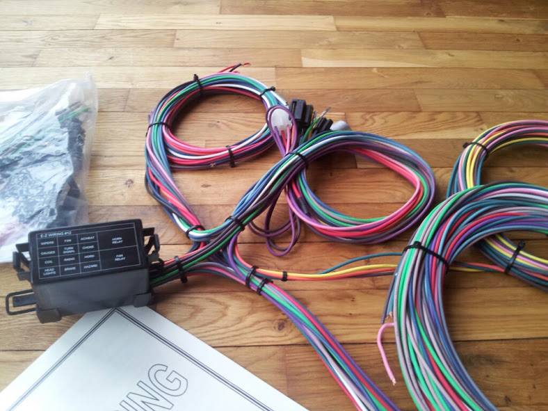

$160 for a new hot rod wiring harness from EZ. Only one cable had a wrong lettering. Just a little smoke...
cleaning the old connectors for re-use
and here we go
I didn't use the bulkhead connector as a connector. I drilled though it
my own wiring harness diagram. Everyday I had to change a lot. Manual from EZ wasn't a big help

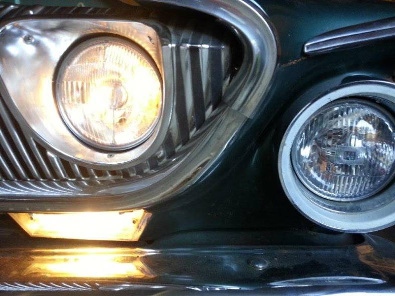

Relays for headlights
and at some day it was suddenly nearly done...
Video of the engine's first start after rebuild

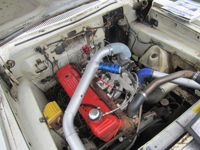

Here is something else to think about!
BOOST!!!!!!!!!

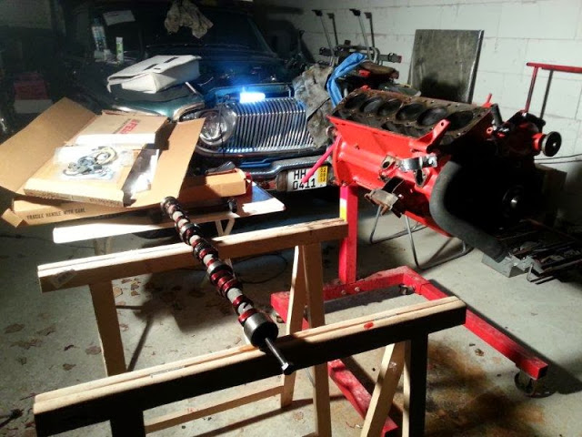

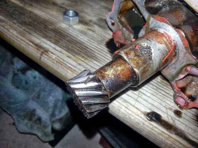

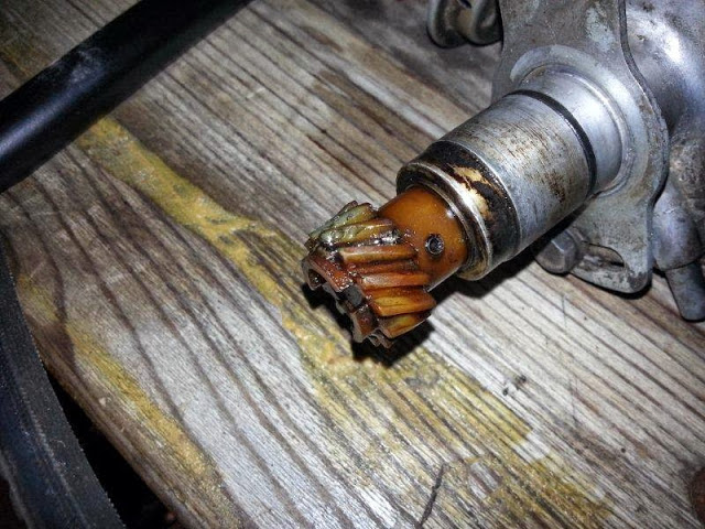

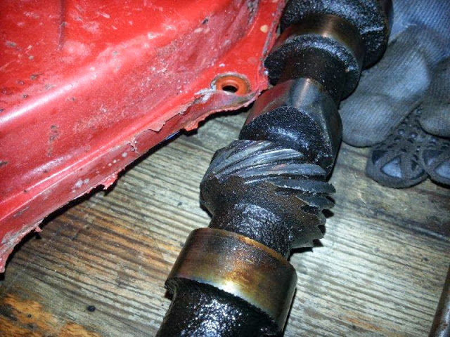

The next ride to a nice meeting wasn't that good. The car went quite well, until it suddenly shut down and didn't start again.
After we pulled the distributor, we knew what went wrong. At the qick rebuild of the 225, we changed the oilpump with another, that seemed to be in better condition. But the gears killed each other very fast.
So building the engine again with new cam, oilpump and a gear for the distributor.
Done :VB toast:

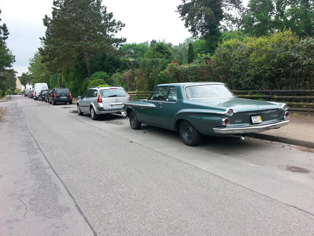

Now the engine runs fine and I could use the Dart as a daily driver for some days and a nice meeting here in Hamburg.
But I knew there was much more welding to do
stay tuned :icon_pidu:
