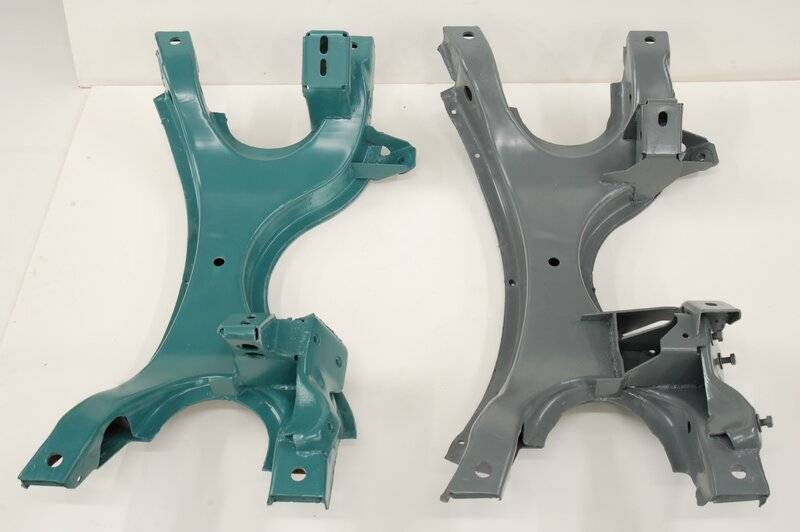

B body K frames shouldn't be all that hard to find. I have a '67 V8 K frame sitting on my shelf that I have no plans for using. Shipping is expensive on them so you might want to find one closer to home but they are available. In this picture the one on the left is an early B body frame while the one on the right should be the '67 K frame that I have. This picture is old and I haven't opened the box for a few years but I think this is the correct one.
Looking at the two, the engine mounts on the teal k-frame appear to be further forward. This is a great side-by-side photo that helps clarify a lot. Thanks again!
Yes, the teal K frame is from a 1965 B body car with a V8 engine. That is a cherry K frame, one of the nicest I've ever seen. Must have come out of a grandma car that never left the garage. I don't really need it but I keep it around since I know that once I sell it I'll never see another one that nice.
