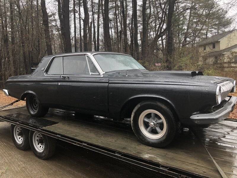

So I bought this 440 trim 63 Polara that has a 318 poly/auto which looks to be well taken care of. It has 104,000 miles. The guy I bought it from has a racing history and had several pictures in his garage of his past race cars, mostly GM. He had bought the car a few years ago intending to pull the poly for an LS-1 but decided he “didn’t want to make the mopar guys mad” so he sold it to me. The engine is 90% ready to pull and I plan on reassembling it and driving it while my father and I build a 440/4speed to transplant in the future. Im not able to find much info on making the switch, so I plan on documenting it here. Maybe it will help someone in the future.

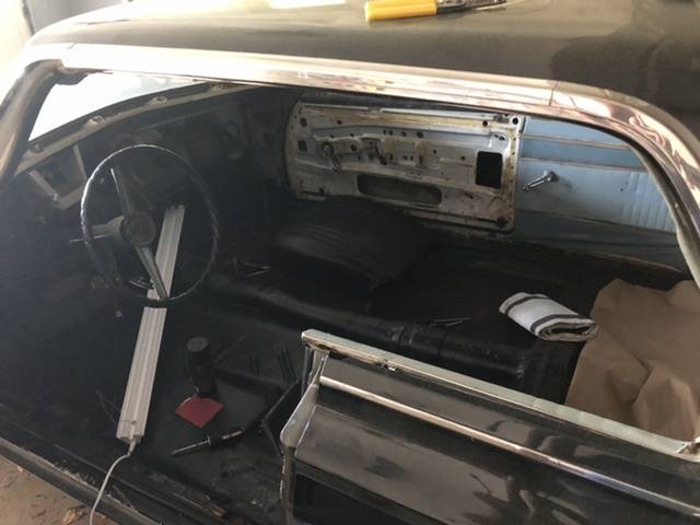

First order of business was to pull the interior. The front 60/40 bench is a little rough and its that sky blue color inside. I may change it ‍

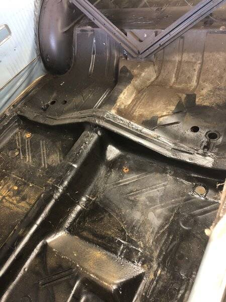

The floors were replaced by the po (he’s a welder) and he did a fantastic job.

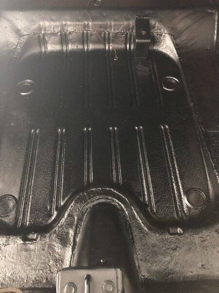

The trunk also looks new. I wire-wheeled the surface rust, primered, and coated it with truck bedliner. My daughter got in there and helped spraying satin black on everything else.

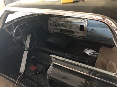

Dash is out. Looks like there was a water leak in the drivers windshield corner. Mostly surface rust with a tiny bit of rot that is hidden by the dash. More sanding and priming before I “fat mat“ everything. Got a replacement wiper motor and linkage coming.

Take a better look at that windshield water leak. These cars are famous for upper or lower cowl panel rot due to poor water drainage. Nice score on the car, though.
