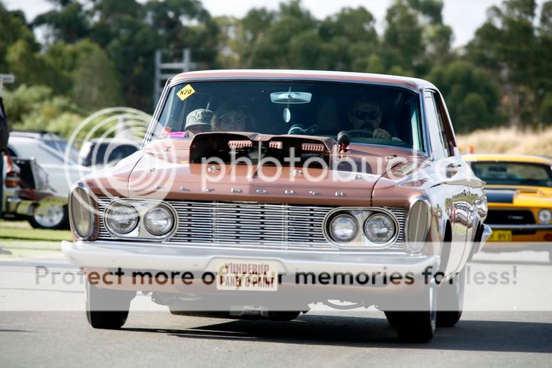

The only scoop to put on that car is a 63/64 Max Wedge scoop as per Super-Be Ski's pic's, Not such a thing as a hemi 63
A Max Wedge scoop does nothing for clearance issues unless you have that intake, I needed to cut my hood to close it due to my carb set up. To say the only scoop that belongs on that car is a Max Wedge is pure BS! IMHO Max Wedge scoops are ugly! I ordered this one and had it within a week, bolt on.
Being a little closed minded, aren't we? Not all of us want to make our rides "factory correct". Besides, in all my many years I have personally seen only two real max wedges and tons of clones. To each his/her own. BTW, Blackheart is right; max wedge scoop does not help a single 4 barrel intake...

I think what Ozy means is the Max Wedge scoop is the correct scoop for the 63 if you want it the way the factory did it. I agree with everyone as who ever owns the car can put what ever scoop they want on it as its their car and they only have to satisfy themselfs. Myself I love the looks of the 63 Max Wedge scoop and I am glad as I wanted my 63 to have the factory correct look but thats because I love that look. But I have seen 63's with the 64 & 65 Hemi scoops which dont look bad on them either. The fact is either one the 63 , 64 or 65 scoop wont give you much more room if you use the original size. I do see alot of NSS racers using the taller 63 to 65 scoops for more room to use a modern intake that is higher and they need the taller scoops to clear the carbs. But to each his own. I did not want to use a taller scoop since I like the original factory look. But you can see in this pic of my 63 the Max Wedge scoop adds about zero more room. The 64 or 65 Hemi scoop will give maybe 2 inches more room with the factory size. I am running the Indy dual plane with a single carb and I am glad its a nice intake for a street/strip car as most single planes wont fit under my hood. So I can understand why some use taller scoops when they are trying to get the most performance they can out of it. To Mr Bagley I say use what ever scoop you like as it is your car and you have to be happy with it. Good luck with it. Ron

So there is more clearance for carb/air cleaner with those HEMI scoops over a MW scoop ? I don't see it.
Just my view your car looks fkn great, you even have the MAXI plates :icon_keel: but I think it would look even better with the correct year/engine scoop.
Real MW.
Yes I had to put a 2" riser under my scoop because of Indy stuff.

383man Ron: I love your car. I run the 13" max wedge air cleaners with a 1" spacer under the carbs. The 63 max wedge scoop wouldn't allow me to do that. With the 64 Hemi scoop I have plenty of height to run my combination.
ozymaxwedge
: As you can see, the center indentation on the 63 scoop doesn't gain you much height, and as Ron said, he isn't able to run a single plane intake because of that. Your solution works for you, and my solution works for me. I like them all...
