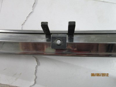

I'm looking for information on rear window trim clips for a 1963 Plymouth. The back window was out when I bought this car. I have some (6 or 7) of the clips, but not all. I'm not sure if there should be a clip for every screw hole in the stainless trim? Any help will be greatly appreciated.

there is no clips for the rear window trim it uses screws to hold all the trim on the ones you show are spacers for top trim only. bob
That explains it... Thanks!!
