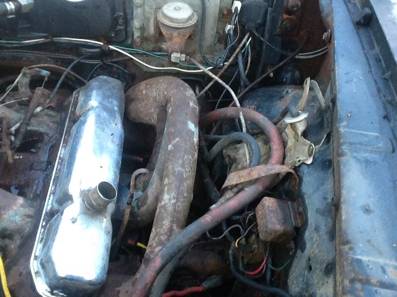

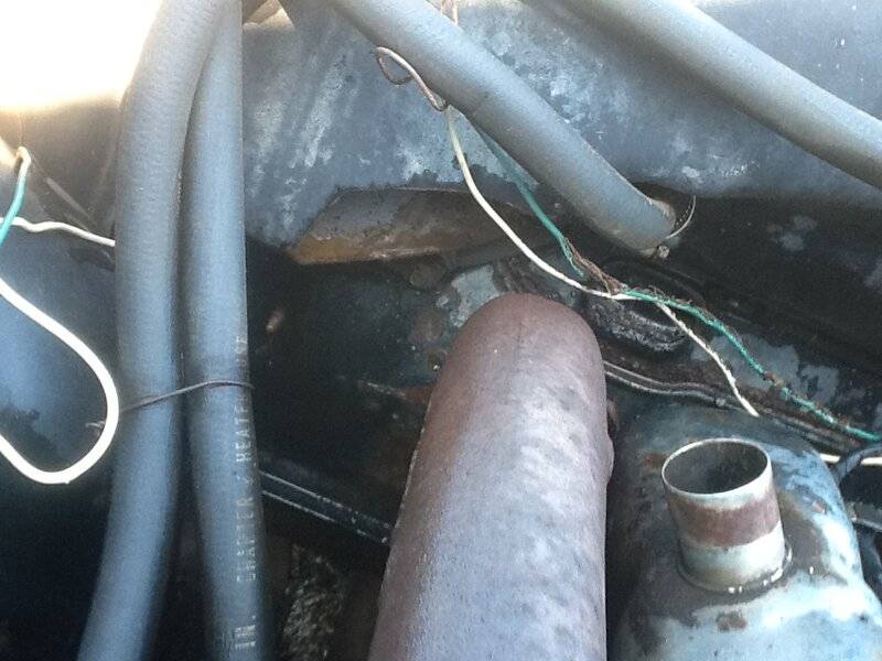

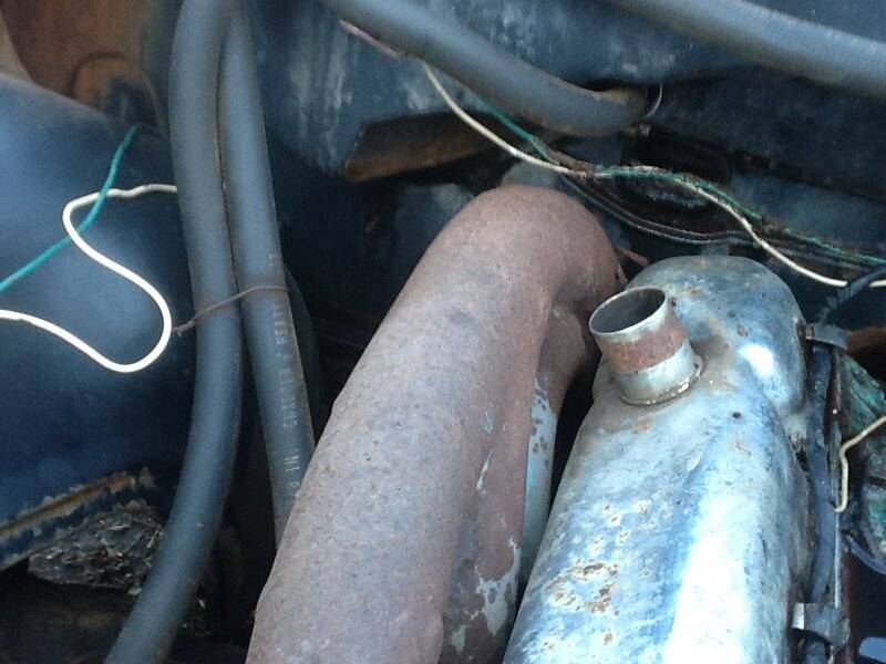

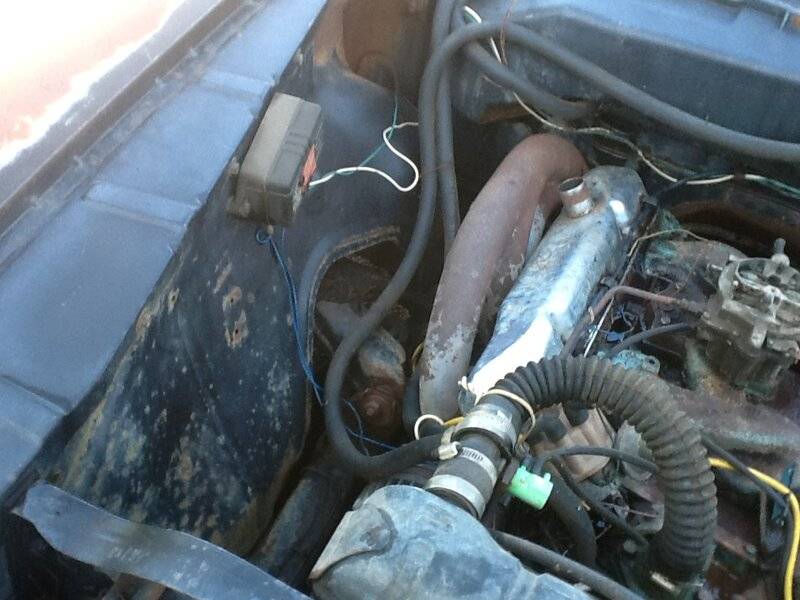

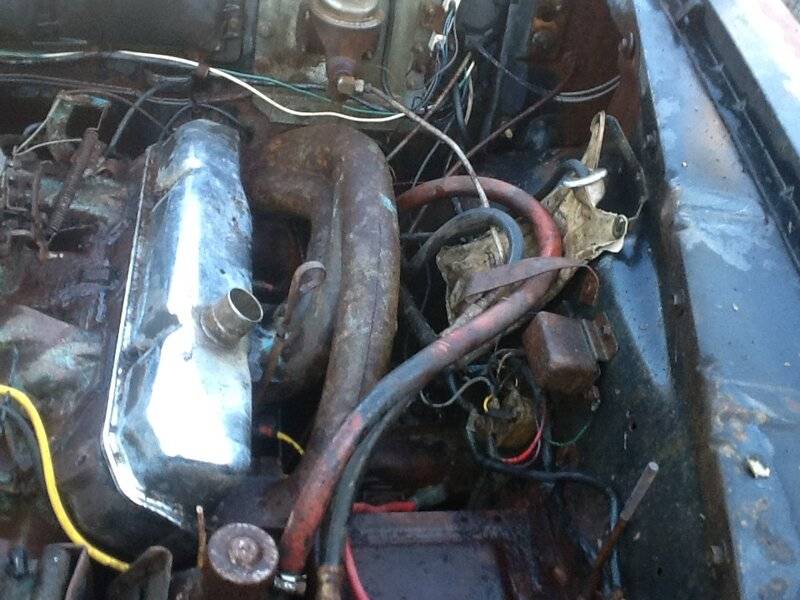

I have these on a 61 FURY. They were on the car when I got it. The brake line had been relocated,the heater box corner had been modified to fit.

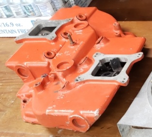

Shame to use such kool Manis on a low deck block. Sell them to me for my 1963 426 M/W Sport Fury vert. I'm cloning .
I was going to use them on the 62 300 you see in pic with 413 2x4 inline. Did not want to modify brake lines or heater A/C box. The max wedge manifolds have the original pipes and mufflers.
They are not for sale,but I would consider trading them for 61 long ram exhaust manifolds! They do repop these MW manifolds.
Y
Y
Ya, I have a set of repops.. just like the thought of originals to go with me crossram Mahalo C
