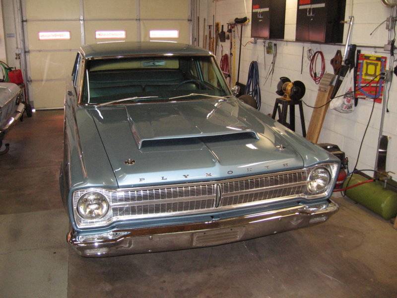

Does anyone know if the bumper for a 65 Belevdere fits a 64?
64-65 Fronts are different but will bolt up. It looks like the 63-64-65 Rears are the same.
Thanks, beautiful car!

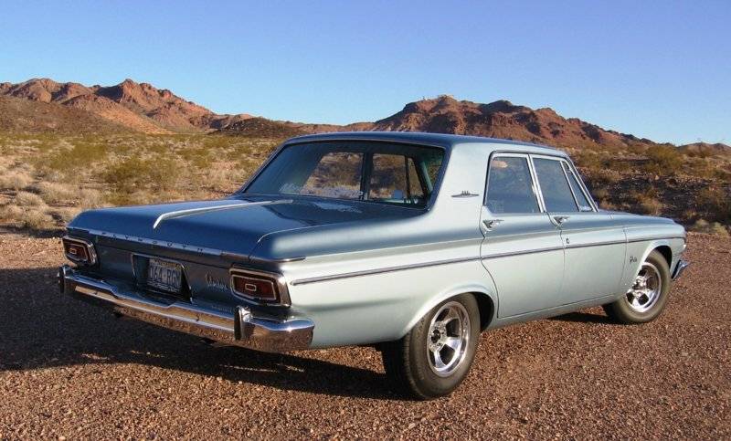

The outer rear bumper bolts are centered under the tail lights. Lights are different widths, so the holes are spaced differently. Otherwise they are the same, 63s and 65s are the same, 64s are just slightly different. Crazy.

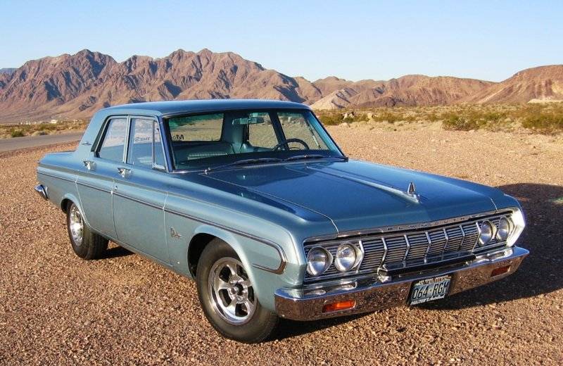

Hard to see in my photos but the front looks like the spacing is different for the bumper bolts.
