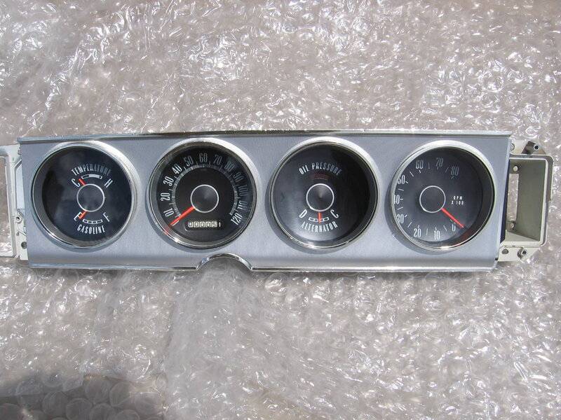

Wanted to share a photo of a 64 Plymouth Belvedere gauge cluster with a tach installed.
Redline Gauge Works did it for me.Looks factory.
