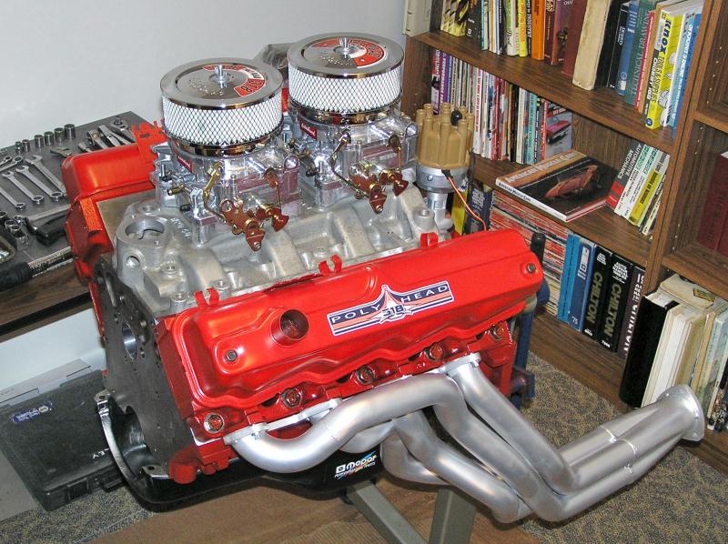

Why not keep the poly and tweak it a bit? I was going to swap for a 440 and I had two of them. However I started to look into the poly and found it to be pretty interesting. It garners much more attention at cruise night as it's actually 1.5" wider than a 440 at the valve covers. People look in there and wonder what is that big engine?
Parts are available and a new "wind tunnel" manifold is currently under production and scheduled to be ready in a few weeks. Aluminum heads may be coming next and cast, ribbed valve covers are also being produced now. Cams are readily available. The bottom end has a forged crank and the block components from an LA small block are usable with the A engine as are the distributors.
Unless you are wanting to be extremely "bad" and all out race the poly is a great choice. You'll be surprised at just how much crowd appeal it draws.

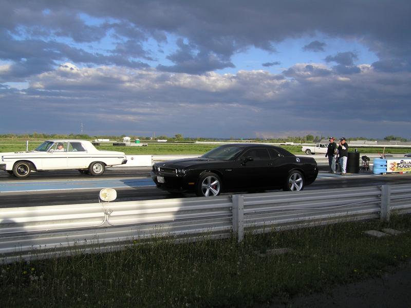

The "semi-hemi" valve design makes it the second most efficient head design also. I was running mine up to 7500rpm's and was real close to the Challenger SRT8 at the 1/8th mile. It was fun with a '64 Dodge Polara 4dr!

Hey, thanks a lot. That poly looks awesome! I've been going back and forth about swapping or not. I like the idea of keeping the car all #s matching original but I'm also drawn to having a "Mean Machine" that means business! I once had a car that looked and sounded the part, but wouldn't burst a grape in a food fight!
