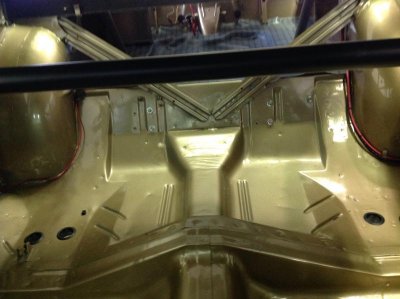

I'm reassembling my 64 Plymouth and purchased new seat belts for the rear. There is no provisions on the floor to bolt them in though.. Were rear seat belts not standard in 64 or was it an option? The holes are there for the front ones but not the rear on this car. The floor pan is original. image.jpg
It's weird that you don't have any provisions for them. My 63 Chrysler didn't come with them, but when I checked under the carpet, the provisions were there.
I believe they weren't standard till 67.
You are right as that was a option in 64. My 64 did not have factory belts but did have rubber plugs in the floor for the FRONT.They were threaded .The rear has dimples where you can drill for the thru bolts. My 65 came with front and rear factory belts.
That makes sense Darter. The dimples are there. I'll have to find out which dimples to drill out now. I mini tubbed the car as well so will have to determine the general location to attach the outer belt still.
Thanks!

Talk about seat belts being all over the board in 64! Very interesting to say the least. So back to my Plynouth, being minitubbed, the usual mounting location is no longer there now that the tub has been moved up against the frame rail. This leaves me having to bolt to the tub itself and I'm not sure that's gonna happen.
Being that there were no rear seat belts in 64 would a guy still be required to install them? I'm thinking about the event of having the boys in the back seat and getting pulled over.
If no rear seat belts, may want to reconsider having the boys unrestrained in the back seat, pulled over or not. It's just a safety thing with kids in the back.
If retrofitting the rear seat belts, you would want to reinforce the bolt holes like the factory did.
Even with minitubs, you most likely will have to modify the rear seat so moving the belt mounts over a bit shouldn't be that much of a problem and like, 65hemi said, reinforce the floor for them.
