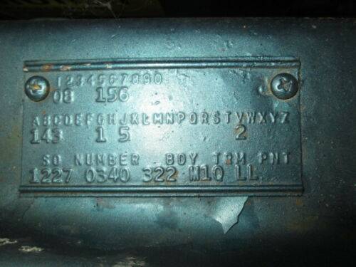

Can anyone help me decode this tag?
its a 1964 Belvedere Street Wedge car
I can help a little more.
1227 is a proposed delivery date of Dec 27
LL means Dark Turquoise Metallic top and bottom
I can't reference the trim of M10.
However, if it is M1Q then turquoise interior also.
Tag looks like it's a Lynch Road built car, correct? And I believe that the '14' under the 'AB' letters decodes the engine to: 426, 1 four barrel, 365 horse power, High Performance, 10:5:1 C/R
