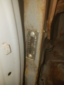

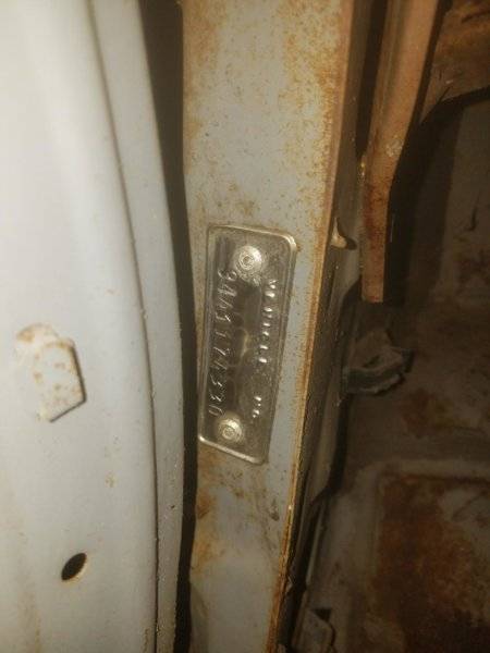

Guy's I can't find any info on how to decode my vin tag in the drivers side door jam. I am new to early B bodies and bought a super clean 64 sport fury 426 wedge 4 speed car last fall for next to nothing that is completely stripped down to a very clean rust free shell. I have all the parts to put it together and am trying to get a fender tag made for the car so it can be decoded . My question is, are there stampings anywhere on the body that match with the vin tag in the door jamb? I have a 68 dart GTS, and a 69 GTS and I know they stamped the 68 on the core support, and trunk lid drivers side drip rail. Just wondering if the early cars had stampings anywhere? Enclosed is a pic of the vin tag can anybody help me with this

there are so numbers stamped on the core support and package self that are on the fender tag also the vin tags where spot welded to the body not riveted on
I agree. The vin tag should not have rivets. With no fender tag and questionable vin mounting I'm not sure you'll ever be able to prove it was a factory 426/4 speed car. That could be one reason you were able to pick it up so "cheap".

So what did the vin # turn up? We can't read your numbers in the pic.

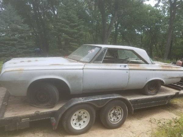

Ok, got it figured out, Chrysler historical does have the numbers. I sent them the copy of the title, and the DMV put an extra 7 on the end of the vin, so that was the problem. So now I have to go get the title fixed. Chrysler historical is doing a build sheet for me right now, and then Galen can do the fender tag. The vin tag was removed for media blasting and put back on with rivets, I have a picture of it before and after. The car is not a max wedge for sure, but I am told it was a 426 4 speed street wedge car. This car was in the same family it's whole life, and the owner passed away last year, we got it from his bother who was in charge of the estate. I did find the SO numbers on the core support and will get this all square away soon. Motor just came back from machine shop and is ready to rock. I will post pic's as we go. Thanks for the help guy's!!
This is a picture of the car right now, absolutley rot free car with enough trim to build 2 cars lol! The other picture is what the original color was, there is still paint up under the dash.
