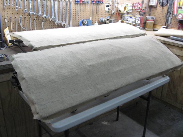

For my '64 I designed and sewed my own interior... Started with burlap over the springs to protect the foam.

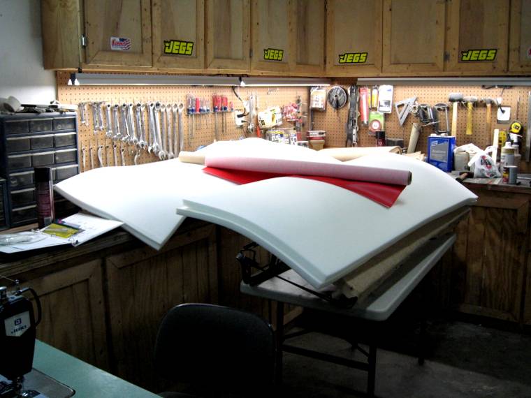

For the bottom seat I used two layers of 2" foam glued together with 3M 77 spray adhesive and cut to shape. Used my wife's electric kitchen knife for that..... don't tell her.

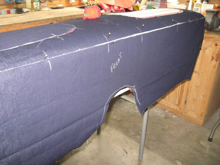

Then I made custom design patterns and sewed up the upholstery.
The material was a vinyl "faux leather" I purchased on line and was color matched to the dash color.
Once the basic cover was completed I used a liberal amount of "hog rings" to complete the installation over the foam.
The back of the seat is a bit different in that it uses one layer of 2" foam and a couple layers of cotton batting over the foam. You can find Legendary's videos on YouTube that show this process. Their video is on doing a '69 Charger so that's what you need to search for.

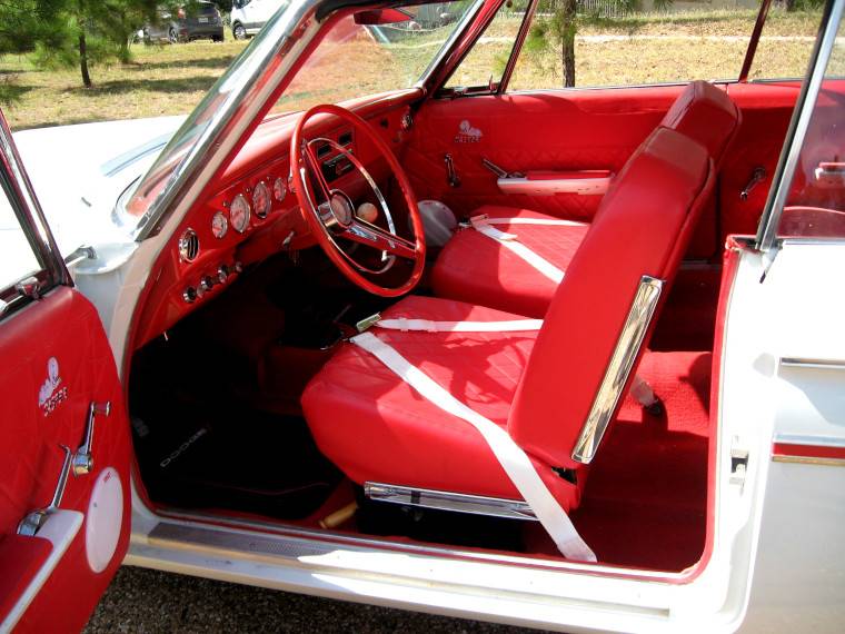

The buckets were done using an inexpensive foam kit from Classic Industries. The upholstery was done the same way as the rear bottom seat. Door panels were done matching the diamond design on the seats with custom embroidered "Casper" which is the name of the car. I did that on my wife's custom embroidery machine.
Never did upholstery before and never even used a sewing machine before this. I think it came out pretty nice, if I do say so myself. Cost was about half what Legendary wanted just for the upholstery kit alone and that included the cost of a used industrial sewing machine.
