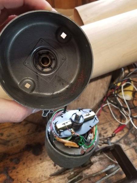

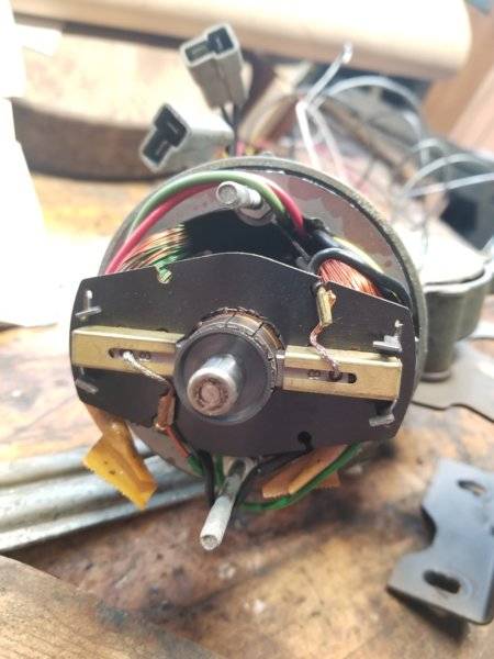

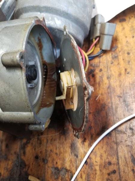

When I did this bench test on my motor it failed to run at at all (only did part 1 of test for now) and it was creating a spark at my battery postive terminal everytime I tried. But no burnt wires inside?
15763667048688740156632209658690.jpg 15763667222145005513024383557221.jpg 15763668425353157752725700859264.jpg

At this point I'm trying to figure out what is shorting out inside the motor? Trying to figure out what's wrong before I look into sending off for restoration.
It actually looks really clean inside so I'm hoping I can isolate the problem (internal short?) and perform a simple fix.

Evan thanks for the thread I guess I should check mine out while I have the dash board out. Looking at yours I see it has brushes in it. Has the spring pressure for the brushes lost its tension. Also did you check out the armature the brushes ride on sometimes they crack and shut down or I have seen others where the armature is lifting off the shaft causing a short. Just my 2 cents but following along.
With the motor cover off the armature has some play in it. I can pull it out of the motor about a 1/8 inch maybe less and can also wiggle it around. But the motor cover also has a guide for armature to keep it centered and in place (see pic) so I'm not sure if that's my problem. The brushes have some spring tension I'm not sure if it's enough though but they stay pushed up against the armature when I spin it.
Evan, I have seen when the brushes get to a 1/4 inch in size the tension doesn't hold when the motor is turning and also send the wobble in the shaft cause ground problem. If you can supply power and ground and watch it as turns you maybe able to locate problem. I have also seen the wiper arms cause problems because of not in time or not using the full stroke of the motor so it heats up and shuts down.

I just cleaned everything up and re tested. It still is shorting out on the first test. I did the second test and it started to run (didnt check which direction) but then it stopped suddenly becuase something was jamming up the wiper rods. Now that test wont make it run anymore.... I get a strong short when I do the first test and a weaker spark when I do the second test now....
It's sounds like your pivot arm is jamming up. Which in returns overheats the motor and shuts down. Not sure but is the axle or shaft have bushings on it. What could be happening is the shaft is touching the stator when you first start it and then frees up. But it will go bad because of the bushings are bad. Just a guess without seeing it. I could be all wrong
