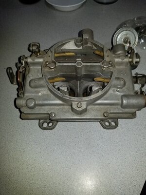

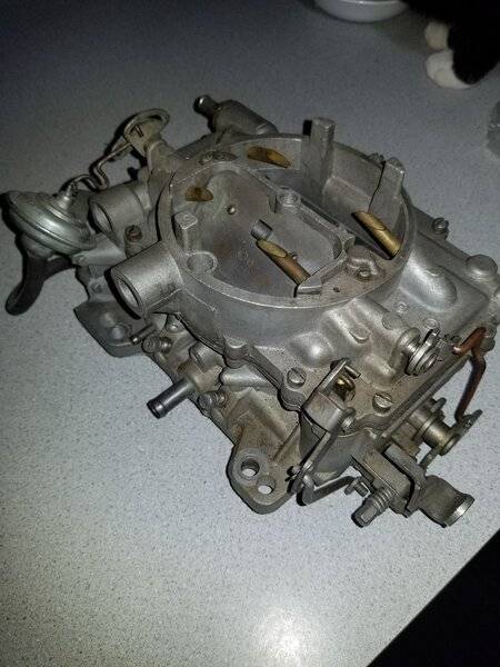

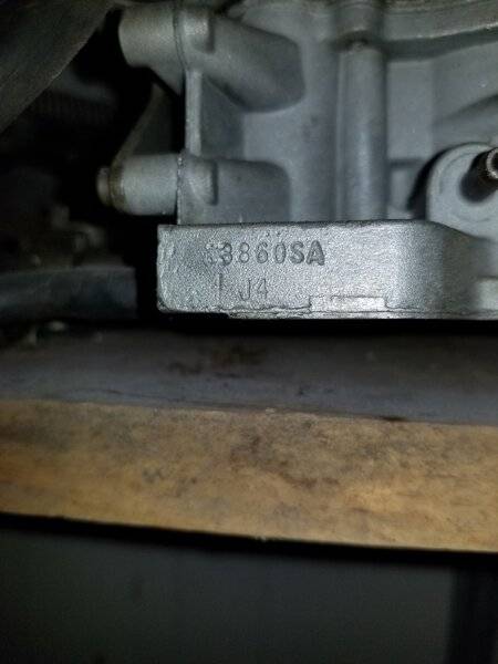

What would this come on and what would the date code mean ?
It's great working rebuilt and ran on my 426 Wedge for a while.
I know it came on a 426 wedge originally, but I'm wanting to know specific date range if possible.
Thanks in advance.
I am going to sell it with some other parts one I know 100% the specifications .
From what I looked up it shows 64-67 426W and some 383 for a 3860SA
My book shows the carb to be for a 1965 426 wedge auto trans. The 3860SA ... the A suffix is just a engineering revision to the basic design....perhaps a metering change or calibration change. I sgree with the date code determination.

Sorry I know this is old but the 383 and 426 SW carb are identical in size as all the specs are listed with NHRA.
