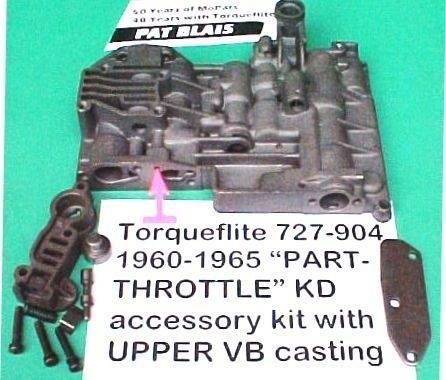

I was wondering if there are any other upgrades that I might consider? I Already have have converted the valve body to a part throttle kick down unit. Thanks for any help you might have.

What did you do to set up your tranny for part throttle downshifts? I have a 65 C body I wanted to do this to.
I bought a kit that Torque Flite Patty sells on ebay.
